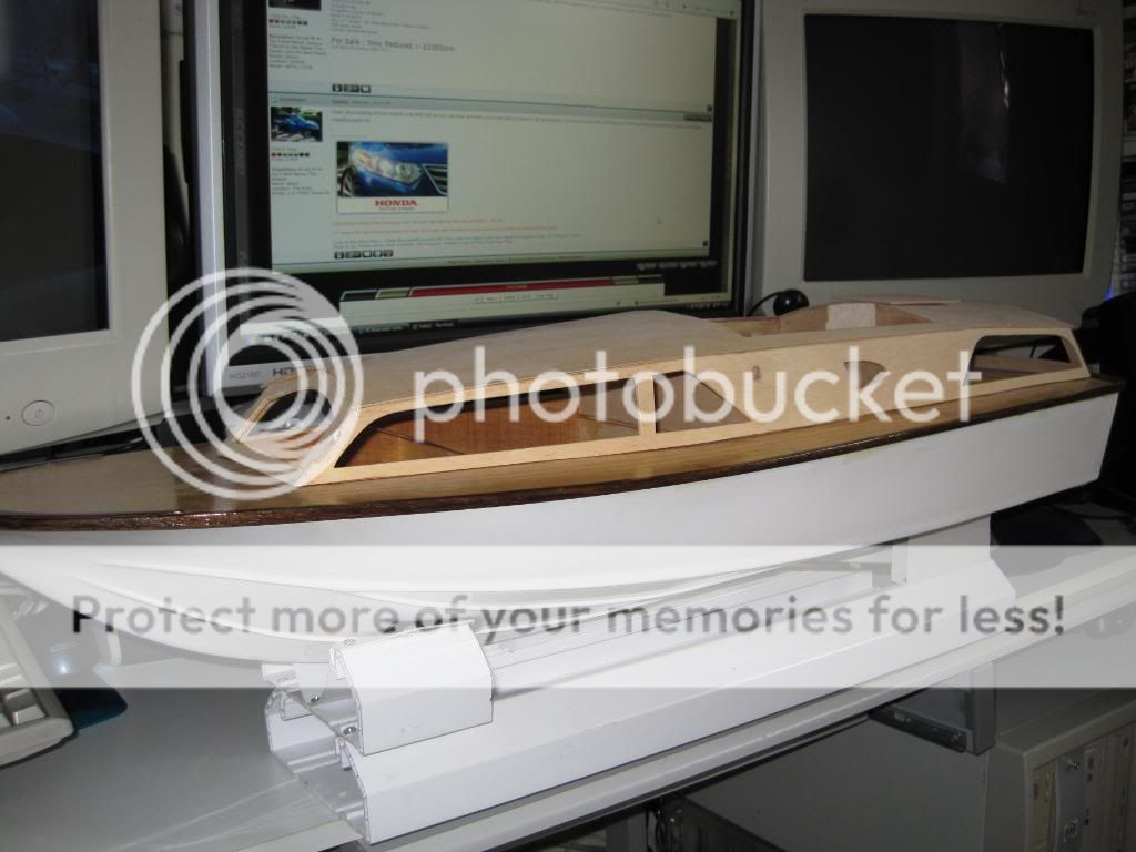

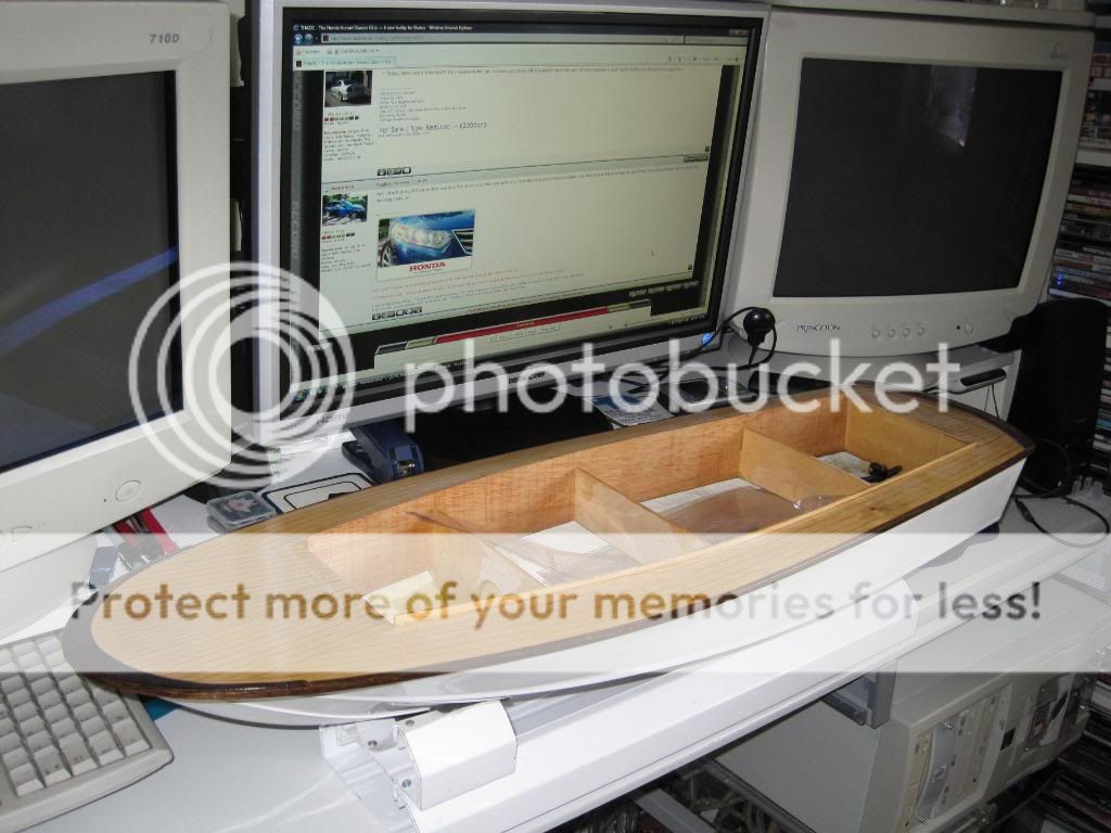

Name is Alan and I've just been given an unfinished project which was started by my brother-in-law, he said that he had lost interest and would I like the Huntsman 31 he had started a few years back. "Too right was my reply", and so I have joined the forum to ask a few questions and marvel at the boats which have already been finished so well by it's members.
OK, the model is a Precedent Huntsman 31, length 34 inch with fibreglass hull

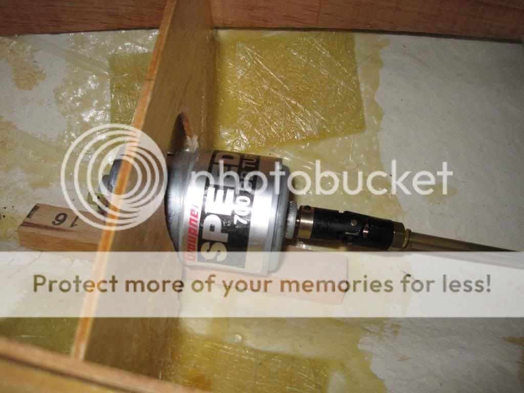

The motor I got with the deal is a Graupner 700 BB Turbo (8.4V) but I'm totally confused on how to fix a round motor and at the correct angle to the prop shaft ???
I wonder if someone could point me in the correct direction of how to fix this motor correctly ??

lots of model shops sell them but you can make them easy out of ally , try to keep away from plastic mounts as they flex and can be difficult to fit as you cannot just bend them to get the correct angle also they do not act as a heat sink.

The metal bracket is a good solution to motor fixing  - you can also make a baseplate in say 1/8 ply with two bearers of 10mm square balsa
spaced and shaped to "cradle" the motor.
Then a tie-wrap will hold the motor to the bearers and Bob is your avuncular relative
