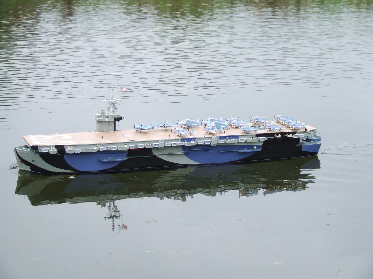

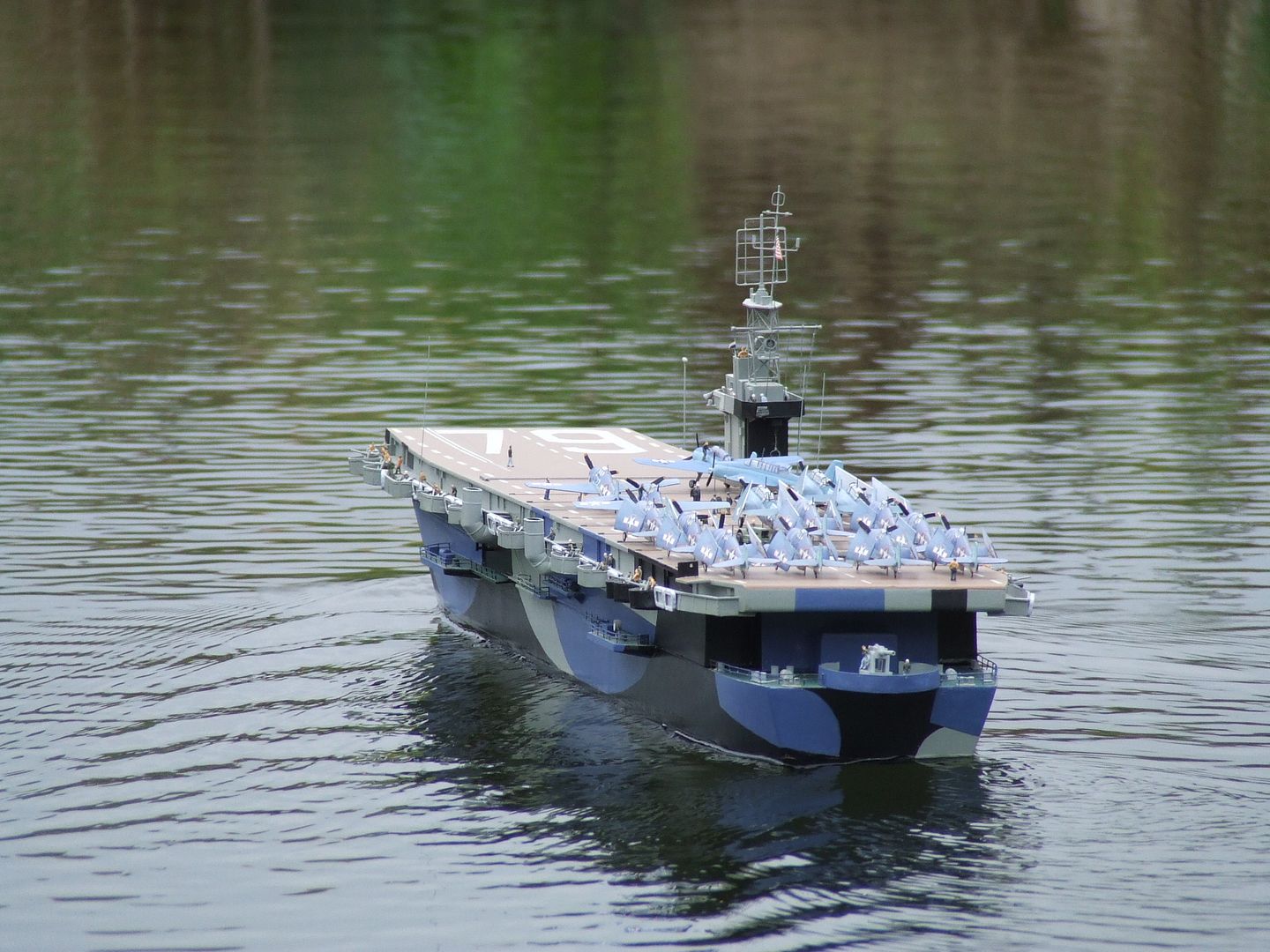

Dad built a version of this plan as the Gambier Bay when the original article was first published.  This was the result:

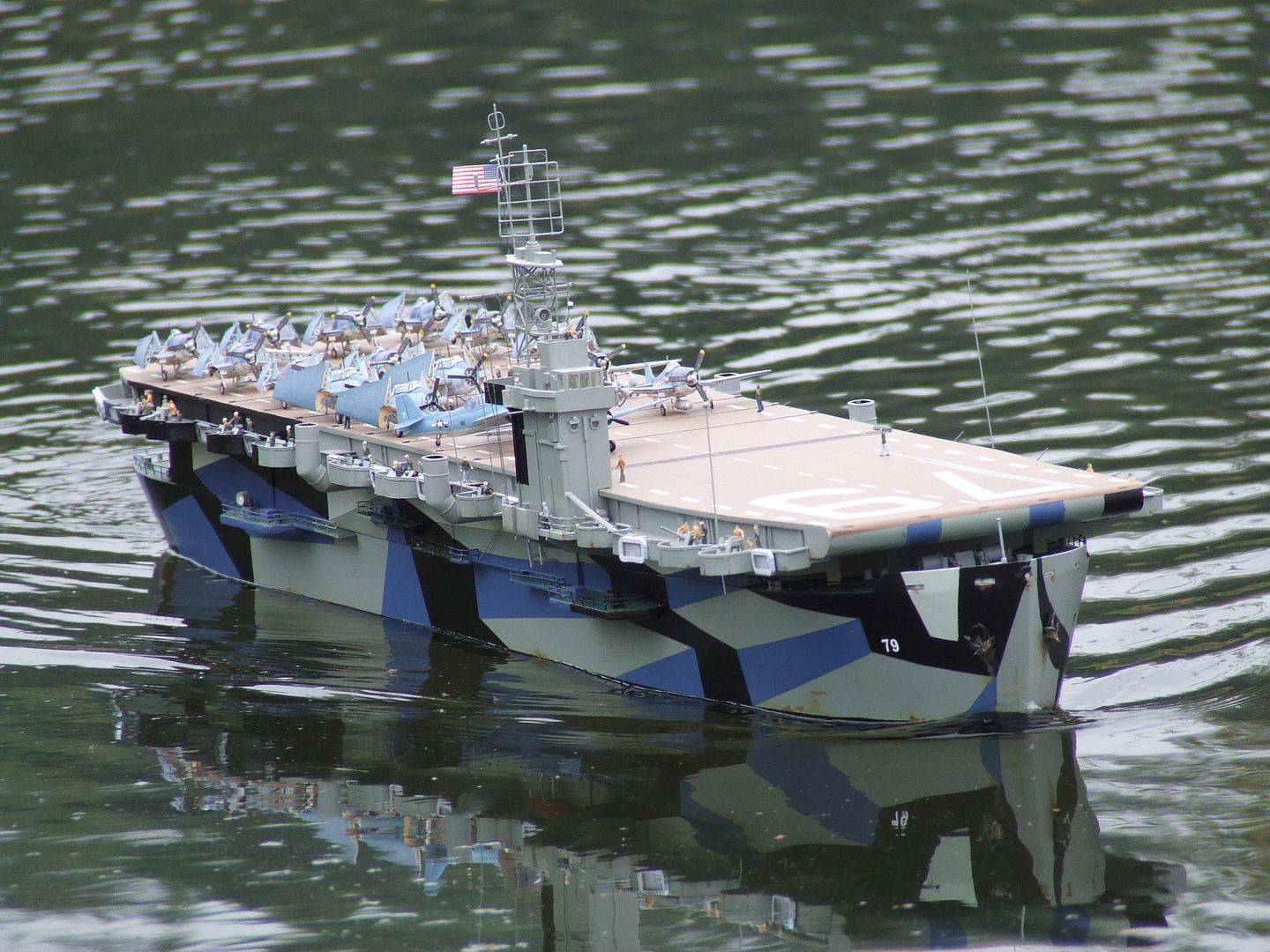

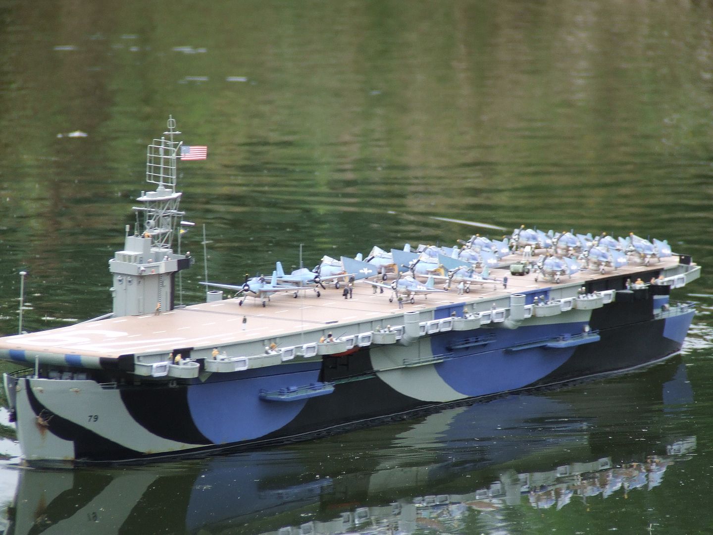

Pictures re posted on request from TailUk. Model in grey primer about 60% complete and painted almost finished.
Stan.
More photos:

Hi Guys I have posted a third picture of Gambier Bay looking at the flight deck enjoy.
Martin thanks for your help. See above pictures.
Stan.

Hi George My model is built at 1/96  or 1/8 to the foot most of the fittings came from John Haynes fine Scale Models. Model details  length 62.5 in long 15in across the flight deck and 18 in from the keel to highest part of the mast. Total time to paint 8 months lots of masking off. White Ensign in the UK did weapons at 1/144 sadly they have closed but Tomsmodelworks in the U S A are going take over the range. E/mail tomsmodelworks@aol.com

Lots of masking on the hull and on the flight deck by the looks of it Stan.
Lovely work, Is she a working model? (Asks he looking quickly back through old posts to see if it has been asked before!)

HI the model is fitted with 6 channel radio and is fully working. But due to the delicate parts fitted to it I decided to use this model as a static display model. If any one out there wishes to build a working model then I would suggest that lots of minor detail be left off. In the flight deck picture so can also see a Liberty ship and part of a Fletcher Class Destroyer all at 1/96 scale. Re masking you are right I thought I had shares in TAMIYA but well worth the cost. Finally I have been asked many times about the number on the F/deck this is not vinyl it was masked and sprayed on
Many thanks on all your comments it is nice to know that a model that was finished in 2009 can still generate a lot of interest.
