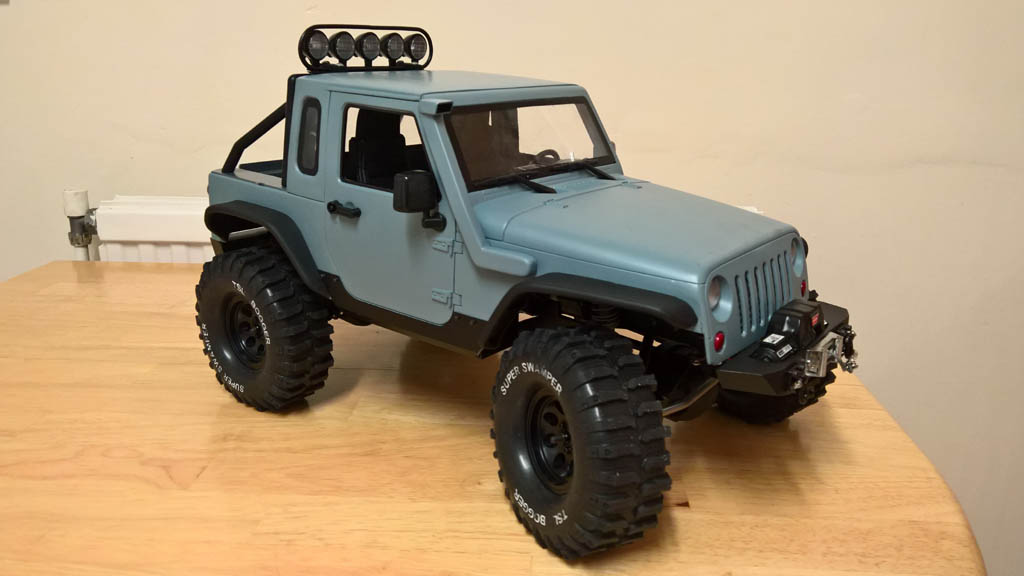

Car weight. Mine are 1:9 and 1:10 scale 4x4 crawlers. Some do indeed weigh up to 10Kg, even though in a competition lighter is without a doubt better, and a 10kg rig is rare. My Jeep weighs 4.5kg. Dual batteries and a brass roll cage. My scratch-built Ford Bronco Concept weighs almost exactly 3Kg which is good for the scale. A friend owns an 8Kg Mercedes G Wagon (why people do that is for another discussion). I tend to overspec by ~33% to accomodate the unexpected.

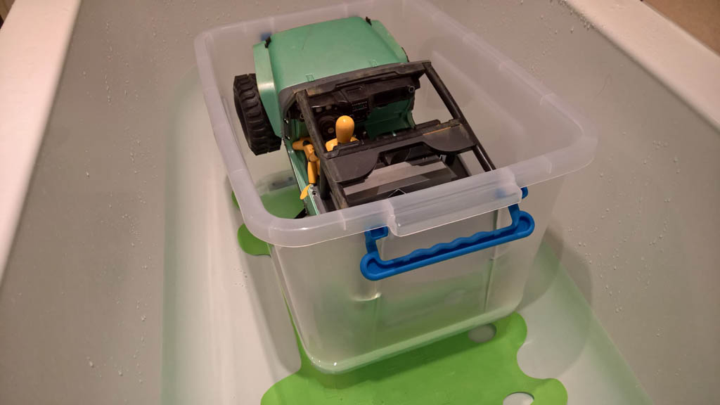

This should give you an idea of how deeply it sits in the water -
My plans (hand drawn, so assuming of the original, or copies of it) and Wikipedia both provide the same numbers, so I have to assume they're correct.
And yes, this pleases me greatly  %% I got 27 point something kg, so my 15 to 20kg was intentionally on the conservative side.

Been quiet since July because all my time has gone into producing a prototype, which I present for you to marvel and wonder at here, now.
Jokes aside, I've been up to my ears with other stuff, but really want this so making time for it now. The tub is simply a displacement test for ~5kg of cargo. I shouldn't have worried - 10Kg will be fine and still ride well above the ramp height. Next step is a prototype hull.
