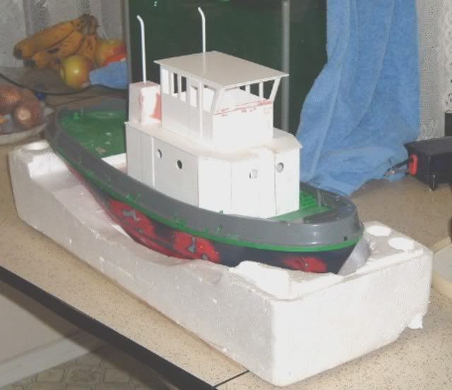

Finally took some pic's of the rebuild so far, as stated elsewhere I decided to base the build loosely on the Queensland Tug "Lorraine" in 1/26 th.
First I raised the coaming to restrick water ingress from under the superstructure.
With the nifty clamp extensions i made the cabin structure went together easily.
The walk way behind the cabin had to be extended after i received the sailors i'd ordered from Redbank Models, extension seen in this pic.
This was my first attempt using styrene it was a learning curve &  my junk box has lots of styrene bits in it, the next few pic's are of the cabin with bridge waiting on detail and dimensions from Brian  "chingdevil" the pic's he posted in my post requesting bridge detail pic's suit as i had decidedon a wooden ships wheel.
I liked the look of the stabilisers in 6705russell's thread so added similar to my tug.
I'll continue with the bridge using Brian's pics, i'll change it if the dimensions Brian provides prove i was wrong lol
