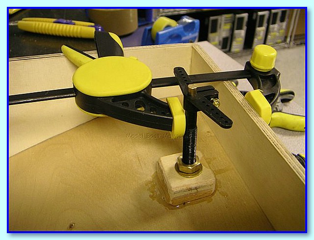

Re: flexing hull
« Reply #8 on: August 19, 2008, 03:37:58 pm »
When the servo pushes or pulls the rudder arm, the whole rudder post moves several mm toward or away from the servo like a big lever.  This very visibly flexes the 1mm ply bottom..
Do you have any bulkheads / bracing within the bottom of the hull?..
As others have suggested, put a block inside the bottom and put the rudder tube through that.. You may also need a block on the outside of the bottom too.
You have got the bottom of the rudder supported from the skeg?...
Something along these lines.. and "no", i dont get any flex at the rudder..
