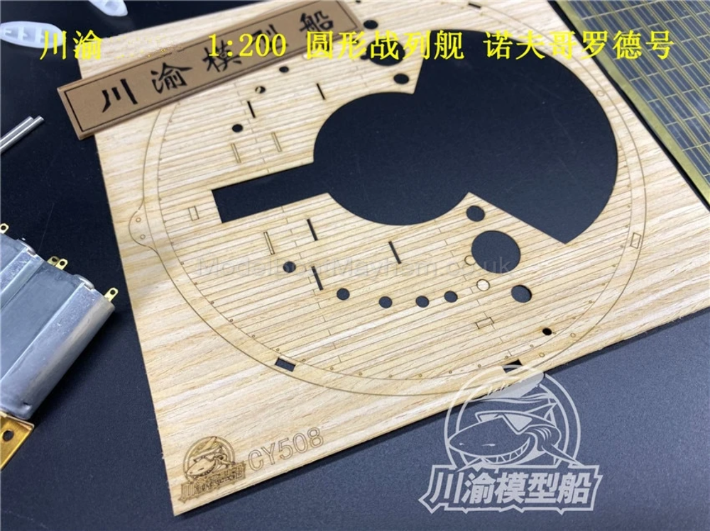

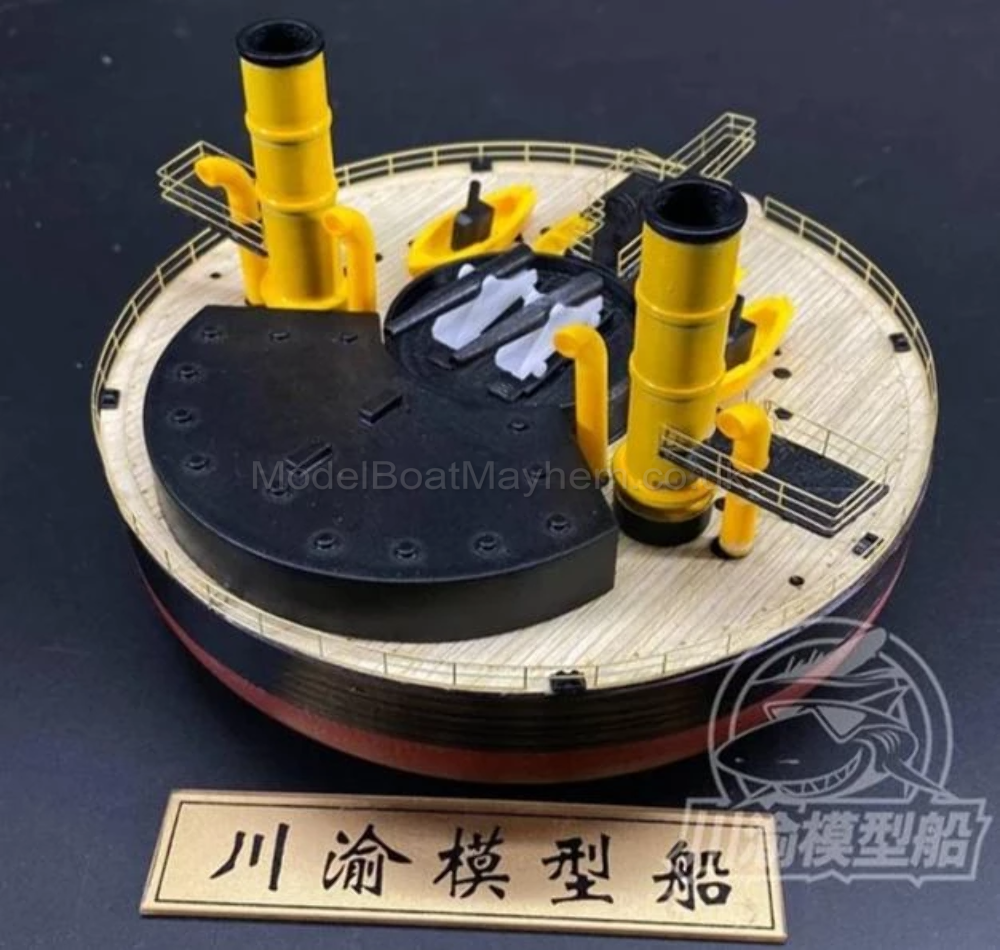

Wow
That’s quite impressive, nice detail and pocket sized too. I wonder if it works though... ok2

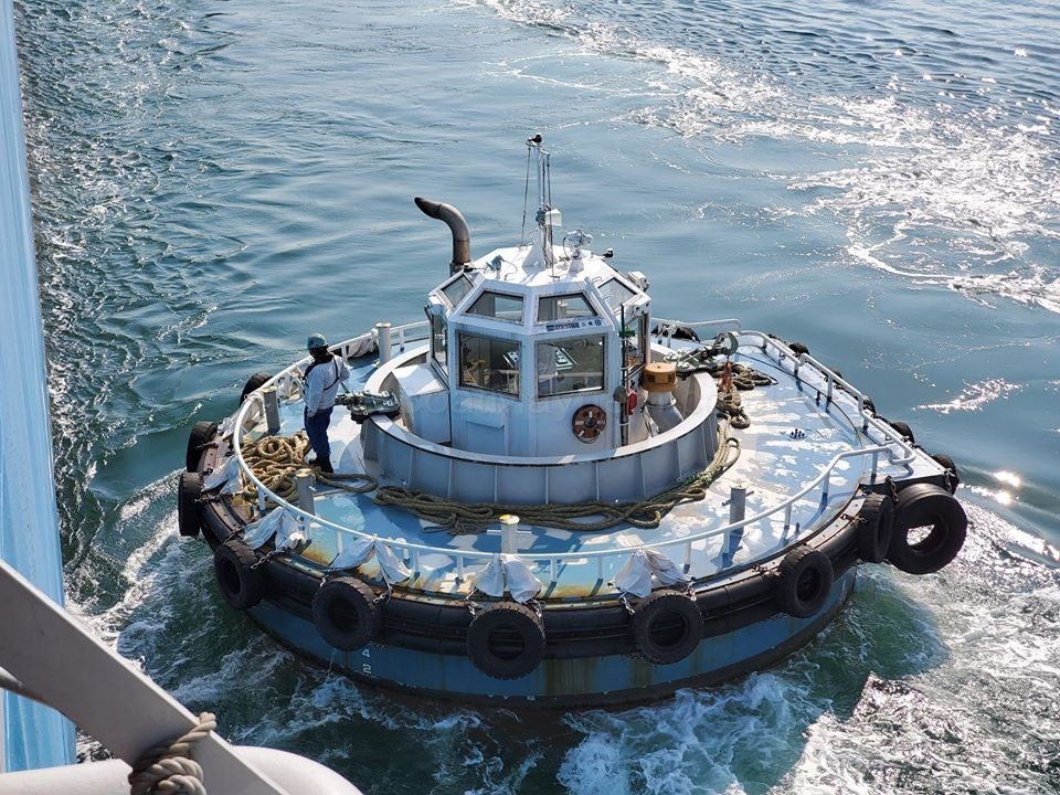

Now here an interesting / modern take on circular vessels!
It's Japanese and called the UME MARU:
http://www.shipspotting.com/gallery/photo.php?lid=2923989&fbclid=IwAR3-f5QX35Eq_KN_EFOHuWO-m9exyRb-rxIloh21YQ_Jc-Yu0TUFyepo4NU
This unique round shaped tugboat was created through a totally new concept of externally attaching a full slewing thruster to a towed ship. It can be easily operated by this single-lever-controlled slewing thruster. Adsorption equipment can eliminate the tug line, saving 2 workmen from handling ropes.
https://www.jasnaoe.or.jp/en/soy/2016.html
Modelling info:
https://www.simpleplanes.com/a/284361/Japanese-Tugboat-UMEMARU

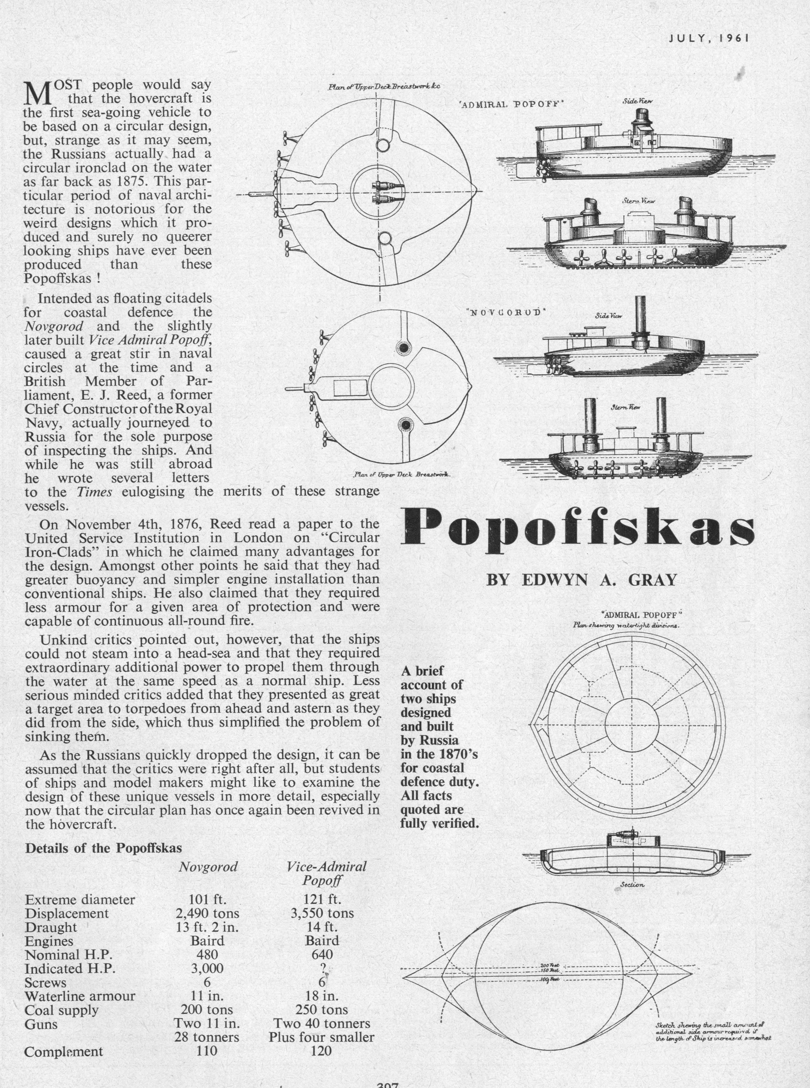

From Model Maker magazine, July 1961
Open image in new tab to enlarge
