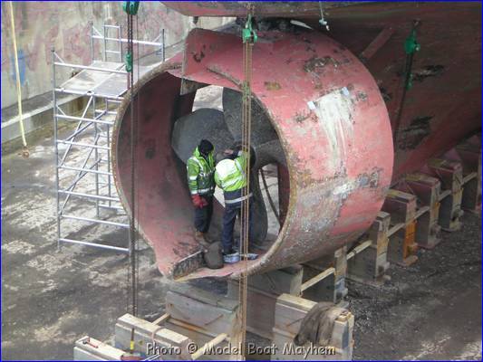

I think with steerable Korts, it is in the narrowest point of the Kort but uses and rounded tip prop.
 A couple of reference photos....

Clearance between prop and kort should be as little as possible to achieve the best effect and regarding the position of the prop relative to the length of the Kort, this is dictated by one thing only. The prop should allways be centered in line with the rudderstock of the kort to avoid the kort hitting the the prop when turning. This is probable not as important on models as the clerances proportionally is much bigger than in real life, but is is something to take into consideration.
The red line on the picture illustrates the centre of the rudderstock of the kort in relation to the prop.

Something like....
The prop should be on the CL (rudder post position) of the Kort..
You will find that to turn the Kort, there will need to be a gap between the edge of the blades of the prop and the inner face of the Kort ring.
If the Kort was a fixed type, the gap would be reduced considerably...
