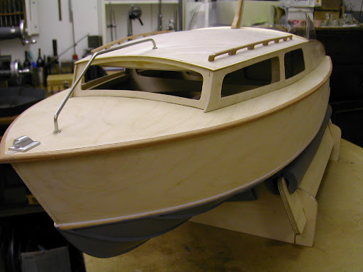

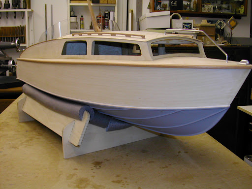

Well at last I can say it's finished :-) well apart from the paint that is.

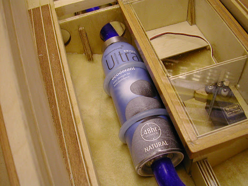

I have finished off the exhaust system and used an aerosol canister for the expansion chamber - should keep everything smelling nice if nothing else. I shall cable tie the silicone on final fitting out

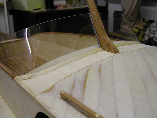

I finished the screen today. Despite the ply templates I still needed another card one from it and still had to fine trim the final plastic ones. It's epoxied on but held in position by the beading at the front and those four 8ba screws down the sides. They screw into tight holes in the sides and were cut off flush after.
The screen material as mentioned was PETG which, I believe, is the same material they make the large pop bottles with. This was 1mm thick and was just a tad to rigid - I felt I had to use a bit of heat on the portside after it was fixed and just overdid it despite being really careful. Today the stbd side went on with no problems but just after the glue set and I removed the masking there appeared some very fine stress marks running vertically on the bend.
You can just see them here
Not particularly noticeable at the moment but once the vibration starts it may be a different matter. Just can't face taking it all off again at this point in time just so much else I want to get on with. If I was to do it again I would definitely use bolts around the front beading and make the whole thing removeable.
Its going to be finished as one of the FORD sponsored boats - '707' - in the 1969 Round Gt Britain power boat race. White overall except the cabin sides, lower hull and transom which is dark blue. I'm busy this weekend but painting starts with a coat or three of sealer first thing Monday, in the meantime here's how she looks now
Hope you like it. I'm very pleased despite the slight problems with the screen. I confess I got a bit carried away with the fiddly bits especially as it's supposed to be a gad about but you know how it is I'm sure. Can't wait to get it on the water - if nothing else but to stop the ribbing I'm getting.  "Where is it then!" a constantly heard phrase 'down the water'.
Regards for now - Ramon

Hi All, Just took time out from domestic duties - visitors tonight and Swmbo's 'jus do' list is only halfway done!!! You know how it is  {:-{ Still I am getting a day out at Duxford tomorrow. :-)
Thank you all for your very kind comments about the boat they are appreciated.
As regards the silencer this is a leap of faith really. What it consists of is a central 1/2" OD thinwall tube right through. There is a plug about 2/3rds toward the back end and each side of this are a number of holes. My thought was that this would act as an expansion chamber - gas in through the front end holes - expand and and then out the rear ones. I used an aerosol as this is a good source of very thin walled 'tubing' the end cap being sealed on, as is the tube, with JB weld something that has shown to handle the heat very well indeed.
'Breathing' through it shows very little restriction, something I have used as an indicator on aircraft silencers I have made. Those were bolted straight onto the exhaust and would get inside the 82dB requirement but of course at a much lower rev band. I'm fairly confident it won't restrict the engine but what the noise levels will be remains to be seen. If it's too much then a re-think is obviously in order. I can only 'suck it and see'
Thanks again, back soon - Ramon

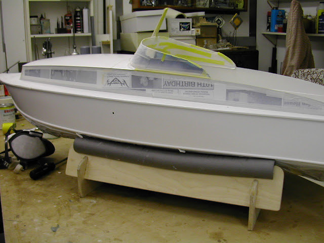

I'm struggling with the painting at the moment. It's been so humid the masking tape wouldn't stick - yes really! and to cap that off went down to get some aerosols yesterday only to find the local car shop closed - as in finished - stripped bare and looking very sorry. Sign of the times I suppose but another local supplier of handy bits and pieces gone to the wall.
On that note been looking around for pool noodles. Tried the local sports shop - six quid a piece! needless to say he's got quite a few on the shelf along with one he 'nearly' sold!!. Local toy shop was next, £2.99 - half the price for a twenty yard walk!
Regarding paint, anyone have any reccomendations particularly on the 'fuelproof' side.
I still have plenty of cellulose left from the aircraft days but wonder if there is anything that is quick and easy to get a result with - brush or spray

Well it's been quite a while since I could get any progress but at last today I have managed to get the topcoats on.  :} Trying to spray dependent on weather conditions can be frustrating to say the least.
I decided to go with using 'Brodak' fuelproof butyrate dope left over from 'aircraft days'. This is very good paint but really needs a butyrate 'substrate' to be at it's best. It will go over ordinary nitrate dopes providing they are left for some time to 'gas off' otherwise the butyrate reacts. (hence some of the time delay) I went for three thin coats of cellulose sanding sealer followed by an aerosol grey primer under the blue and white primer elsewhere. The white primer has much more 'body' than the grey and were I to do it again then I would use white all over followed by a thin coat of grey where the blue would go. However in hindsight I wished I had used thin epoxy straight on the wood - something I intend to do on the Hydro - but we all know how good hindsight is!
I will leave it a day or so to really harden then get the masking off. I feel it's on the home run now, just the 'logos', union flag and numbers to do then the clear coats.
Chris - sorry for not responding - just got carried away with the other project. Yes, please do - I'm assuming that's a 54" 28ft Huntsman.
Regards for now Ramon
