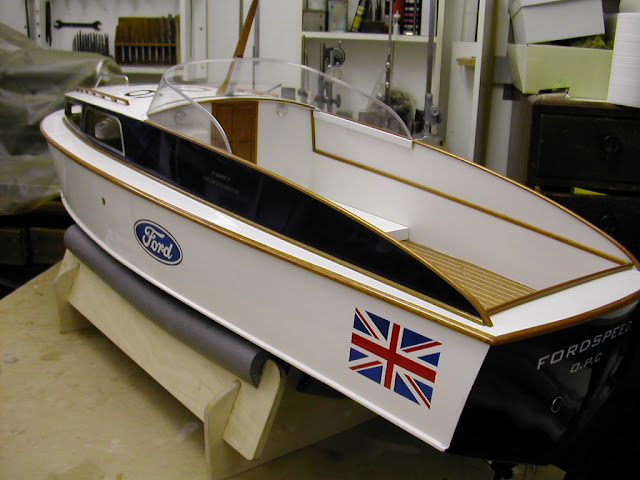

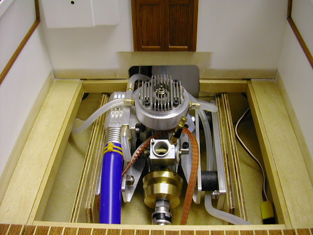

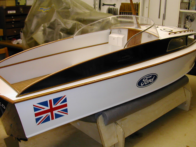

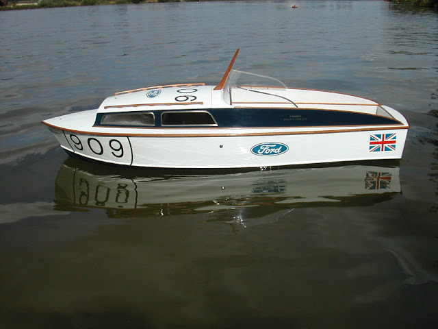

Hi All,
Well I'm pleased to say it didn't sink. :-)) Not quite :o
Couldn't get on it at all on Saturday so the frames got fitted on Sunday morning the last one about an hour before it got wet! And if it was going to get wet then the glazing and the front frame would have to wait. As it turned out that impatience was not a good idea and really could have proved disasterous ... but glad to say it didn't :D
Anyway heres how she looks - had to take some of these tonight as those done last night were a bit blurred.
At the club the obligatory picture 'on the water' - it's looking a bit light but rocking it from side to side it seemed (operative word here, seemed!) to be stable enough %)
After a tentative attempt to start the engine with a cord that was too thin I had to fit a belt and one whizz with a starter and the engine burst into life. It idles superbly and picks up very quickly and ... pleased to tell that silencer worked well :-)) (but it is early days yet so no 'crowing' from this direction)
Into the water and away - Oh DEAR - not enough rudder but what there was was sufficient to put the boat virtually on it's side with water scooping up and aiming straight for the open glazing.
I did manage a couple of straight runs, the pick up of the engine obvious, but on the second run the torque of the prop suddenly rolled her over on her side . Rapidly closing the throttle she now had little steerage and ended up ignominiously but unscathed in the branches of a waterside tree.
The top hamper with the engine running is alarming - ballast is definitely needed as well as a smaller prop - Graupner X50 used so X45 possibly X40 next.
So there we are - she's been wet at last, scared me to say the least but as the saying goes "We will be back"
I hope yours PMD is nowhere near as heartstopping - good luck with your testing
Regards for now - Ramon
andyn
Re: 1/8 scale Fairey Huntsman
« Reply #131 on: August 31, 2009, 10:44:23 pm »
I was sincerely hoping that wouldn't happen, it happened with my Huntsman, so much so that it couldn't turn right. This made it interesting when everyone else at the lake was doing right circuits and I was having to go the opposite direction...
Some ballasting should help it, I'd also go with the X40.
Ps it does look absolutely fantastic.
