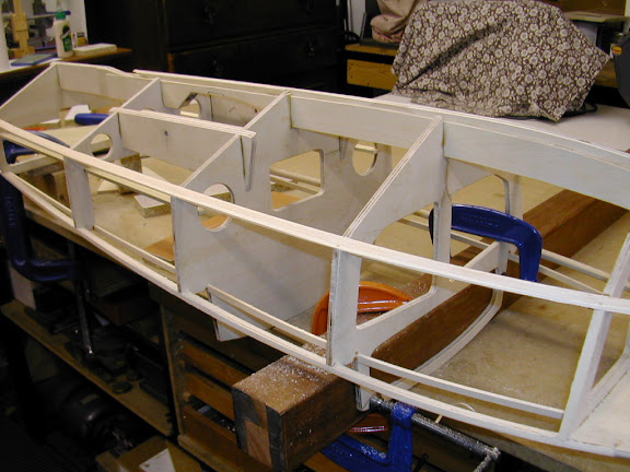

Got the engine mounted in it’s frame. This is the first time I‘ve installed an engine like this, last time it was a ‘paxolin’ plate bolted to two beech bearers P38’d into the hull! Wasn’t quite sure how to go about this at the outset – note the packing pieces! but the installation seems positive and in line. The prop tube is not finally installed as yet, that will be after the lower skins are on.
Rough planed the chine stringers down to the bulkheads on the bottom surface and planed and faired them in on the sides ready for the 1.5mm ply side skins which got fitted today. It’s beginning to look a bit like a boat now.
I intend to fit the bottom skins (also 1.5mm) as my early Swordsman and as shown to me at the time by my friend Arthur
This involves cutting the two panels as accurately as possible to  the ‘run’ of the keel and stem line and then drilling small holes along the (keel) edge and loosely ‘stitching’ together using copper wire. The holes get progressively closer at the turn of the keel to the stem. When the panels are opened up like a book they form a natural and symmetrical shape into which the hull frame work is ‘pushed’. Held in place the insides are then coated with resin – poly or epoxy which is allowed to flow filling any gaps. The result should be two stressed  skins uninfluenced by any bulkhead deviation.
Bear in mind this is a thirty year memory – I ‘remember’ it worked well on the Swordsman but it was along time ago. A couple of more days should see whether said memory is right!
Anyone any thoughts on this process? Any input would be valued.

Hi all - thanks for the input. According to the chart FLJ, the carb inlet meets the OPS 40 -60 listing though what engine the bottom end has been chewed to fit laud knows. Can't help thinking though that if it will be okay for the 40 that it would be a little restrictive on the 60.
Andy - Regarding the mounting I had been thinking of this  but thanks anyway for the timely reminder, very good advice. Follows good engineering practice - don't make anything you can't take apart!! I intend to mill a slot in the outer plates which will hold the nuts and removal of the well deck will give plenty of access to bolt heads. I'm in Suffolk BTW - not a mllion miles away! Place called Beccles

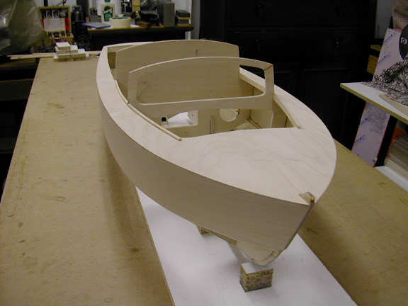

A little bit more progress has been made as below.
The sides are on and have been faired to the chines on the lower  hull
A couple of layers of stringer have been added to give a better glue surface at the bows and faired off
Card template of the bottom skins made and checked for fit
The transom as drawn had to have the chines moved upwards and the transom trimmed. I decided to build up the outer corners and fair these give an upward trim effect to counter the loss of 'vee'.
It's now back on it's jig and sides planed down to the chines. Decided to fit the decks and fit out the sides of the well deck from this point on which will allow waterproofing the underside of the decks before the bottom skins go on.
The transom having been faired off and some infil applied. This will be planed off to give the deck camber.
Back soon - Ramon

Hi again, I hope I can get this right tonight!
Again, thanks for your kind comments on the build. Whilst I haven’t made a boat for over thirty years the techniques used have been well honed on building model aircraft – it’s been fairly straightforward – just exchanged balsa for ply and the scalpel for the bandsaw! That’s not to be flippant, ‘building’ is one thing it’s the technical side where a steep learning curve should be readily apparent.
The photo’s? Well that’s definitely down to the camera – a 2 mega pixel ‘Nikon Coolpix 2000’ bought a few years back at what seemed an exorbitant price and now they virtually give that size away with the cornflakes! It does have an excellent macro facility though and is so easy to use.
As you can see there has been a bit more progress. I’m quite surprised at this myself but then it is all the ‘big bits’ getting stuck on at the moment. Things will slow down once the ‘fiddly bits’ begin.
This shows fitting a couple of supports for the deck at the bows. Incidentally does anyone know of a source of these small clamps? they came three in a pack for a pound and I'd dearly love to get some more.
Water proofing the bows and underneath the deck using two pack Tufcote fuel proofer. The benefit of using this as opposed to other resins is that it dries very quickly on the workpiece but remains very fluid in the mixing cup for several hours.
I’ve decided to leave the hull skins to the last minute so that it will still fit in it’s building jig for working on the top side.
Regarding the cabin PMD I’m hoping to make the whole roof removable from just in front of the windscreen. If memory serves me right I think that’s how the original Aerokits Swordsman was done. Looking at the drawings of the Huntsman though I’m certain the roof has much more camber than the Swordsman (kit) so this may make the forming of ply to the compound curves involved very awkward if not impossible though it may be possible to ‘flatten out the curve on the bulkheads a little to improve matters a little. I’m not that far off – next session will be to fit the well deck sides and then dry fit the cabin sides.
Thanks for the invitation Andy I’ll bear it in mind and as I’m definitely a fair weather person these days the ‘Summer’ it will have to be .
Once again a Happy New Year to you all, back soon - Ramon
