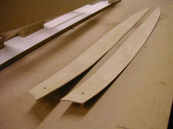

Thanks guys for your interest and input which as always is appreciated.
Despite seemingly unable to shed this cold (man flu according to SWMBO) I forced myself once more to the brink and ventured into the workshop to dry fit the cabin sides. These are cut from 2.5 mm ply which I got from SLEC. Unlike the 1.5 and 3mm from the same source this is of better quality being five ply and considerably stiffer. The ‘pull in’ force at the front of the cabin was significant though at this stage I had not removed the cutouts for the glazing (notice I didn’t call them windows!) – I didn’t want to risk the ply cracking. I then thought that if I could induce a curve in them this potential should disappear. I have often used a heated surface to induce a curve into stringers on model aircraft and wondered if this would work over an area on this ply.  Surprisingly it does!
SWMBO kindly donated her redundant flour shaker (well it is now!) to the cause and with the help of a tea light a polished heated surface did the trick. I can now cut out the openings without fear of cracking the thin edges around the glazing.

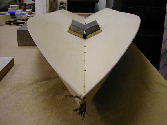

With this stage now dry fitted it’s time for fitting the bottom skins . Here they are stitched and ready to apply.
I had to take them apart and bevel the edges as with square edges one side kept slipping under the other but once done and re- wired here's the result just hope it goes on the frame work ok.

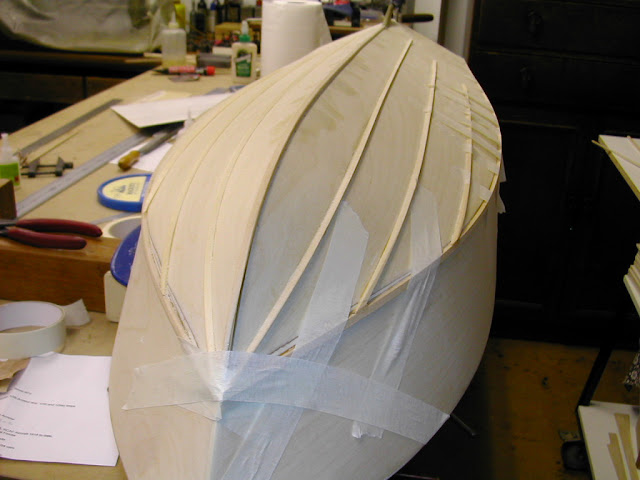

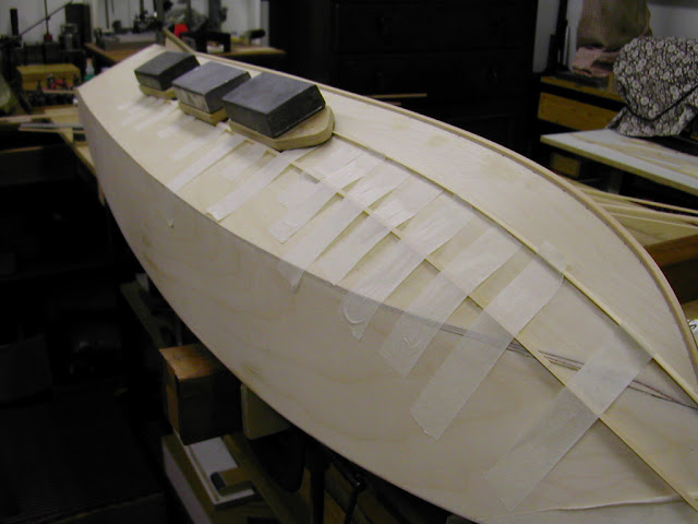

With the able assistance of SWMBO (now that could cost somthing!) I managed to get the bottom skins on last night which though taking near a whole roll of masking tape turned out to be a relatively pain free operation.For some reason the pics would not load on Picasa but tonight seems okay.

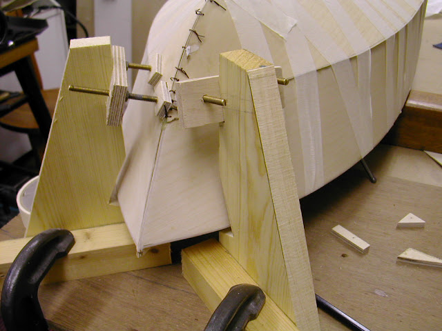

The pull in at the stem was much to tight for the tape to handle so the crude supports were made and I finally found a use for the piece of 2BA studding that has laid in a drawer for the best part of twenty years!
Clamped to a ply 'extension', itself clamped to the bench, they gave all the force neccessary to hold the parts in tight. I used standard Araldite to glue this area up on to where the keel staightens and at the aft end behind the prop shaft exit. I left the remainder of the keel dry and glued all around the chines and the bulkheads with Titebond pulling down with masking tape allowing the natural curve of the skins to find its own level on the bulkheads ie I didn't try to push these points deliberately into contact.
Today I turned it over to find that they are tighly glued to all except the front two bulkheads. These gaps will be carefully filled with epoxy to keep the natural 'flow' of the ply skin.
The hull was laid on each side and Araldite laid in the join between keel and skin then gently heated with a hot air gun. Doing this serves two purposes firstly making it thin and fluid so it runs into all the crevices and wire holes and secondly to kick activation off much quicker. This dosn't show it too well but it needs doing a bay/bays at a time so that the glue stays level until activation.

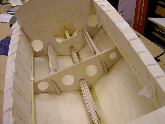

Hi chaps,
I finally have a hull and it's now begining to look like a boat. Nothing done today though - birthday and all that but have managed to fair the edges and give it a good sanding all over since Friday.
The next stage is to get the propshaft in then the more time consuming 'fitting out' can begin.
Unfortunately though something else that simply can't be put off any longer needs attention so it will be a week or so before work can resume but in the meantime heres how she looks now.

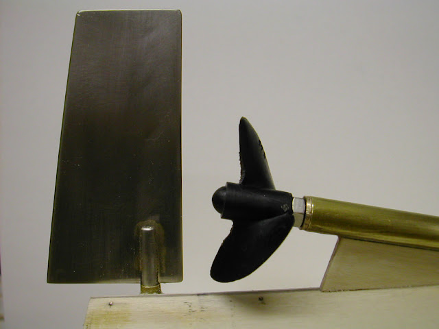

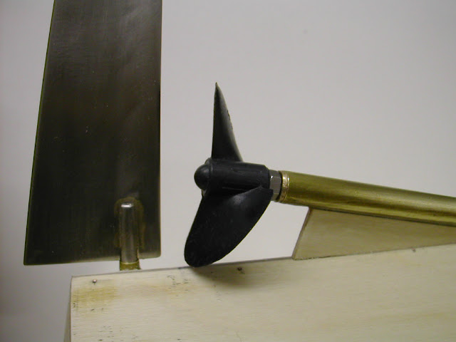

After more time than anticipated on the dreaded domestic duties and a much more pleasurable modelling distraction (perhaps more later on that!) I finally got back onto this yesterday.
The prop shaft is now in though a bit 'close angled' for my liking - I can just get an X50 prop to clear. Any one any ideas on what prop would suit this HP61 best? When I did his before I don't remember anything more exotic than the Graupner range of props. I can't be certain but memory recalls using nothing larger than an X45 on the Merco 61 and the OPS. Am I right or would this have been too small? I intend to kick off with an X50 and experiment from there

Thanks Andy, FLJ and Norman for the PM. Looks like an X50 it is. Howeverrrr!
I can get an X50 in with about 3mm to spare. I know it's a bit late to do anything about it now but would you cast a wary eye over these couple of pics and tell me if this closeness to the hull is likely to have a detrimental effect.
X50 - appx 2mm clear
X45 - appx 5mm clear
