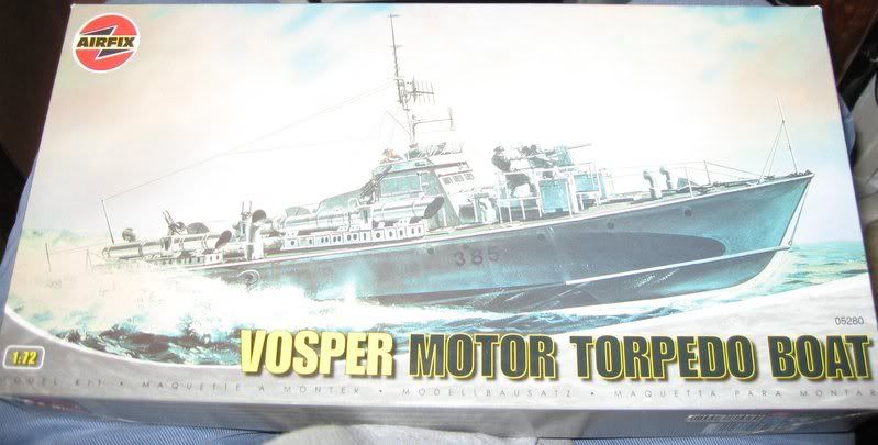

This is going to be my first model to build!
has anyone else done this one and have you got any tips for a beginner starting their first build?

Weight is a major issue with such a low displacement hull, batteries are a main concern as a little battery, therefore lighter weight, does not give a long time on the water depending on the current drain, connecting the motor to the prop also adds weight as such a high speed requires a solid coupling, the test rig system i am using is not perfect and changing the prop to a racing one, might give the boat the push enough to move it on to the PLANE (see the picture on the box).
