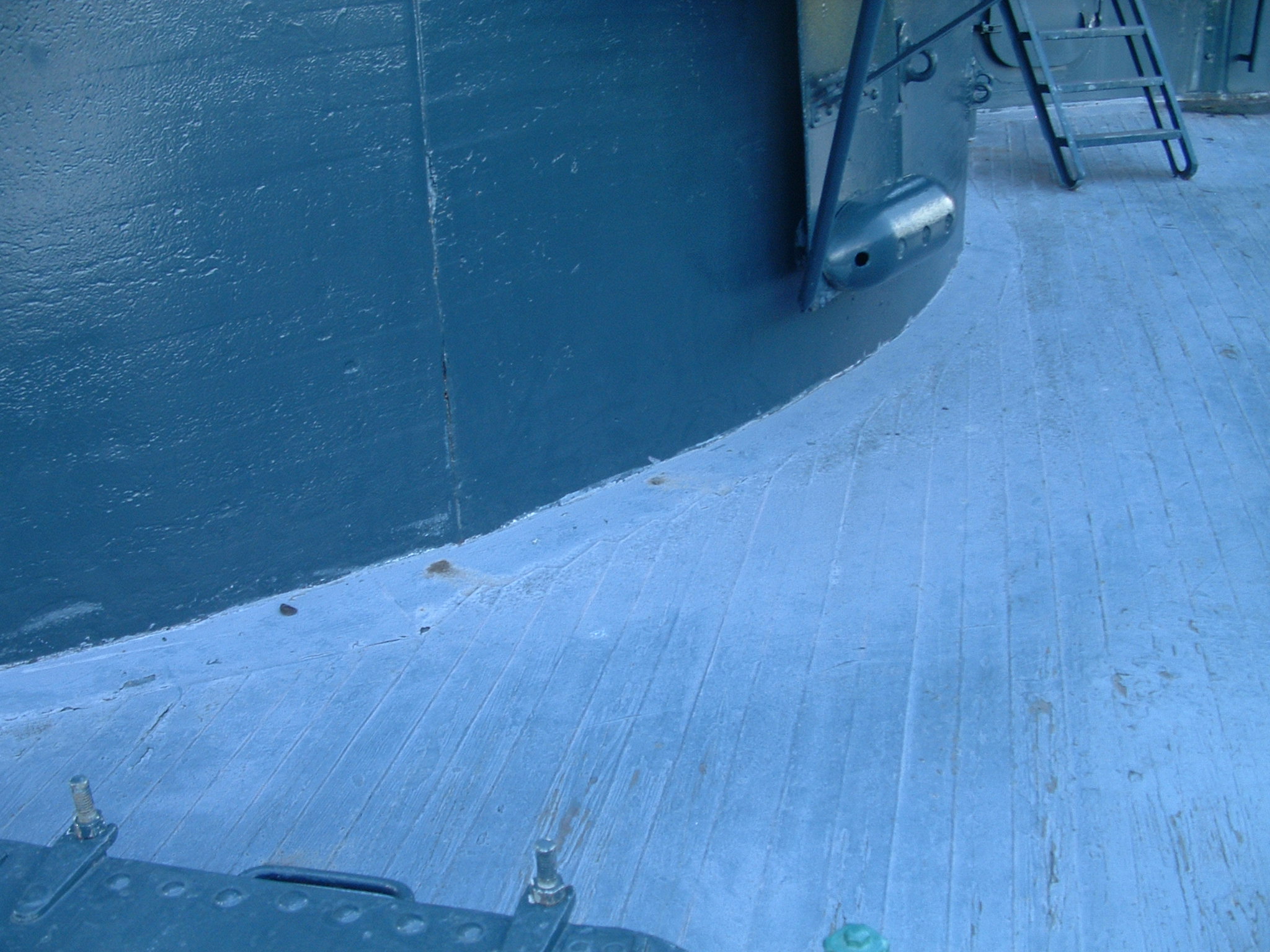

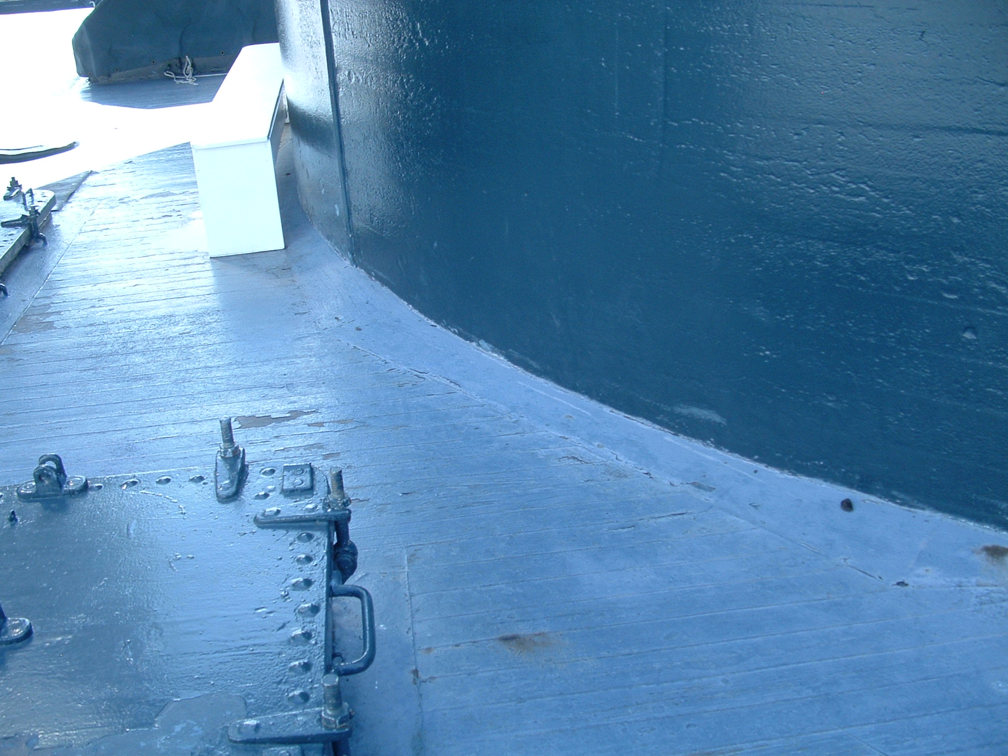

These pictures of the deck planking joggle around the forward turret on the battleship Texas (1912) might be of interest.
dreadnought72
  • Posts: 1,892
  • Location: Airdrie, Scotland
Re: Deck Planking stagger
« Reply #8 on: February 05, 2009, 09:00:15 pm »
Mmmmmmm ... love it. But then that's all I'm seeing these days.  %%
