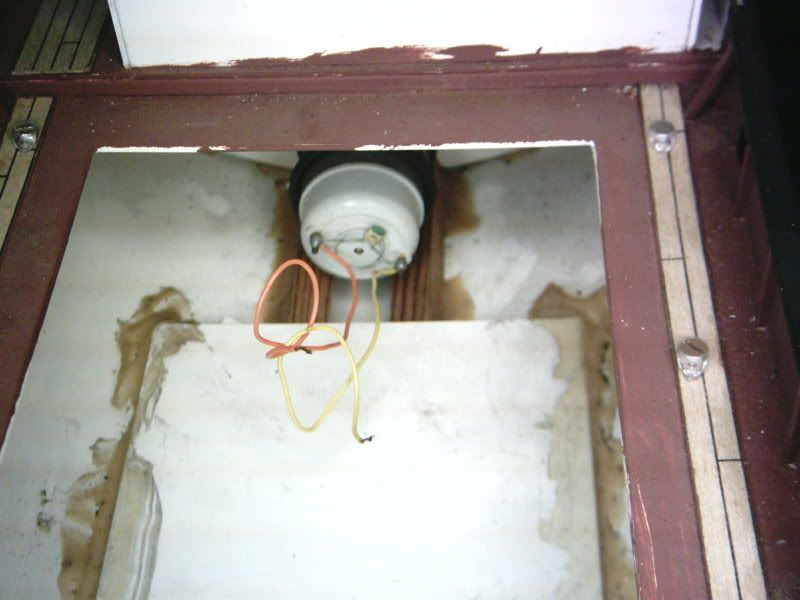

Acquired my first R/C model today  ;D (built mostly static before). Now have a part built Robbe Wotan but know nothing about R/C  :-[ and I think there are some bits missing ???. Also the wiring colours coming out of controllers? different to instructions supplied.

In the hull there is an electric motor with no name but with 1 orange wire/ one yellow wire.

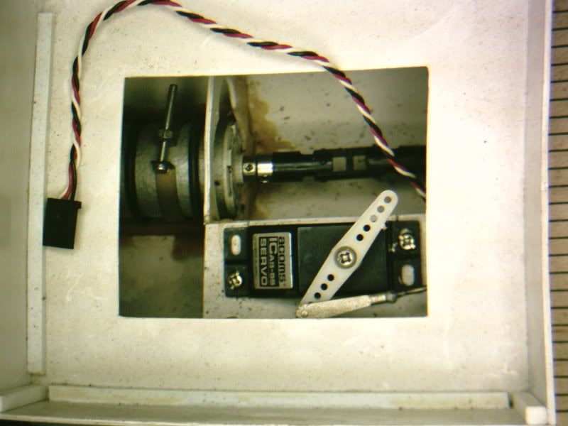

Along side this is a servo - ACOMS   ICas-5s attached to the rudder.(this has 3 wires Red/White/black terminating in a 3 pin socket)

« Reply #6 on: October 01, 2006, 05:06:52 pm »
2 pictures of what's in there. As you can see the servo is connected to the rudder and the motor connected to nothing.
What else do I need?

Hi MTB,
Looking at your pics I see you will need a receiver (RX) (the servo for the rudder plugs into that). You will also need an ESC (Electronic Speed Controller) which needs to be connected to the RX and the Motor. The ESC also needs to be connected to the drive battery (which you will also need :) ) Finally you will aslo need a Transmitter (TX)
You need to determine what amperage the motor draws to decide what ESC to get. They generally start at 15Amps and go up. The higher the rating the higher the cost. Also some ESC are fitted with a Battery Eliminator Circuit (BEC) which allows the RX to take its power from the drive battery. Without this the RX needs a separate battery.

How would I determine the amperage of the motor as it has no markings of any description on it?

MTB
I was afraid you were going to ask that. The way I do it is, with the motor out of the boat, connect it to the drive battery with an ammeter in the circuit.  The using a pair of pliers with padded jaws (I use some wood scraps) clamp the motor spindle until it stops or stalls. Quickly read the current and remove the clamp (a couple of seconds is too long!). The reading is the stall current and the max current the motor will ever take.

« Reply #11 on: October 01, 2006, 06:21:38 pm »
Given the size of boat it's more probably a 6 volt one. Before putting 12v through it connect it up to a 6v battery and put it in the bath. You will then get some idea of whether it is likely to travel at the right speed on 6v. If it goes in reverse then swap the motor wires over.

the motor looks a bit like a marx motor - monoperm possibly?

« Reply #14 on: October 01, 2006, 09:44:19 pm »
Judging by the thickness of the motor wires it is either badly wired up or a very low power motor.
Re: R/C newbie needs help
« Reply #15 on: October 01, 2006, 11:40:07 pm »
Assuming that it is the herring lugger, I wouldn't be looking for high performance - a 15 volt 385 size motor running on either 6 volts or possibly a 7.2V nicad and a 30 or 35 mm 3 blade prop should see it work as its maker intended without breaking the bank.  Any low-priced ESC should work OK.

« Reply #16 on: October 02, 2006, 09:18:13 am »
I think Grasshopper is right - it does look very much like a Monoperm motor. In that case 6 volts should be OK, seeing as how the Wotan isn't exactly a planing hull. I'd certainly replace the lousy wiring; the brown and blue leads stripped from some 13 Amp flex should do the trick. Colin Bishop's suggestion about connecting it to 6 volts and then testing it in the bath is a very good one. If this works OK then you might consider buying a 6 volts sealed lead-acid battery and charger. The Monoperm is a very economical motor and draws a low current, so you won't need a huge battery to get a decent sailing duration. 4Ah should be adequate.
As regards an electronic speed controller, the ACTion Condor 10 amp version is an excellent piece of kit and will cost you £26 ready-built. I'd personally remove the horrible Acoms servo and buy a cheap 2-channel radio (Futaba or HiTech) - preferably with only one servo (for steering). In my experience BEC - which stands for battery eliminator circuitry - is an unnecessary complication in a model this size and therefore something to be avoided. Use a separate battery supply for the receiver and servo, as supplied with the radio gear.
