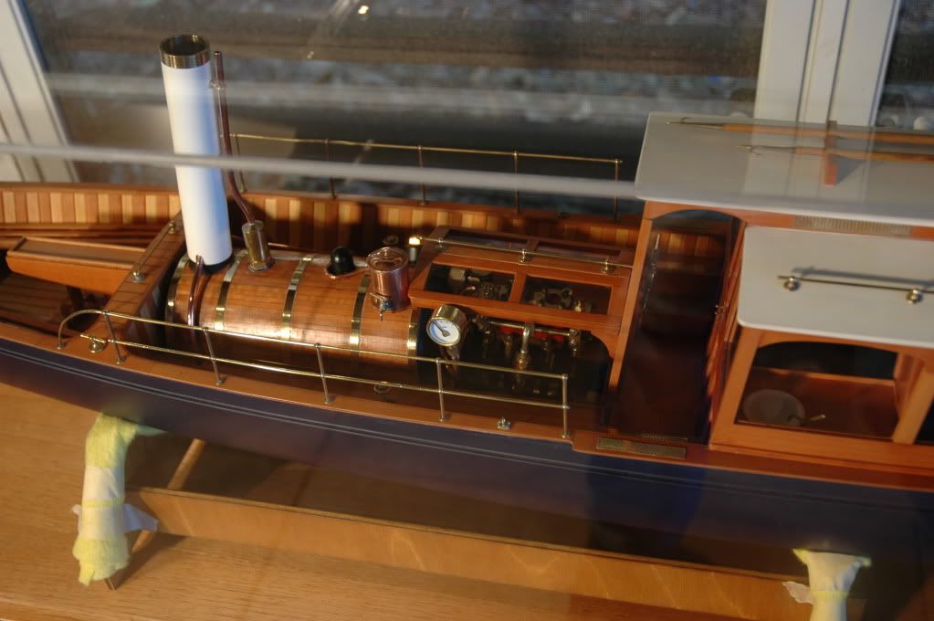

Fenders are in the wash and I still have to work on the stand, but..........................
