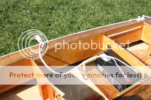

These are pictures of nearly a fire at LLanberis lake.This boat was new to the gentelman who owned it and had just bought it that morning at a local club down the coast fro £240 he was ripped off big time,now why do I say this well heck simple.No fuse to protect the esc,esc to small for the motor,he was told it would run for at least 4 hrs.How the heck can it when the motor in question is a MFA850 that draws supposedly 13amps when powered by a 12v7amp gell cell NO WAY ON EARTH.
he was going to take it back and ask for his money back....cant see it myself
Stav(very annoyed with conmen)

Can't quite see what's going on there mate...
Re: Nearly a Viking Funeral
« Reply #2 on: April 12, 2009, 07:36:05 pm »
cant you see the lack of fuse and burnt out esc
stav

The wiring looks a tad to thin a gauge as well
Still at least he's still got his boat  :-)

Looks like one of the old Mtronics there Dave, the new ones have thermal cut outs and all sorts, I had a bad batch of the old ones a couple of years ago, connect power and poof!
 The new ones I have been getting lately have all been fine up to now.

I'm not to sure what the issue is here though, I agree that there should be a fuse in the circuit but if there had been what difference would it have made?  The ESC would still have fried.  The fuse would have protected the rest of the circuit from any surge in current but it looks like he has been lucky anyway and there is no other damage.
All he has to do is fit a new speed controller and put a fuse in line and he's away again.  If he buys an Electronize it will come with a fuse already fitted so it couldn't be much easier.  I suspect that the original owner did not expect the ESC to do what it did and sold it in good faith.  His only crime is not fitting a fuse but that doesn't make him particularly rare and that wouldn't have stopped this from happening anyway.
