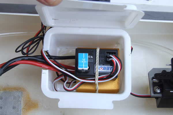

I have no idea, there is no name at all on it but here is a photo. The boat is a Hobby Engine Swordfish...
Thanks
Nige

In the new setup, does the steering servo work?  If the RX is not giving an output, the ESC will likely just sit there looking back at you.  I take it that the ESC is the gold box under the black RX in the picture, and thus really a separate item.

Sorry for the bad photo, what you see in there is the factory receiver sitting on top of the gold ESC (Which I know is a bad thing, but it's from the shops adverts) I've just taken this photo showing trying to get the ESC working in a Robbe Piranhia
As I say, it'll program using the Hobby Engine supplied receiver, but not with this Futaba..... :-)
