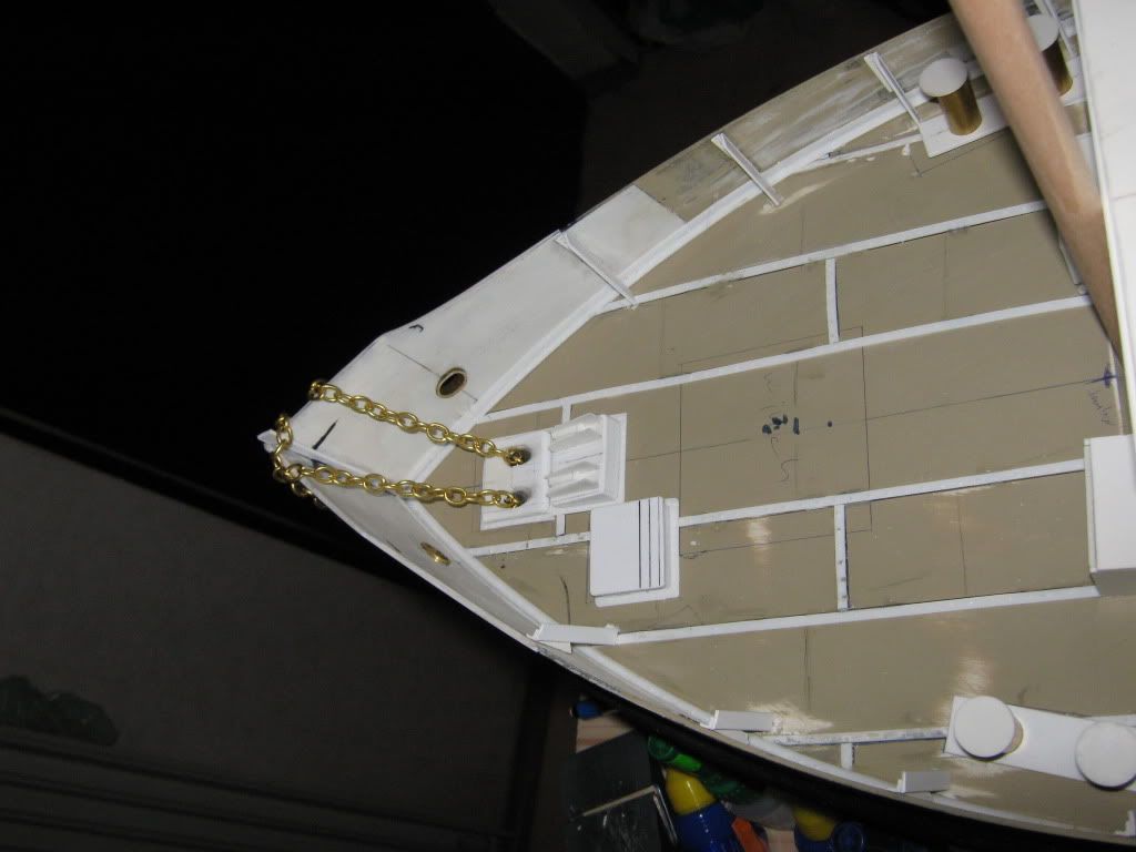

I tried to figure the best way to build deck with plastic cards (which I usually don't use, I like wood better).
Deck has very interesting curves, so I tried combining plywood and plastic.
So far no surprises yet, that I will not know until painting is done.
BTW of course I don't know what colour is right so if nobody has better idea I will probably go with dark red/brown.
 It supposed to be steel deck, so,.. Anyway pictures tell much more than my rusty English:

When I glued plastic strips I failed in accuracy so I had some puttying to do. And sanding. And puttying, and,.. well you got the picture. In between I managed to do some openings in the hull.
sjoormen

Next step- aligning strips with rivets. I noticed they are much harder to apply to convex curvature of deck than concave curvature of hull. Aligning was -and still is on certain places, well- struggle >:-o >:-o. Next step is placing "pillars"" ( please help me with proper term). I tried few different glues -best proved to be Revell's liquid glue, altough not good I hoped it would be. Those things are very fragile.
