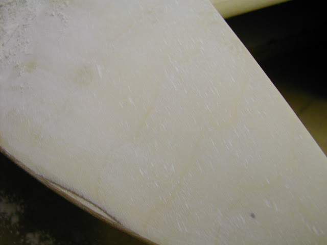

Fins and wing are now complete and fitted.  The fins were built up using 1/32 ply skins over a bass wood frame then edged with reasonably hard balsa.
Getting the holes through for the wing pivot posed a problem but some jury rigging ended up solving the problem
I've just realised haven't took any pics of the finished assembly so perhaps a couple more later.

Couple of pics of the wing and fins.
The whole unit is held on with 4mm nylon bolts in aid of 'breakoffability' (bet Windows hasn't got that one!). The wing pivots on them too - just need to work out a method of adjusting the wing incidence that will hold it rigidly but can break apart as well. The struts are made from 2.5 ally welding rod, the ends squashed in a vice and drilled. I don't expect these to survive a tumble but they are man enough to keep the whole thing rigid.
