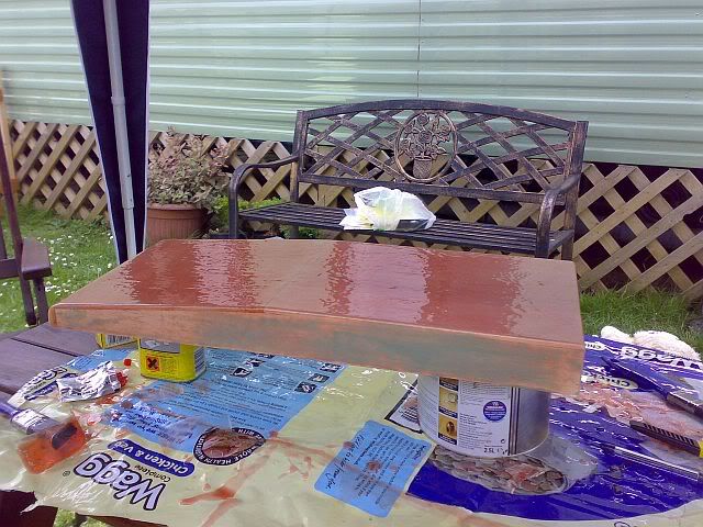

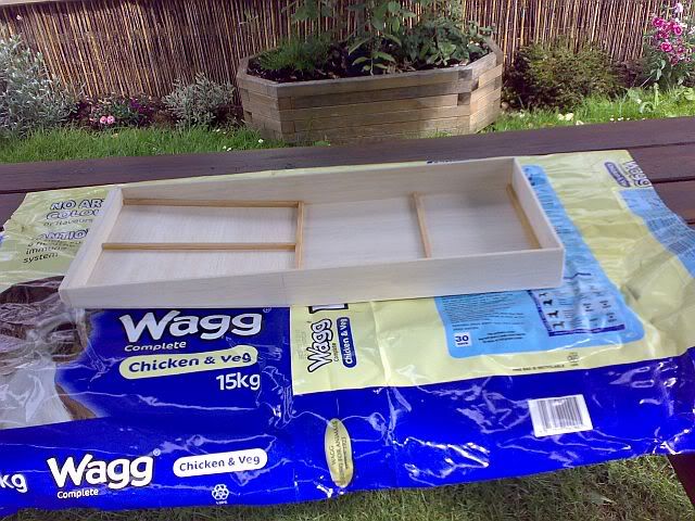

The narrowboat is now down to final detailing so so to next to be built is a swamp boat ( just to be totally different) %%
Main hull assembled
fibreglassed
Now to let it dry out for a day or two before painting.

My boat is 23.5ins by 9.5ins with a depth of 2.25ins. The hull is built entirely from 3off 4"x36" balsa with braces from 3off 1/4" spruce.The rest of the design is stil in the air but I suspect I will be using twin air rudders.  %%

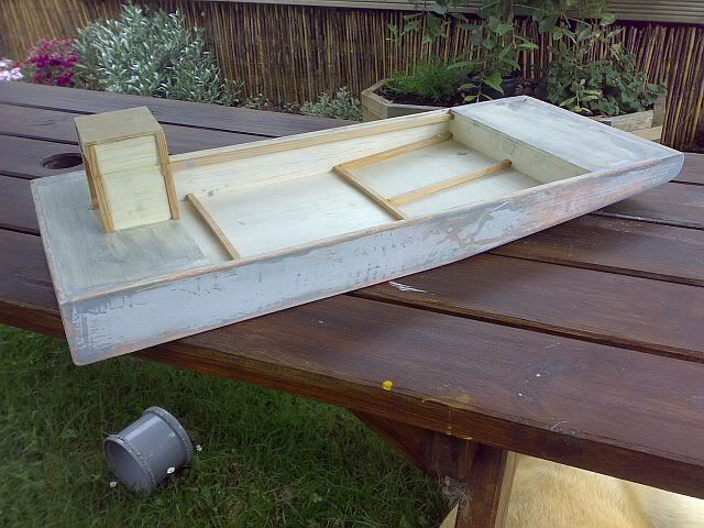

« Reply #7 on: July 08, 2009, 02:43:47 pm »

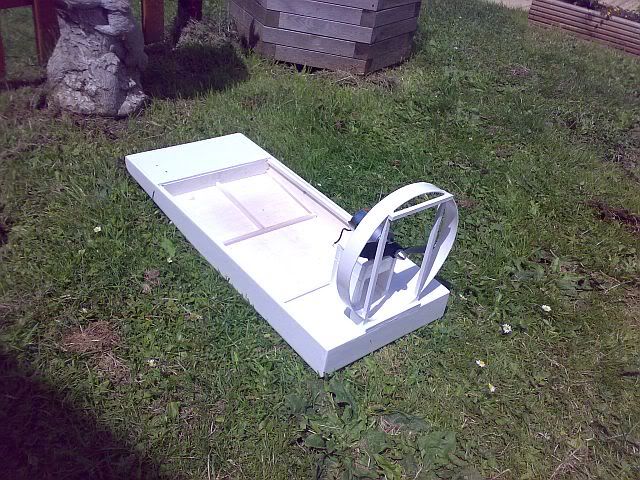

Front and rear decking fitted and motor mount in place

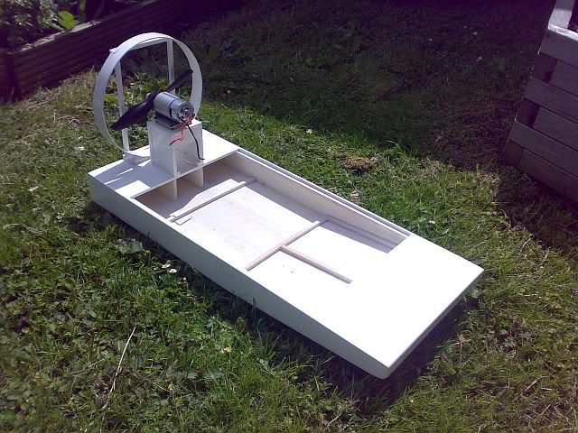

« Reply #9 on: July 12, 2009, 12:58:55 pm »
Found a 550 motor hang around in a drawer so fitted a prop adaptor and 7x6 prop and the whole caboodle got fitted to the airboat along with the rudder frame and prop cowl.

« Reply #10 on: July 12, 2009, 05:52:20 pm »
Hi Gromarlie ( do you have a name ? )
Is that a Pusher Prop?, just asking cos if not it will suck instead of blow. :embarrassed:
Len.
gromarlie
Re: Swamp boat
« Reply #11 on: July 12, 2009, 06:59:54 pm »
Actually it is a tractor (standard) prop but fitted backwards and the motor reversed so that the wind blows the right way  :}
I did need to get a pusher prop for the IC engine as thats not so easy to reverse  >:-o

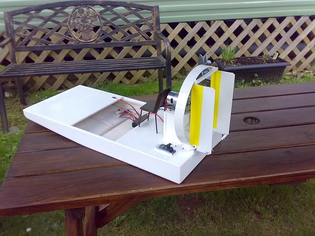

« Reply #14 on: July 17, 2009, 01:41:26 pm »

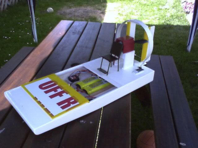

Rudders & seat done along with a bit more decking,
Now to position the esc & electrics
gromarlie
Re: Swamp boat
« Reply #15 on: July 25, 2009, 11:00:52 am »

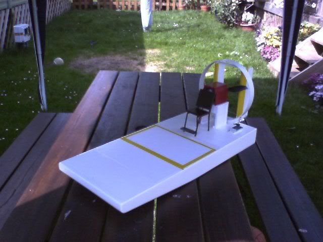

electrics are in and last bit of deck
Deck hinged shut - ready for test run  :} :}
Hinged deck section is 1/4"correx (ex estate agents sign) with edges sealed with packing tape and hinged with same
