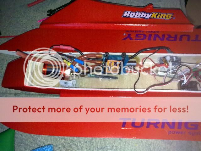

I also modified the kit and want to show you mine and for others to show what can be done using this kit.
I finalized the building stage and tomorrow is its first maiden.
By using a selfmade hardtop this little red dictator weighs with 2s 2200 25c lipo, a whopping 635 gr.
modified tunnel by adding a step
the inside
more building pics here
Hardware:
Turnigy 450 H2218 Brushless outrunner 3200KV
Etti coupler 3.17>1,2mm
Etti 1.2mm BB Wire Drive with Strut
HK noname rudder, modified bracket
Hobbyking SS Series 40-50A ESC, modified watercooling
TURNIGY 3A UBEC w/ Noise Reduction
Conrad mini servo
Graupner 2299.30 carbon 3blade hydro prop
available lipo's for testing: 2s 2200mAh zippy oem 25C, 3s 2200mAh Turnigy 25C, 2 and 3s 1800mAh Flightmax/Turnigy 40C
hopefully i'll be able to post a video tomorrow

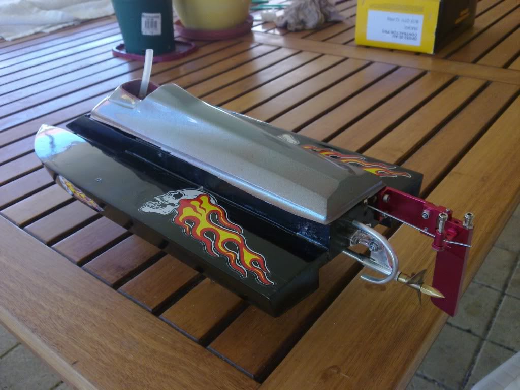

well i thaught an update was kinda necessary as i have ordered a new motor for my little baby and done some internal changes to make a little difference in weight distribution
i have mooved the motor as far forward as practical so the batteries can be a lot mor midship, taken out the heavy motor mount and put in a very light one have dropped 100 grams in just doing that
sprayed the cowling and given it a new look
and here she is all ready for testing this arvo ill try to get a video or 2 if is not too choppy
