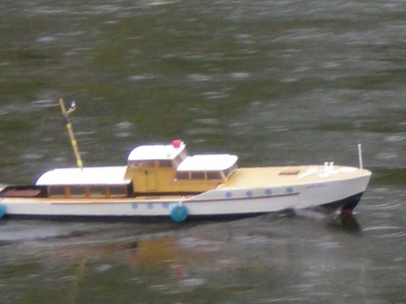

Yes,I will be adding to her,after the cabins have been stripped down and re-built.I may either plank the hull or glass it,because the hull sides are very thin. I took some photo's today along with a short vid of her.She's running on just the throttle trim,so that i can steer and film at the same time,as you can see,she's quite maneuverable.

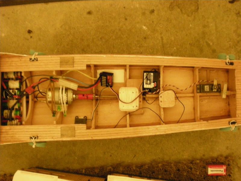

I've removed the 3-stage mechanical speed controller,and replaced it with a 15T limit ESC. She's powered by a Robbe EF76 II motor with a 2-blade 30mm nylon prop. I'm going to go against the kit convertions here and fit a set of chines to her,to kick the water away from the sides of the hull.I'm not going after speed here,just aesthetics,to give her a more unique look.

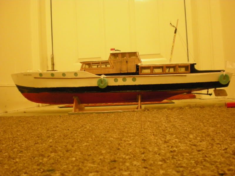

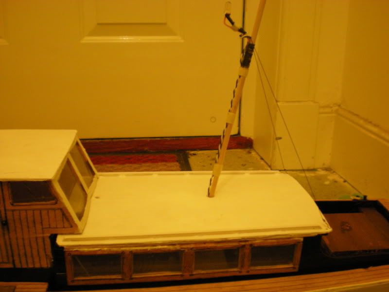

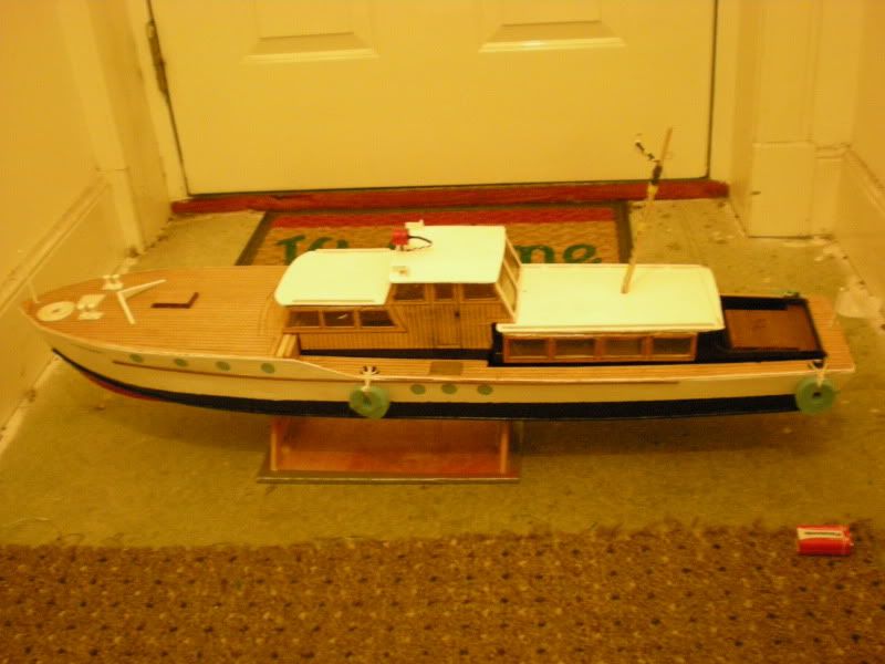

Please forgive the rather thick wiring on the mast,but I'd used the lighting rig from one of my cars to light the boat. How she's looking just now,the painting has still to be tidied up though.

« Reply #9 on: October 25, 2009, 08:21:00 am »

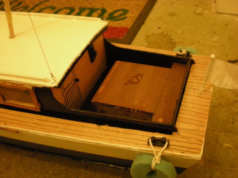

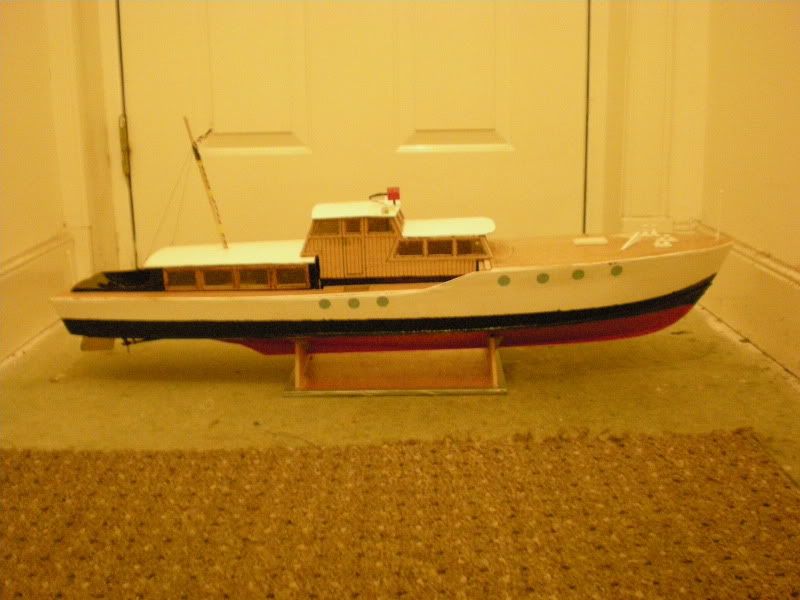

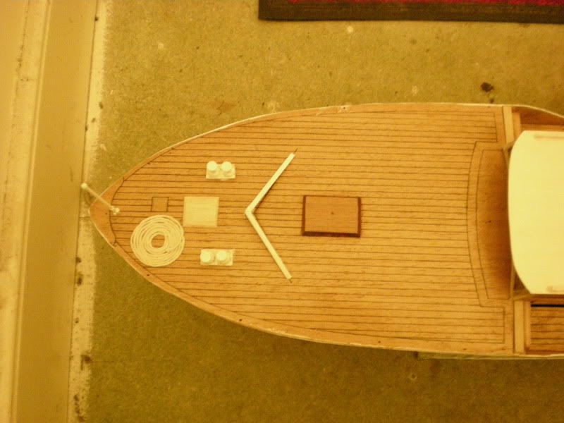

An internal shot of the workings as they are now.
The aft deck,with the servo's boxed in.Still to be finish painted.
Aft cabin with hand rails and mast fitted.
Wheelhouse and fore cabin with handrails and navigation lights fitted.1st section of rubbing strake fitted.
Foredeck.
Two views of how far I've got to date. Still more work needed,but she's getting there. Now named the Jennifer-James,after my daughter and grandson.

At long last,the Neptune has finally had her foredeck handrails fitted. Now she's starting to look the part. O0
