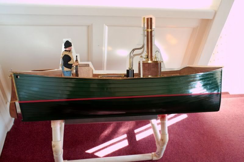

« Reply #103 on: April 25, 2010, 04:03:33 pm »

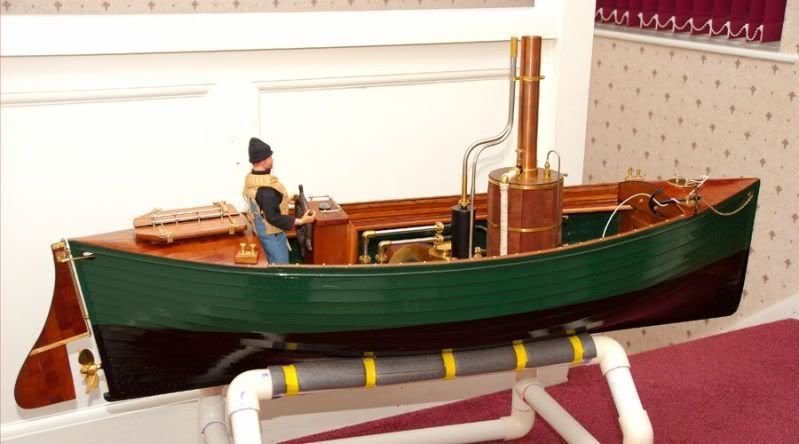

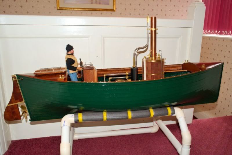

Changed a few things as it looked too "woody".....Few more details & it will be good for this year.  Next winter, more internal detailing....
This has a cavernous deep keel which I filled & grouted with lead shot to overcome the possibility of rolling caused by the high C/G coffee pot boiler...
The green is closer to GWR livery, not as "bright as seen here...
"Artists impression" of the final paint/colour scheme. The green here is closer to actuality...

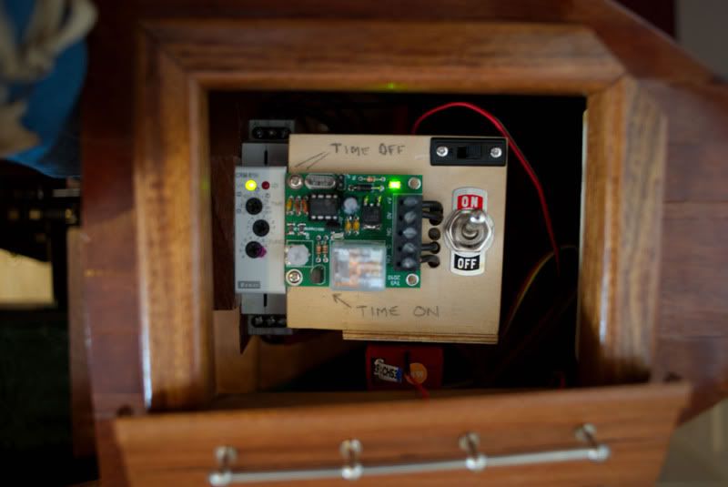

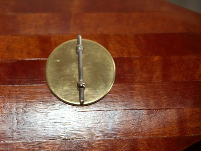

My pump on/off/ duration components...

hi........thats  a great boat.. :-)).......bot i better like it ,with  the old wood look before .. :((     maby just with the lower part paintet?........

I too struggled with the thought Bernhard. The problem was the " wood"  finish to the hull was a little unstable ( it was coming off in places) . Orion moldings kindly sent me a match to touch up or would have gladly repainted it for me free of charge. I had trouble matching & indeed the finish would have needed a total repaint. That meant me sending it back/shipping etc. with all of those hassles, I too am disappointed . The truth is also there was too much wood with little highlights. You have achieved the weathering of wood & materials to the level of an art form, I will one day attempt to come close. Today, I will have her outfitted as a pristine steam launch, who knows what tomorrow holds...  :-))

Hey  Oh  OK..so do i better understand it,,,i like the green color,,look good ,,,When i did try to make the Wood look on the River Queen, i used, the Braun color fore leather..and so 3 times with the good old floor lack...works real fine

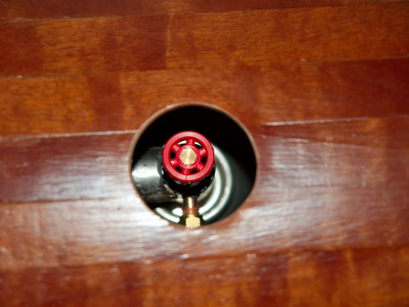

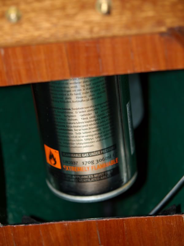

After my visit to Cheddar Steam Club I decided I would also like the option of using disposable gas canisters. This now allows me to use the fixed tank or the canisters. Also up front is an auxilliary water tank that doubles my boiler feedwater capacity.. Took me all morning to make that cover ( by hand, I don't have machine tools) & it's a lot shinier than the pic shown... I now have blisters...  :embarrassed:

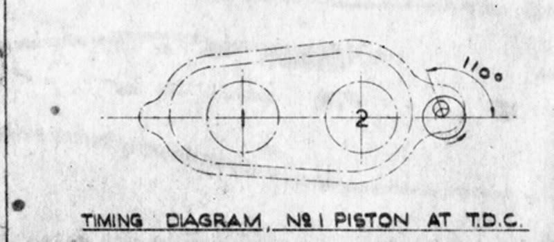

Here is the timing diagram....No 1 piston at TDC with the eccentric drive at 110 degrees. Dial in with correct rotation to make sure you remove all backlash.

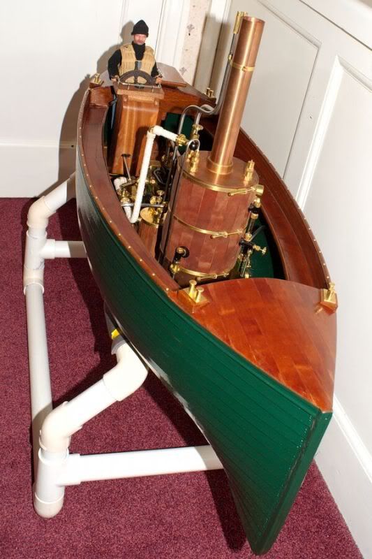

Finished (for now,)  time to sail....Where is that sunshine ?...

If someone could tell me how to time these engines, I will be very grateful. I have a couple of the Stuart Boat Engines, this one, and a Star, but the names are open to conjecture, neither look anything like these examples, in regard to the finish.

Neil, If you see my pevious post I have posted a timing diagram. I would "guess" the Star & the Sirius would have the same timing.... As for patience, I am retired & it has been a long winter.. Still here as far as I'm concerned... {:-{

I note from your pictures and descriptions that you have an electric feedwater pump under electronic control.
Any chance you would explain the principles of the electronic control?

Basically two timer relays. You can get dual function relays but they are harder to find & more expensive. Sadly I do everything in my head & do not put things down on paper ( like a circuit diagram.) However, when one timer times out it starts the other, when that times out it starts the first. That way you can alter the duration the pump is on & also the frequency of cycles. IE Pump on for 1 minute, delay of 30 seconds, both being independant & configurable. Later I propose a smarter circuit with boiler level being the control factor...

Thanks for explaining how your electronic control works, inactual fact it is simplicity its self. Should you want to initiate pumping from the boiler itself I have a couple of systems which can do this by either sensing the boiler water level using a probe which screws into a suitable spare bush or the other way is to "look" at the water level in the gauge glass a la Cheddar models method.
Unfortunately both systems have come to a grinding halt as they are both based on programmable chips (PIC) and the club member who did the programming for me died late last year. I have tried to teach myself to do the programming myself but to no avail. I have yet to find some one to help.
