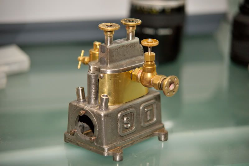

Bearing fitted to eccentric drive, cleaning up, checking & fabricating gaskets. Dummy assembly before modifying the head to reduce back pressure. Loving the way this engine goes together...

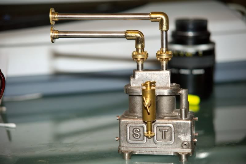

Got the exhaust fabbed up, most likely going to insulate and or tone it down a bit but the extrovert in me favours the shiny bling..... It's going to connect to a centrifugal separator, oil/condensate dropping out and being collected in a tank, with the separator freely exhausting to atmosphere

1) are the flanges DN 1/8" or DN 5/32"....& are the bolts 8 BA?
2) will you be using paper gaskets or synthetic gasketing [Hyperlon] ?
3) did you make them or are they comercially available? [Winfried Niggle .de] in Germany manufactures model flanges...however I suspect yours are of a smaller sizing
I have not seen a model centrifugal oil seperator...so it is best to try & maintain as much heat in the exhaust steam to ensure the highest drop out rate at the condensor....& stainless steel [tubing] can be very un-forgiving in heat transfer
Keep us posted with more .jpgs as you progress  : O0 .... many Mayhem members are very keen on steam articles.......Derek

I bought the 20mm flanges for 8mm tube from Model-Niggel and they are little jewels.... Supplied are gaskets and bolts :-)) Centifugal separator works on the principal of swilring condensate/steam around the inner circumference of a drum vessel. This is a static device, the gasses entering at a tangent to the inner vessel wall. Heavies are separated by centrifugal force and drop to the bottom to be collected/drained or in the real world steam trapped... :-)) I like the ridgidity of stainless tube together with its poorer thermal conductivity properties compared to copper....

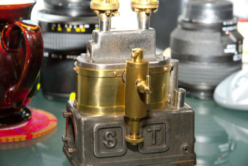

7 hours work customising the cylinder jacket. I may put a few more copper rivets on the bottom band to make it look balanced... Retired with weeks of terrible weather, this hobby stops you going crazy I spose... :o

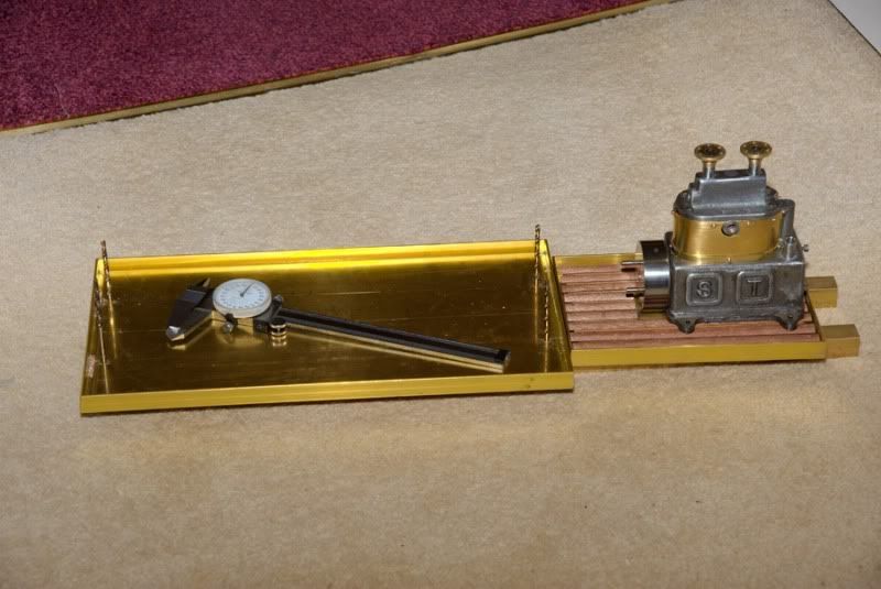

No Postie for a couple of "daze" so working on the engine-boiler bed.....Two brass plates surrounded by containment bund/frames mounted on two 5/8" sq brass rails....Wooden engine pad decking, spaced for drainage to surrounding recessed "gutters", to be copper riveted ( when Postie brings my 1/16" drill bits..) to simulate nails. Total length, 500mm  :-)
