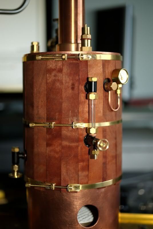

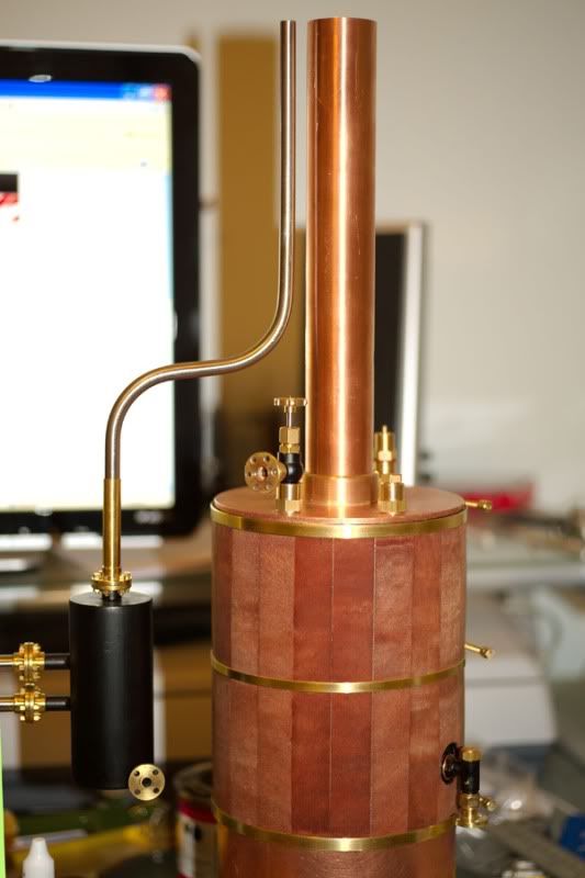

I went with automotive exhaust bandage/wrap. Making a stainless steel clamshell jacket/casing with external wood lathes for that scale look... .
benjaml1
Re: insulation under wood lagging?
« Reply #6 on: February 10, 2010, 04:08:58 pm »
Didn't think that "perfect" planking would suit the ethos of my model, so I went with rough & ready...
benjaml1
« Reply #7 on: February 10, 2010, 09:47:29 pm »
Couldn't stand it, just had to tidy it up a bit....   :embarrassed:
