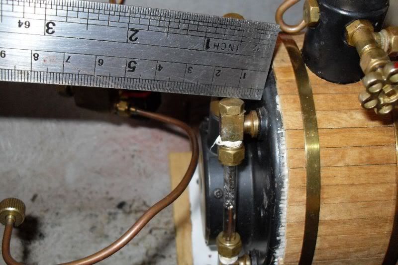

Charles, the ABC is great, WORKED very well, until the sensor on the sight glass suffered from heat stroke.I purchased a new, very well made one from a fellow member here, but alas, it's just too close to the burner, & I can't shift the position of the sight glass...

You must, like me have the older boiler. they moved the sight glass to the other ens of the boiler for this reason , I am going to get two plugs put in mine so I can use mine again.
you could try some ceramic sheet to act as a shield.

Sorry to see the sensor has failed, I worried about the positioning relative to the burner when I looked at the picture you emailed me.
Doing a bit of lateral, thinking how about moving the watergauge away from the burner. Two options come to mind the first is to make two long brass adapters threaded on one end and tapped on the other. These would screw into the boiler and the the water gauge into the tapped end. If this puts glass into a vulnerable position use two Stuart models cast elbows with stainless steel nipples to set the water gauge at right angles to the boiler, possibly using short adaptors to move it well away from from the burner tube.
If you wish me to supply thread sizes and Stuart part numbers let me know. Do you want another sensor?

Tag, you can see the problem...I'll have to think about it, solution #1 seems ok, but I'm a builder in all things except metal <:(
I have tried shielding, but limited space & you still want to see the water...

You could use stand off nipples to get the glass away from the burner. In fact it really doesn't need to be there. You could plumb it to a dark/ cool/ quiet space for control & have the optical glass in parallel  for scale. Few banjo unions & some pipe work & you would be good to go... Just a thought

Before changing the location of the sight glass, how about trying some heat insulation tape on the burner side? I don't know the brand name but it is silver in colour and often used by the r/c car guys to shield the combustion engine exhaust.
