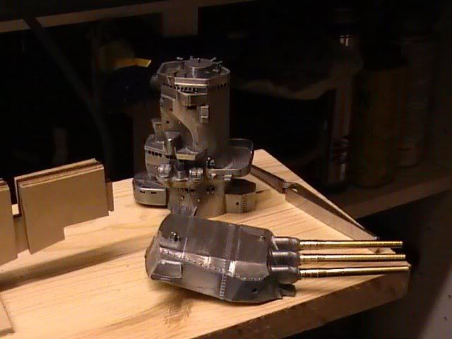

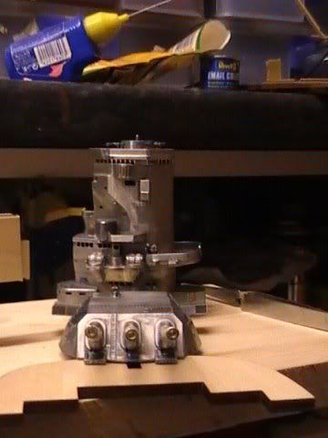

The next set of photos are of the Maine bridge and one gun                                                        this is the radar brass bits                   %%                                                                                                                       now for the hull and running gear                                                                                                                                                                                                                               just a few words about the running gear 2mm shafts X 4 the motors are small but powerful power board is from action 2 speed cons Montronics and one 3 cell lipo lights port and starboard fiber optics leading to 3mm LEDs sorry this one is so long but had a lot to catch up on from now they will be a bit shorter

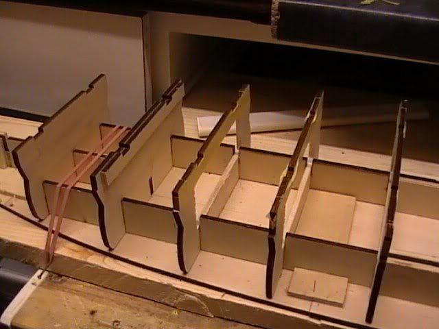

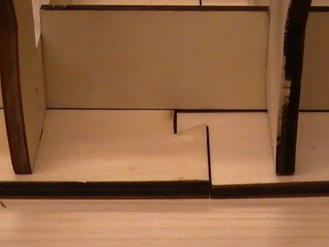

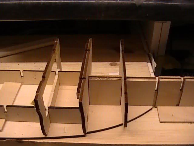

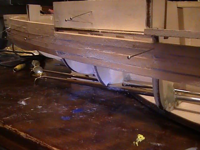

just Watting for Email to get to me so did a bit more planking. When it is complet i will sand and. Cuvier it with glass tissue and resin in side and out this will give strength and make it water proof

Still no Email so you can have more planking hope it is up to scratch as all I have seen on this forum is very ,very good                                                                                   The last 2 photos are of the reinforcing it is the scrim that plasters use the  self-adhesive kind and fibre glass resin.Only the stern has been done so far  by the way the resin is mixed with baking soda it seams to set better

« Reply #7 on: May 18, 2010, 02:09:07 pm »
that is looking very good so far what is the reason for adding baking soda to the resin? and what kind of resi is it?   Geo.
jinks8
Re: Yamato jinks8
« Reply #8 on: May 18, 2010, 04:12:37 pm »
      sum times when you mix resin by its self  it dos not set properly and you get a sticky residue on top if mixing sumthing in it helps get rid of the sticky stuff had a lot of problems sum time ago got the tip from sumone in OZ and it seams to work have not had much trouble since doesn't have to be baking soda but it mixes well the resin is from Halfords( Davids fiber glass resin)

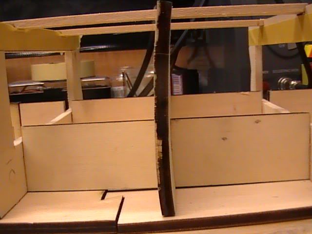

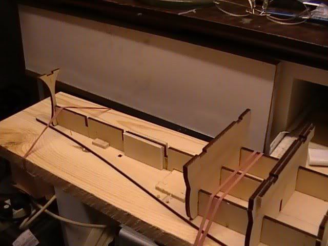

back for agane with more fileing. Parts 1,2and 4 on page 58 1.2. Are  the thinnest part of the bridge base and the small part 4.  that has to go on top have a faire bit of fileing to get a good fit                                                                                                                                                                                                                                                                                                                                      And after all the sanding and file work nice and  flat

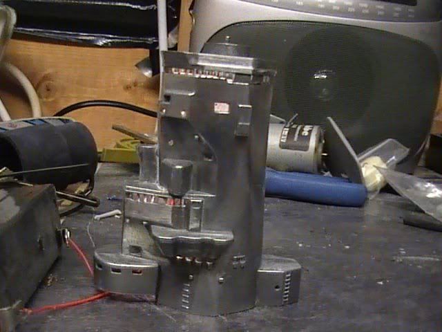

Hi back again had to put right the vow mothing Major just had to many parts in it how i do not know but it was wrong, but with a bit of heat to melt the glue it came of                                                                                                                           and after           That sorted   rest of the parts in this issue went together with out much of a problem  just a bit of filling  andwork with a file to get parts to fit                                                                                                                                                                                                                                                                                                                                                                                    ho and more windows                                                                             but it is all  Worth it in the end

Hi there looking good
what is the super structure    made of as it look like some sort of metal.
jinks8
Re: Yamato jinks8
« Reply #16 on: June 02, 2010, 11:34:06 pm »
I that it be it is all cast it nay end up a sub not put a few more bits on                     the grills in the first tow photos are made from the  brass that cumes with the kit for more vents if cut the right way you have plenty left :}

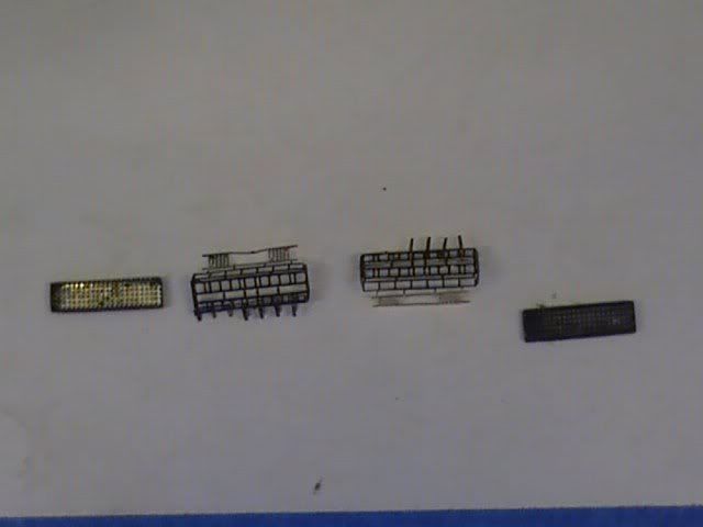

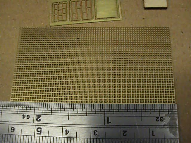

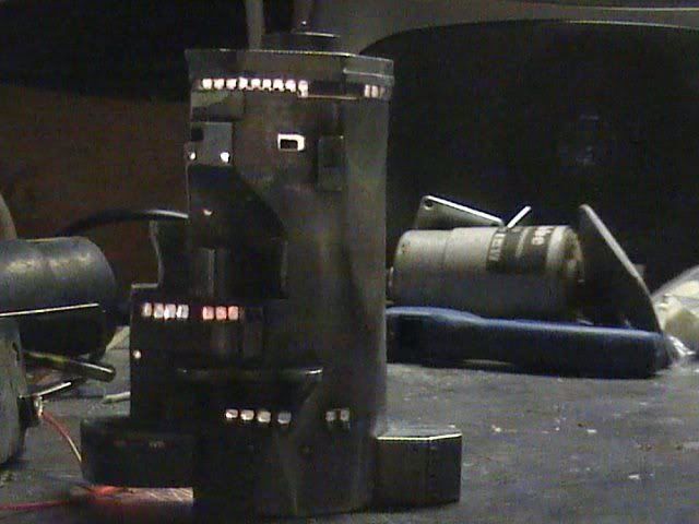

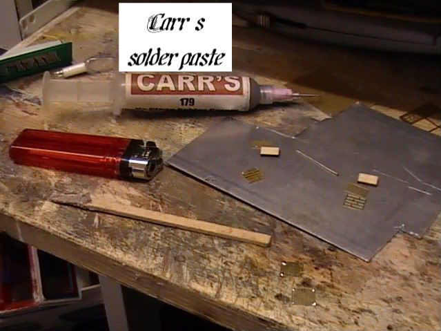

« Reply #17 on: June 11, 2010, 04:26:15 pm »

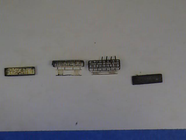

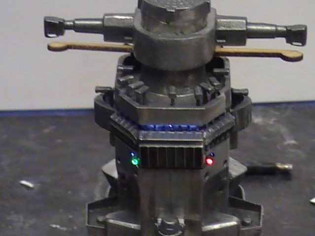

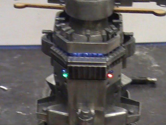

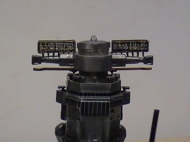

The vents for this are etched brass and of good quality on putting them to gether the large grills on the front have to be bent to shape on my first one i forgot and had to do it again. I soldered mine mainly to get the practice the shaping of the grills is achieved by rolling a round rod screwdriver or smiler will do on the bit to be shaped this will cause  it bend the more peruser you use the grater the bend                                               i think the next is the photo that has gone astray in my last post        to cut the photo etched grill selo tape the back plats no to it then cut round them

Looks like you've made a very good job of the soldering work on the superstructure so far. My soldering skills haven't progressed much beyond that needed to solder electrical bits together, that's why I usually rely on superglue/CA for gluing fine detail parts in metal  {-)
What metal is the superstructure made of? Looks like zinc alloy (same as used in diecast toy/model cars etc.). It'll certainly add a lot of topweight, given how bulky and tall Yamato's superstructure is.
jinks8
Re: Yamato jinks8
« Reply #19 on: June 13, 2010, 02:01:40 am »

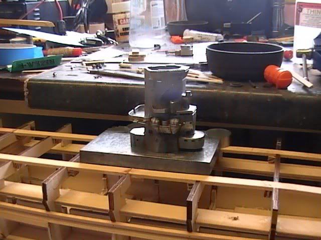

yes it will be heavy but think i can get over it there is a lot of the hull under water will have to put a lot of ballast in her and may have to put on a false keel the metal could be the same as used in cars that i leave to the( drips under pressure) IE experts

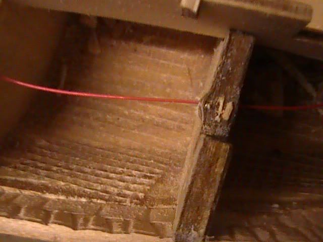

Well think i have sorted out the steering but can not test yet till i get the ruder sail by fishing line lo starch 35 lbs braking strain                                                                                                                                                                                                                                                                                                                                                                                                                                                                                                                    the ruder arm is brass arm soldered on to half the brass center of a chocolate block
