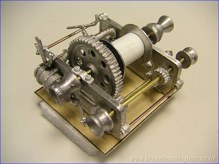

Anyway, the instructions and diagrams for the winch are..... well, not very useful!
Someone seems to think steam winches are an everyday occurrence in modern daily life....
After 3 or 4 assembles and disassemblies I finally had the thing together..... correctly!
The kit supplies  a piece of ply for the winch base but I substituted this for a piece of plastic (CD case)
that would look more like iron plate when painted.
The various pipework casting were then cleaned up and painted.
Painting the winch was quite enjoyable. I painted the whole thing matt black, then over the next few days
painted various bits with other blacks, gloss, satin, smoke and white.
In the end a nice little model in it's own right.
