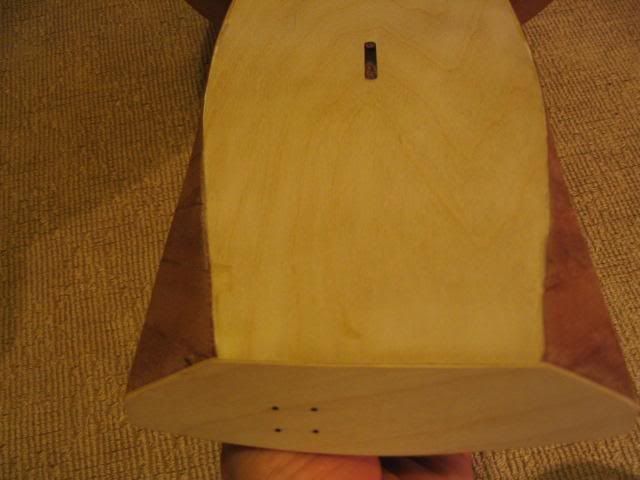

Disaster at the bow!
Planking was so easy I got carried away and clamped the planks at the bow too much, result was the "nose" went very wrong! I decided I could either 1) cut the whole section out and make it again using solid balsa wood or fill it, I decided to fill it.
Pics show the original shape, not too clear but you should be able to see how it pinches at the tip.
I used standard wood filler...more money at B&Q!! It sands very well.
Reading the posts on Orby's thread about sanding....I always use a cork block and just use drawing pins to hold the paper on, normally use 320 grit sandpaper for final finishing.
