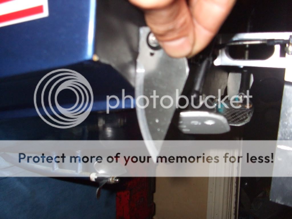

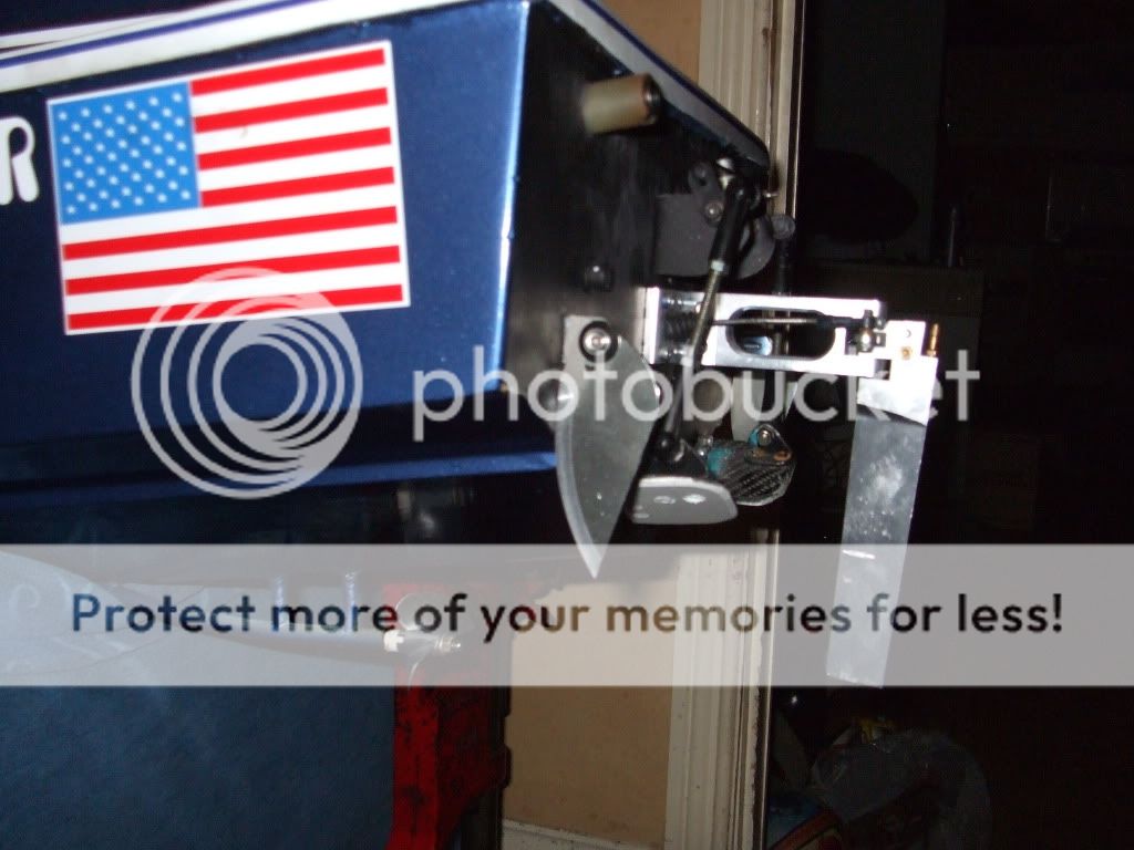

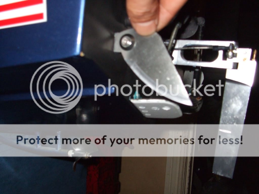

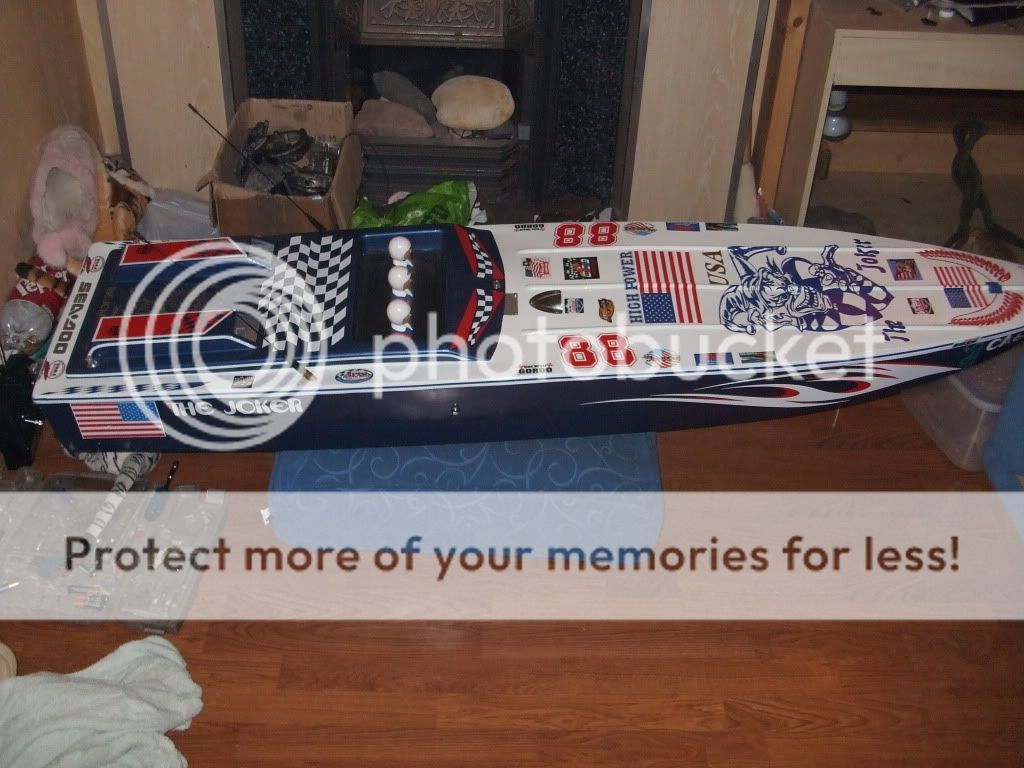

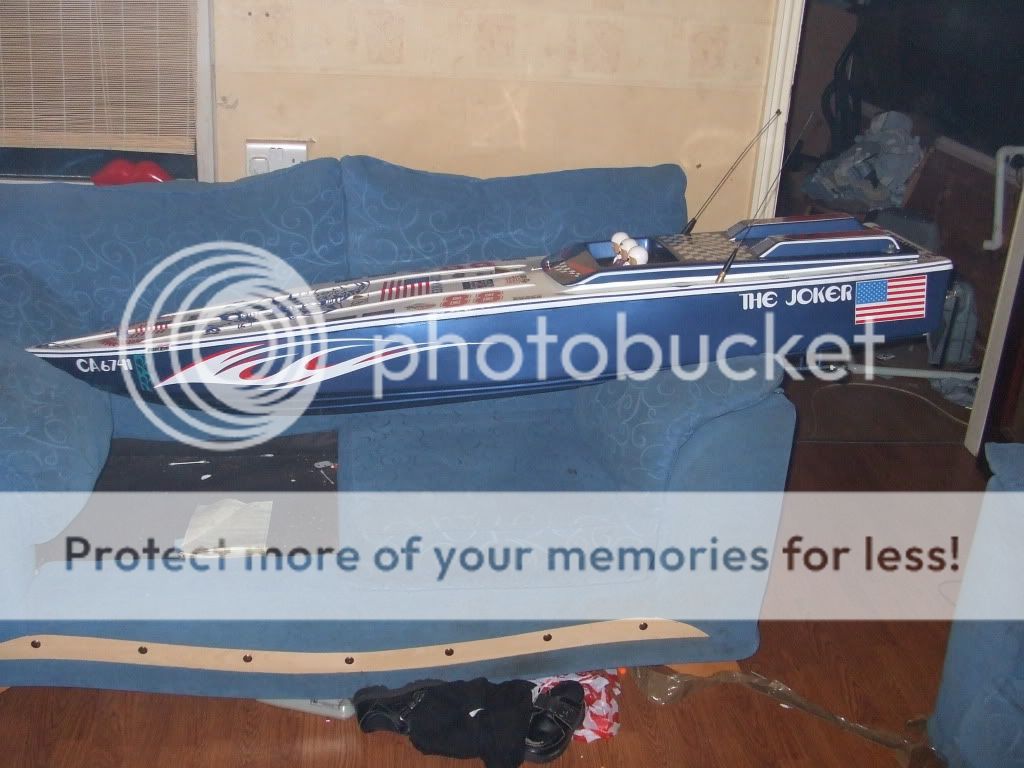

Hi all im new here and I have just been to collect my new toy tonight and could do with a little help and advice from some experianced users as I have never had a boat before so have no idea what maintanance / set up needs to be done or how they handle in the water ,,.
Has anyone got any tips for me so that i dont sink it 1st time out ?
What sort of position should the 2 vertical blades at the rear be set at ? and what do they do ? asking as they are just swinging loose
Anyone know what boat it is ?
Here are some pics , its a big one at 6'3" from rudder to front any comments or advice welcome thanks

The hull shape is traditional 'Cigarette'
The "dagger" plates" should be straight down, ie. the trailing edge should be parallel to the transom.
Make sure the 'flexy shaft' is well lubricated before running and runs completely free.
(You may also have to leave quite a bit of a gap between the drive nut & washer and the stuffing tube end to allow for binding.)

Nice looking boat :-))
The turn fins should be at 90 degrees to the running surfaces and placed at the chine, mount them so they are not in the water when running straight.
How much rudder do you have below the keel? You will probably need about 70mm to enable reasonable steering. The other thing to check is how much throw you have in the rudder, increase the throw and see if it improves.
The trim tabs should be about 2-3 mm above the running surface on the transom.
