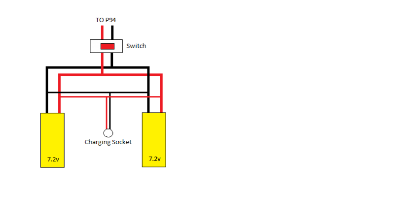

Hi all
I am looking to run two 7.2v nimhs in parallel (some will disagree I know) and I would like the option to use a solar panel bankside to charge the cells whilst still in the boat.  After use I will simply remove the packs and charge them at home.
My question is, is it as simple as connecting both packs to a charging socket and then plugging the charger into the socket.  This is what I had in mind:
Any thoughts?

I think he means a solar panel ashore to charge the batteries when not afloat
Ray, its a no no because the solar panel would not put in any worthwhile charge
in the time it would be connected.
Either buy a 12volt input charger to use from the car or buy a couple of spare packs
Both cheaper options
IMHO I would get a couple of spare packs or if room higher capacity batteries

« Reply #5 on: August 22, 2010, 05:19:27 pm »
Although I do run battery packs in parallel I never charge in parallel.
This is fraught with problems.
And as has been stated the trickle charge that you would get would hardly be worth it.

Sorry guys, think I may have mislead some of you  :embarrassed:  I already have a solar panel.  It is a 13W panel which charges at around 750mA.  I also have 8 new 3800mah packs so shouldnt really need to use it but I was just wondering if I did would I be able to use the cct

Hi all, if my arithmetic is OK then recharging 2 x 3800mAh batteries in parallel at 750 ma. is going to take at least 12 hours.
Just think of the cost of sandwiches, coffee / drink, suntan lotion, just to stay out there that long.  Not often you get 12 hours of sunshine in one day either.
You might need a book as well as most of our lot would have gone home after 3 hours.
However I would not use that circuit configuration, first I would retain the Tamiya connectors as you have several sets of batteries, enabling an easy change, then the circuit should be built into a dpdt switch as per RC on/off with the Off side connected to a charge socket, the batteries connected to the Centre contact and the On side to a meter point to check voltage.
I have just bought some 3800 mAh batteries off the internet at 4 for £24.99 inc p&p. are these the ones you have and are they OK?
Good luck and regards Roy
