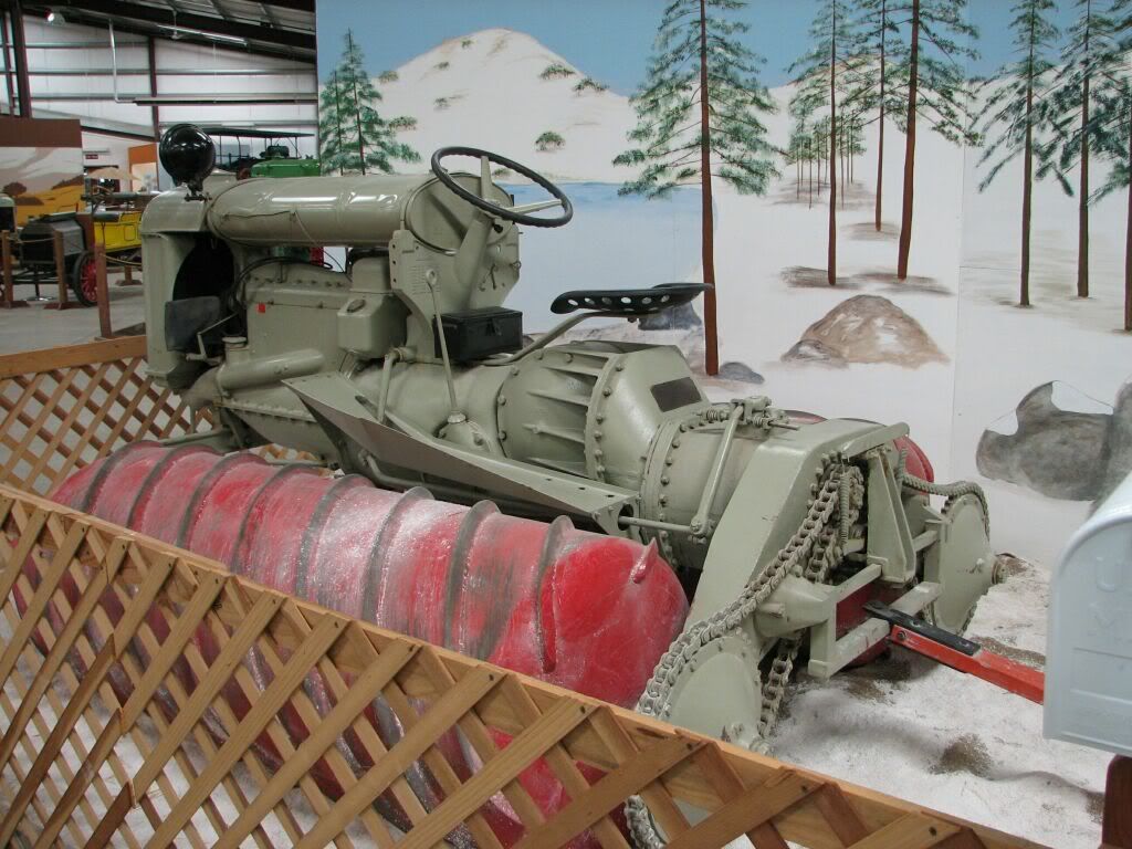

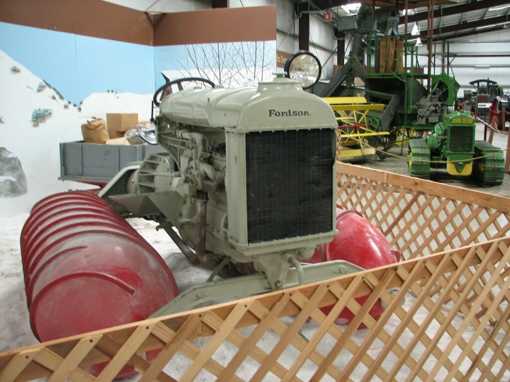

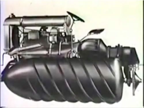

I am wanting a horizontal boiler for 2 - Saito 3DTR steam engines to propel a snowmobile similar to what the photos resemble, but modified to look like a Jules Verne SteamPunk vehicle.
Can someone please educate me on the best drivetrain and engines/boiler system?
What gear ratios would I need?
Thank,
Giovanni
