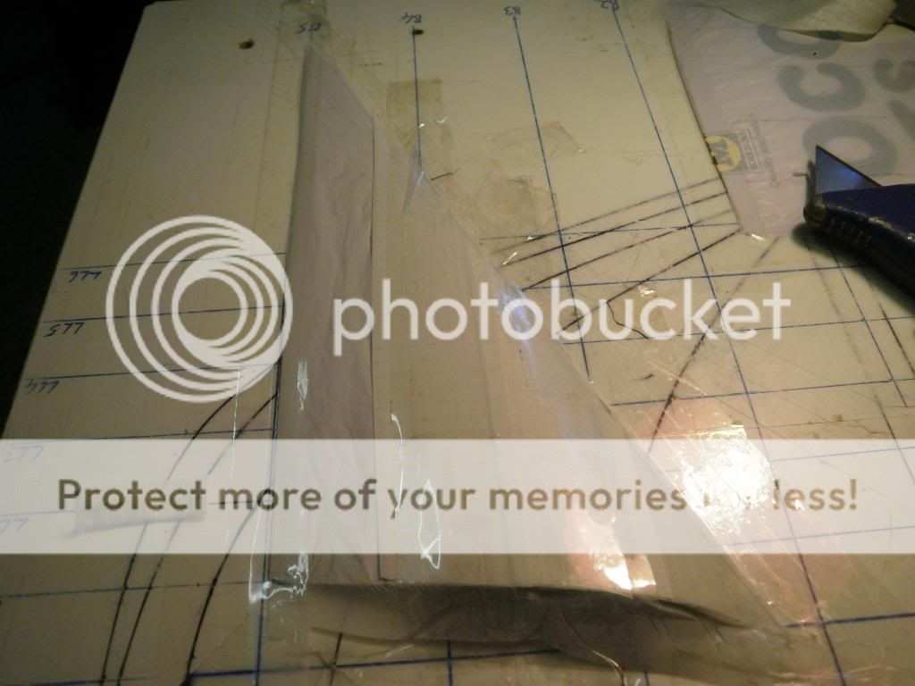

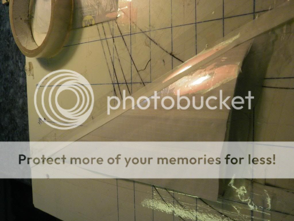

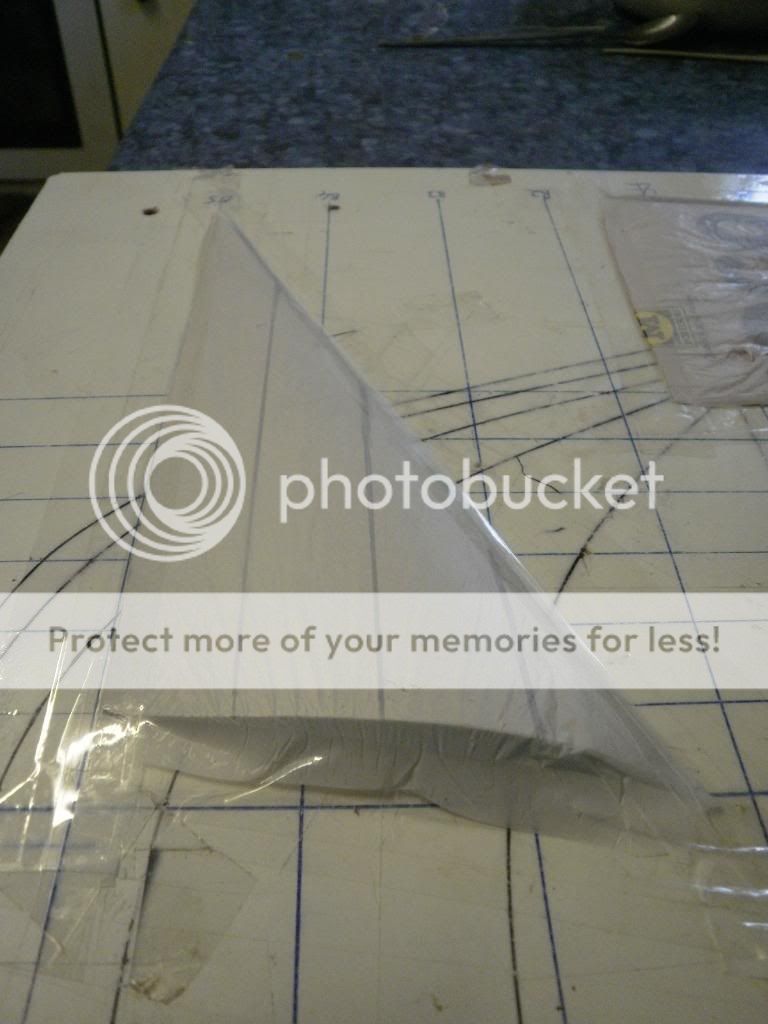

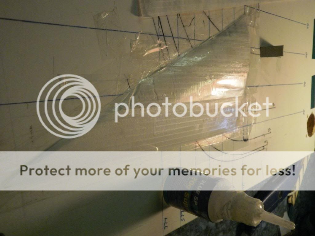

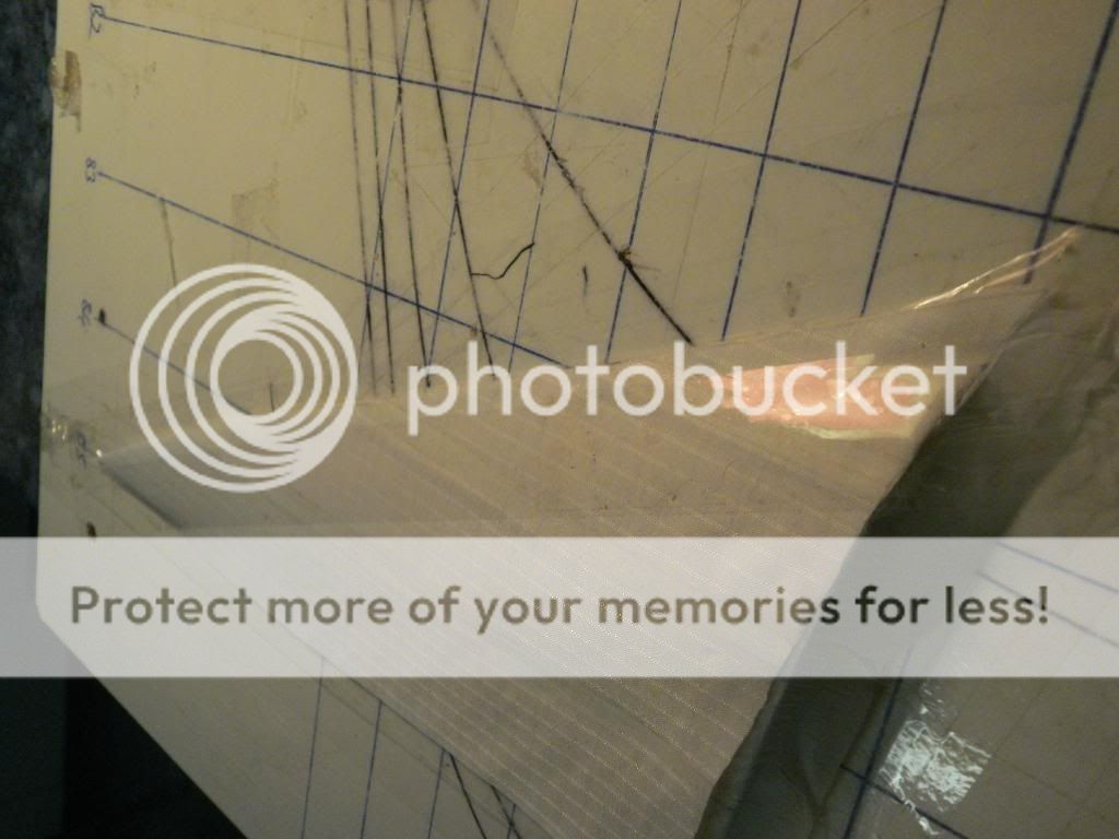

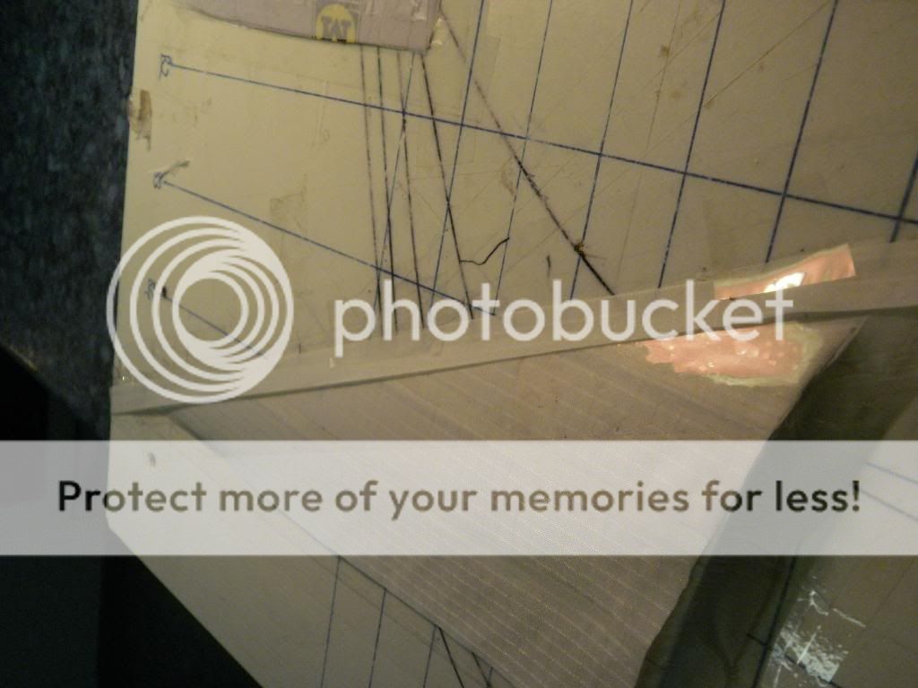

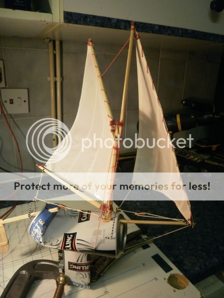

Here I will go through making the jib with my new method blow by blow :-))

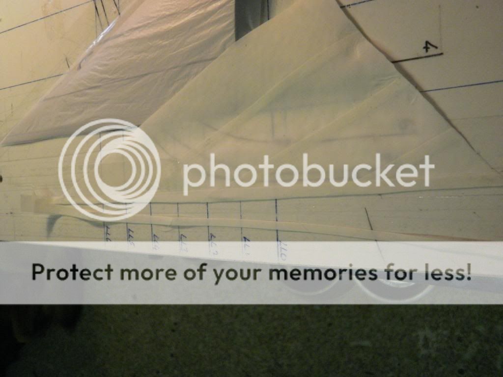

1st make the cardboard form, this time I've use cardboard ribs cut the match the shape Ive molded into the jib form. I fromed the shape in the jib by molding the cardboard in my fingers until I got an airfoil I was happy with and the cut the strengthening ribs to match.
It's rather like building a model air craft wing but in reverse order!  {-) Mark the sail panel seams on the form and cover it with a piece of polythene shopping bang and tape down smooth.
Cut your sail panels so that the weft of the cloth runs top to bottom of the resultant sail, this stretches less than the warp so in my book is better and hopefully we'll get that nice belly in the sail panels between the seams  O0
Start at the tack and lay your first panel, taping it down so that just the seam is exposed.
Tip! When laying down the tape make sure it is smooth with no wrinkles as this causes the cloth to pucker underneath and is to be avoided if possible.
Work across the sail heading for the clew smoothing down each panel so that it follows the curve of the form and lightly with a pencil draw the true shape of the panel as dictated by the form.
Cut out with sharp scissors and tape down the panel as before.

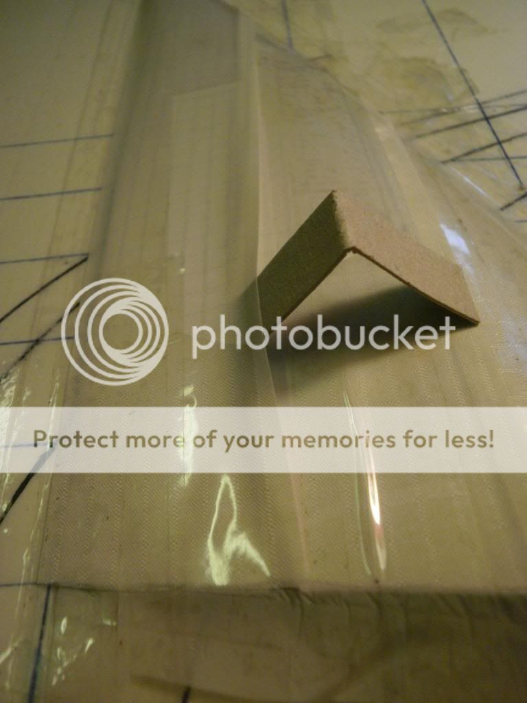

Its gluing time! :o Ive made a little cardboard doobly-flip to hold open the seams until I can get the superglue nozzle right in there.....
Run glue along the seam and follow immediately with finger so glue soaks through cloth and sets  O0
Remove panel from form
Tape down luff of sail on form  . . . .
and cut cloth strip to fit one side . . . .
and tape it down over waste only which is to be trimmed later . . .
and glue as before
remove sail from form and flip over . . .
and glue luff strip on as before . . .
and trim off waste with a sharp knife
tape foot of sail to form again and rinse repeat  {-) :-))
Do same for leech.
Cut and glue on corner patches to one side of sail.

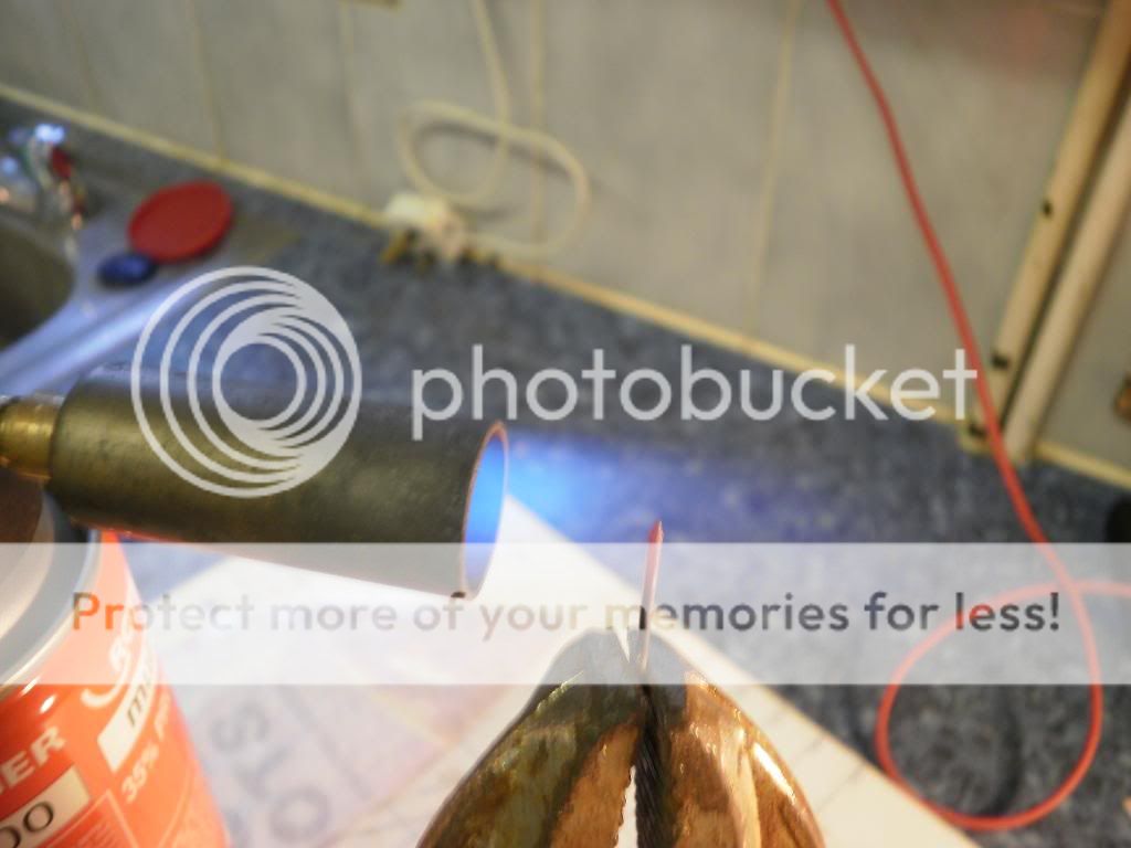

To make instant cringles, mark their location along the desired edge of sail making them evenly spaced . . .
Take one blow torch and grasp panel pin firmly in jaws of molegrips and heat nail in flame until incandescent  :-))
and plunge through sail at cringle position.
Rinse repeat for all cringles  :-))
Only do one cringle per heating session and don't pause too long in cringle hole or you'll burn the sail, its a quick in out motion :o :embarrassed:
Job done  :} :-))

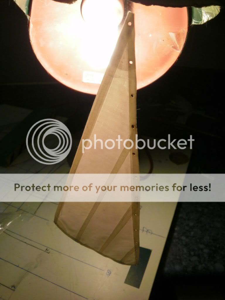

I think there may be some merit to building a light box with a white perspex top and a bunch of fluorescent tubes inside . . . . and making the sail form from clear plasticard.
I'm having trouble making the sail seams neat and even which is bugging me and this is because I can't see them clearly while laying down the panels.  >>:-(
 <*<  The light box would cure this.  O0 :-))
But this little forsail only has a 10" luff so maybe I'm nit-picking !  {-)
Time to bend on sails and go sailing! :D :-))

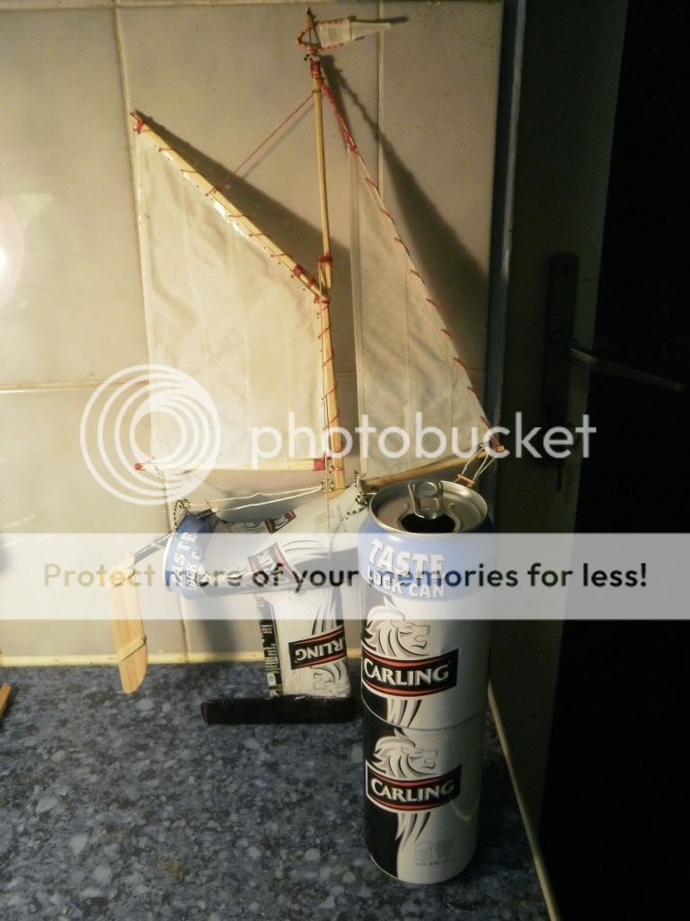

Would you believe it took longer to bend on the sails than it took to make both sails and write up my last post!  :o
I ran out of daylight before setting the sails and sailing by moonlight is no fun at all unless you have a beau to cuddle as well - sadly I'm laking in this department so you'll have to settle for the model clamped to my unit top and being blasted . . . . . . .
Wind 45 degrees off the starboard bow!  :} note set of the sails fully hardened home  :-))
Now we're swinging around her bow . . . . .
and she's crossing our bows on the port side . . .
And she's showing us her port side with the sails straining at the stiff breeze! {-)
The things I go through to entertain you lot!  :o and the lengths I go to to get the shots
 <*< <*< {-) {-) {-) O0 {-) {-)
Same again on a beam reach
You can see the airfoil shape I've built into the sail along the foot of the mainsail when compared to the boom  :-))
I'm no expert but the sails seem to set well to me! Its the best set of sails I've ever seen a beer can wearing! {-) O0
You watch it'll be either no wind at all or it'll be blowing a gale and raining next time I want a sail!  :((

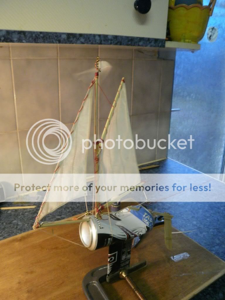

Tini-Titanic Mk III is ballasted and ready to rumble
The ballast again is a strip of lead flashing - 55 grams to be precise, all up weight of boat 133 grams.
Glues used Blue Spot 20 Gram superglue £1.00 from Boyes used on rigging, gluing the foresail horse to the hull and of course making the sails  :-))
I switched from JB Weld for the fin keel and ballast because it's a tad expensive and switched to 151 two part epoxy £1.49 bought at the cheapy shop.
The only thing to watch with the epoxy is the areas to be glued must be abraded with really coarse glass paper to form a good key.
If Dad or Grandad is helping with the build these glues are okay but if the young ones want to tackle this themselves I would go for something like Bostick or Evo Stick just as I used as a kid  O0
Two bowsies are used to lengthen and shorten the sheets as they used to in the good ole days and are made from the side of a plastic Jacobs Crackers Selection box, the horse and all the other fittings are made from brightly striped paper clips robbed from my daughters college pencil case! (don't tell her she'll kill me! :o  ;) )
Sheets and standing rigging are the centre cords of parachute cord given to me by my brother who used to be in the RAF and the hanks holding the mainsail to its mast boom and gaff and also the foresail to the forestay are the strands pulled from the outer casing of same parachute cord.
The hull and the fin are of course our two trusty beer cans.
The lead ballast is encapsulated in epoxy resin cast in a makeshift box built out of card board around the fin and lead which was epoxied to the bottom of the fin first. The resulting 'bulb' was then sanded to smooth the flow of water over its surface  - hydrodynamic?
Sum cost for the whole project £2.49 in exchange for a whole bundle of fun  :-)
Here's some close-up-and-ugly shots of all the important bits
Base of mast showing gooseneck and eye for mainsail sheet. The bowsprit comes through bow and forecastle, a panel pin is set in the top face and the mast sits on the sharp end.
Forward face of mast showing cleats for main halyards and peak halyards, horse and foresail traveller.
Here is the mainsheet horse detail and rudder stock and mainsheet bowsie in back ground.

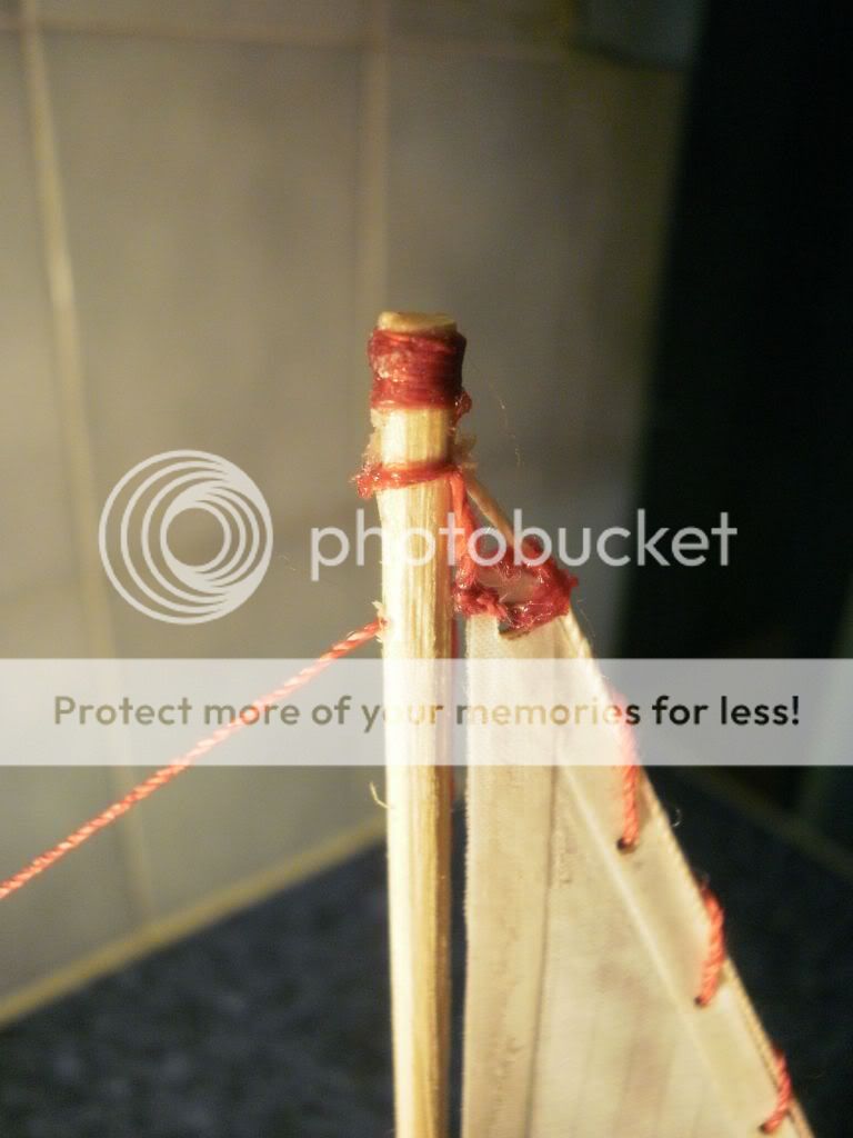

Top of mainmast showing shrouds, heel of topmast and gaff jaws with main halyards passing through mast to hoist gaff jaws.
top mast truck, top of forestay and head of foresail, also the peak halyard passing through mast to peak of gaff.
Bowsprit, tack of foresail, top of bobstay, eye for foresail sheet and lacing of foresail to forestay.
Continuing the keeping it simple theme here is the base of the starboard shroud and the base of the bobstay which are bonded straight to the hull surface with superglue. The leading edge of the fin can also be seen.
And last but no means least the epoxy encapsulated lead ballast  :-))

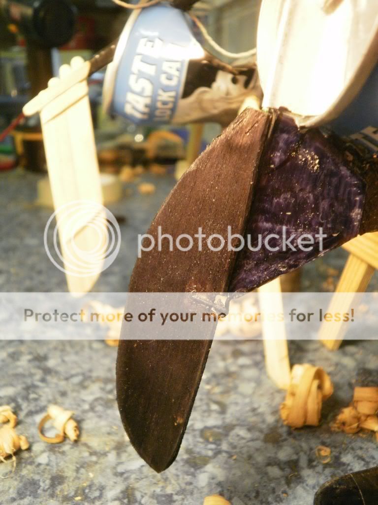

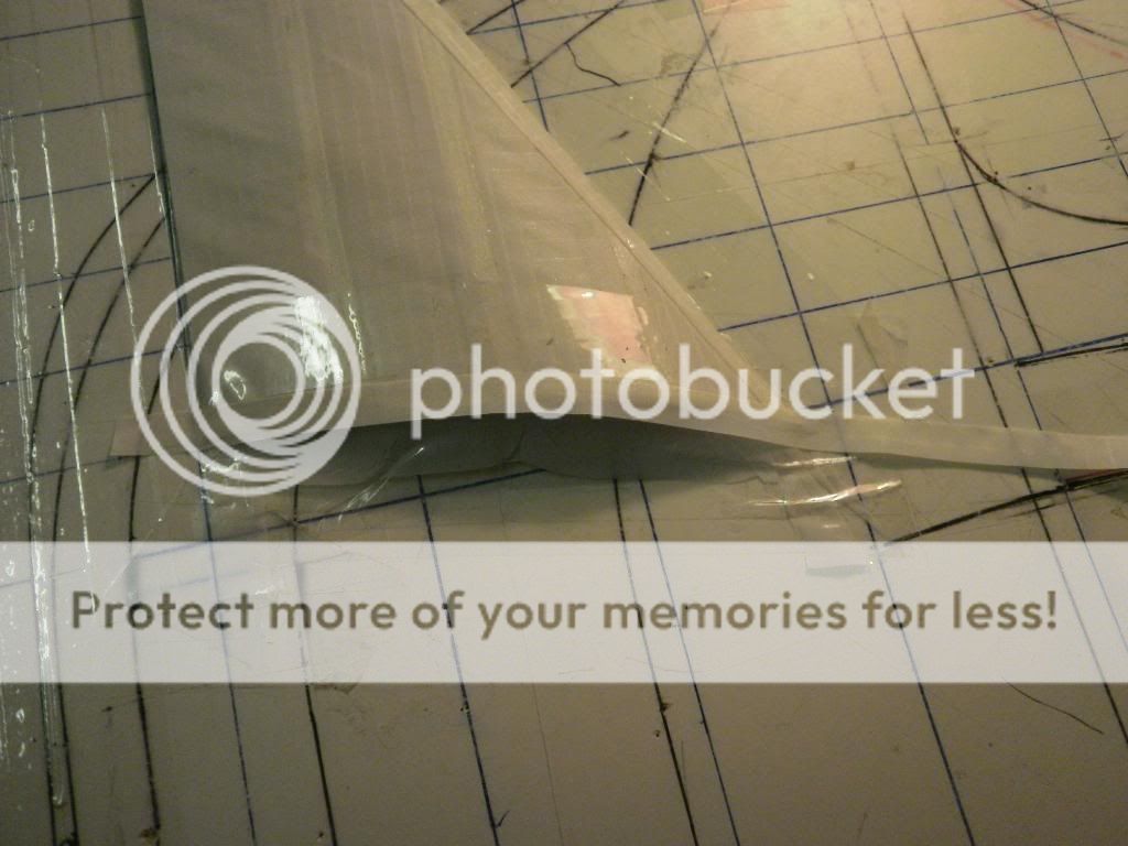

Also I forgot to show how I got that neat tapered airfoil fin keel . . . instructions to follow soon.
Done the photos, just got to write it up . . . .
But I'm too busy sailing at the moment! O0 ;D
Greggy1964
Re: A Nostalgic look back at Beer Can Sailing Ships
« Reply #33 on: February 25, 2011, 01:18:28 pm »
But here's a teaser to keep you on the edge of your seat! :-))

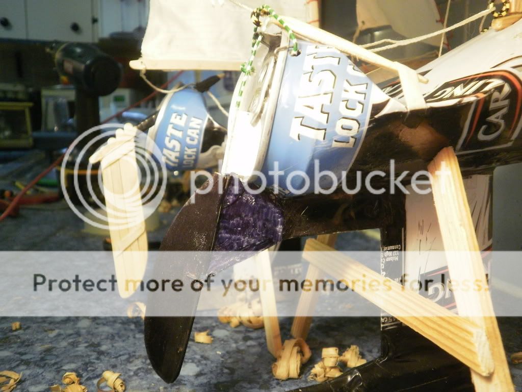

The ring pull on Tini-Titanic's stern is a great way of forming the lower gudgeon for hanging the rudder and for all intents and purposes works just fine . . . . .
But when you've become the veteran of some sixty voyages across the pond, like everything else in life - things inevitably fade . . . . {:-{
And our poor ringpull gudgeon is no exception.  >>:-(
You see it was only ever designed to be used just once to pop open the can so the owner could chugg the beer {-) and it's tiny little tab holding it to the can  . . will only cope with rudder adjustments (to get the ship to sail a straight course) so many times . . . .
And it always goes 'ping'  halfway through another voyage allowing the rudder gently slip its hold and becomes another trinket in Davey Jones's locker!  >:-o >>:-(
But as with every dark cloud, there lurks a silver lining because this conundrum forced me to improve things. We now have a proper rudder with a tiller to steer it by! :} and everything!

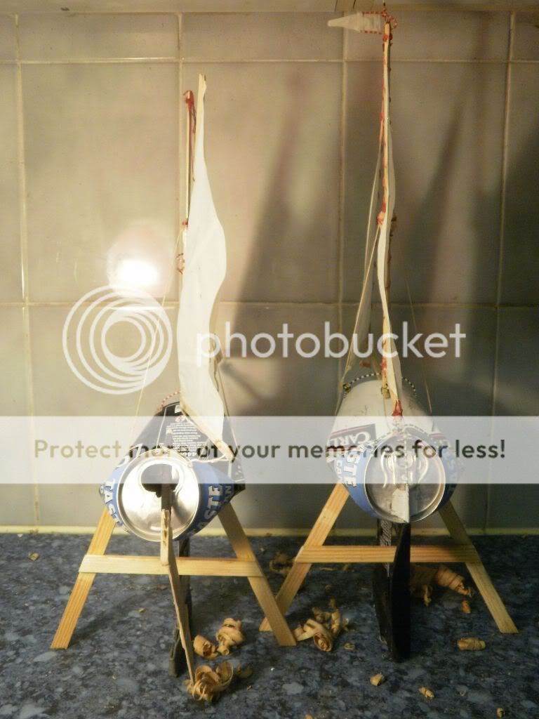

Here is a photo of Mk III in the boat yard along side Mk II,
She has suffered the same ring pull fate and is awaiting refit.
Mk III has been fitted with the rudder upgrade which consists of three gudgeon's, one at the deck, and one at the water line  . . . .
And one at the bottom of her new improved skeg  :-)) The gudgeon this time is on the rudder and the pintle is a projection of the lower end of the skeg (another bit of paper clip sandwiched between the two halves of the skeg.
The rudder is smaller than on Mk II but is compensated for by the skeg between the fin and rudder to try and reduce leeway  O0
And a tiller gives us rudder control.
The rudder blade is two sheets of 1mm birch ply, the rudder stock is our trusty gaudy paperclip which is formed at its lower end into a sort of 'e' shape and sandwiched between the two rudder blade halves. The top part fits into a tiny hole bored for it in the tail end of the tiller.
Tiller control for now anyway (there hangs another tale) takes the form of a straight forward strip of rubber tape glued to the gunwales and spanning the deck.
This traps forward end of the tiller underneath it.
This simple arrangement allows for micro adjustment of the rudder :-))
And we can go sailing again . . . . .
Well  . . . . . . .
 >>:-( when the north wind stops blowing icicles horizontally that is   >>:-( . . .  {-) {:-{
The oak shavings on the boatyard floor give a clue to upcomming events at the other end of the yard . . . .
More planking is taking place on Master Hand :-))

Here are a couple of stills from the last voyage  :-)
dreadnought72
  • Posts: 1,892
  • Location: Airdrie, Scotland
« Reply #40 on: March 01, 2011, 12:03:31 pm »
Crikey! I do believe she's making headway!  :o
...Not bad for a tin can.  :-))
Andy
Greggy1964
« Reply #41 on: March 01, 2011, 01:45:22 pm »
Hi Andy
Yup! :-)) She's going uphill O0
You can see this clearly in my last YouTube vid
In fact your idea of a burgee was is what made me decide to try and get her to sail upwind  O0
So I have you to blame! {-)
This afternoon I'm planning on sailing again to try out the new rudder/skeg configuration.
On Sunday I was chatting at the pond side with member of the local model boat club who was initially surprised to see a beer can sailing by :o  but his remarks, and those of passers by were encouragingly positive.
There's more to this lark that just sinking beer! {-)
