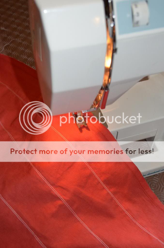

I've started sailmaking  :o   Probably not very well but, hey ho!
I'm using straightforward cotton sheeting and cotton thread.  The fabric's been dyed what look a reasonable colour and I've started sowing false seams onto the mainsail.  My reading tells me that traditional English sail panels were 24" wide.  At my scale, and allowing for seams, that's as close to 60mm as makes no difference.  So, 60mm they are.
For once, the sewing machine's cooperating.  It's not the best stitching but I'm pleased enough for a first attempt.  Yes, I know that  the stitching should also be coloured. Tough!  Anyway, it looks rather smart like this.
Next, I'm working on the hems at the edges.  I've allowed for a 4mm hem - far too big for scale but realistically achievable.  I've found that I can press an edge in against my long metal ruler using the iron.  It makes the hemming slightly less fiddly.  Then I've sown and overlocked the hems....well hem.  I've only done one so far.
I had to make the sails at this point as I need to fettle all the rigging and tackle and I need something to hold all of that in place  O0
