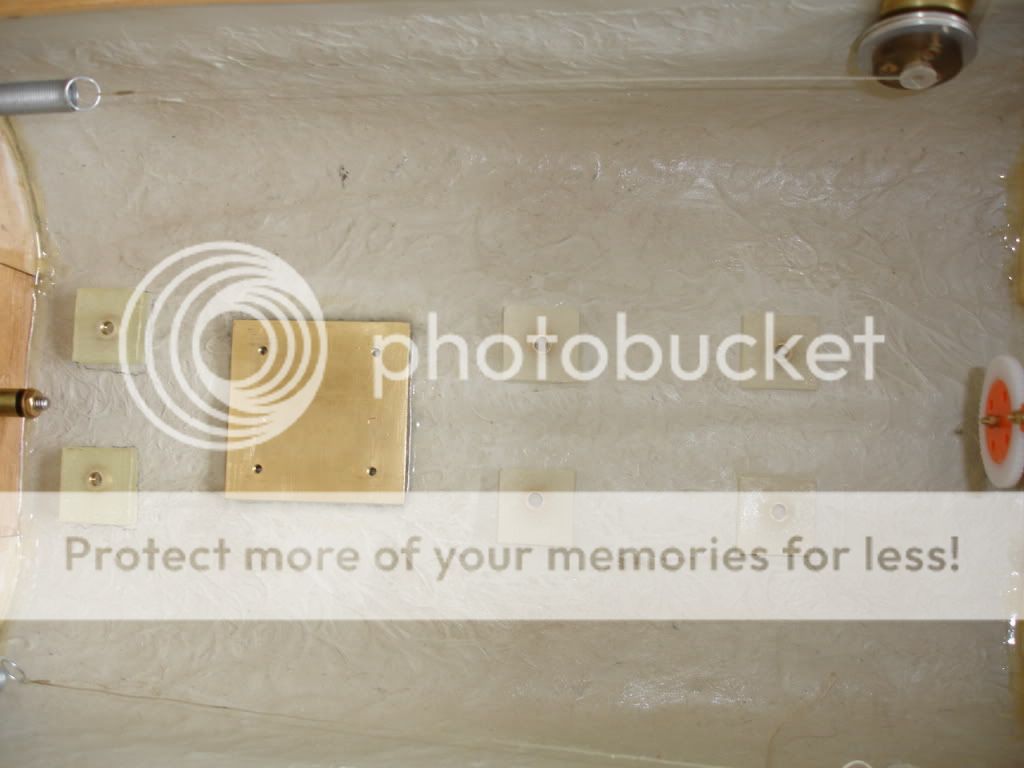

This particular mouse planned to mount pieces of Lead in his Puffer build. He wanted them to be removeable because he didn't know currently how much ballast would be required ultimately (and everything he had ever fixed permanently, he had always had to unfix at some stage).
He spent an age mounting 2BA nuts and blocking them in with epoxy.
The first four were successful but the last two came adrift when removing the plastic shuttering. He thought "Oh bother!" (or something very similar).
In his own words:
In each case the area was de-greased with methylated spirit. The rear nuts were blocked in with freshly purchased Devcon 2 Ton (which is a slightly different colour from that used to secure all six nuts and the for'ard four blocks.
If I start again, I will have no confidence in the bond being able to support two 230g pieces of Lead. So ...
The current plan is to fix the detached blocks in place with Cyano. This should give a good bond but will not be easy - I have just realized that the current bout of "man-flu" is due to my becoming sensitized to the stuff! (Apparently this can happen to 5% of the population and I've just made the connection to a series of "colds" last March.)
Any comments, most welcome - but don't feel under any obligation!

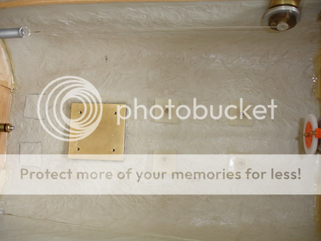

Corposant ...I have little experience with fiber glass work....but the third photograph suggests that very little bonding to the hull [is any] has taken place with the AFT pair of square nuts
 %).....so a few thoughts for consideration  O0
1. Coarsely abrade the hull pad areas & also the underside of the square nuts
2. Devcon adhesives are industrial class...so by ensuring you follow the material compatibility & installation instructions all should be OK
3. A simple plastistrut square frames say 3 mm x 3 mm larger than the square nuts would serve as a casting frame & so provide a deeper bed for the expoxy
4. After curing I am sure you would find greatly improved bond strength & so gently prise the balance four square nuts loose & repeat the alternate bonding process
5. I have little faith in cyano adhesives for such work
Similar epoxy bonding is also used full scale vessel engine room construction as an extension of the older traditional bolted joint work......good luck......Derek  :-))

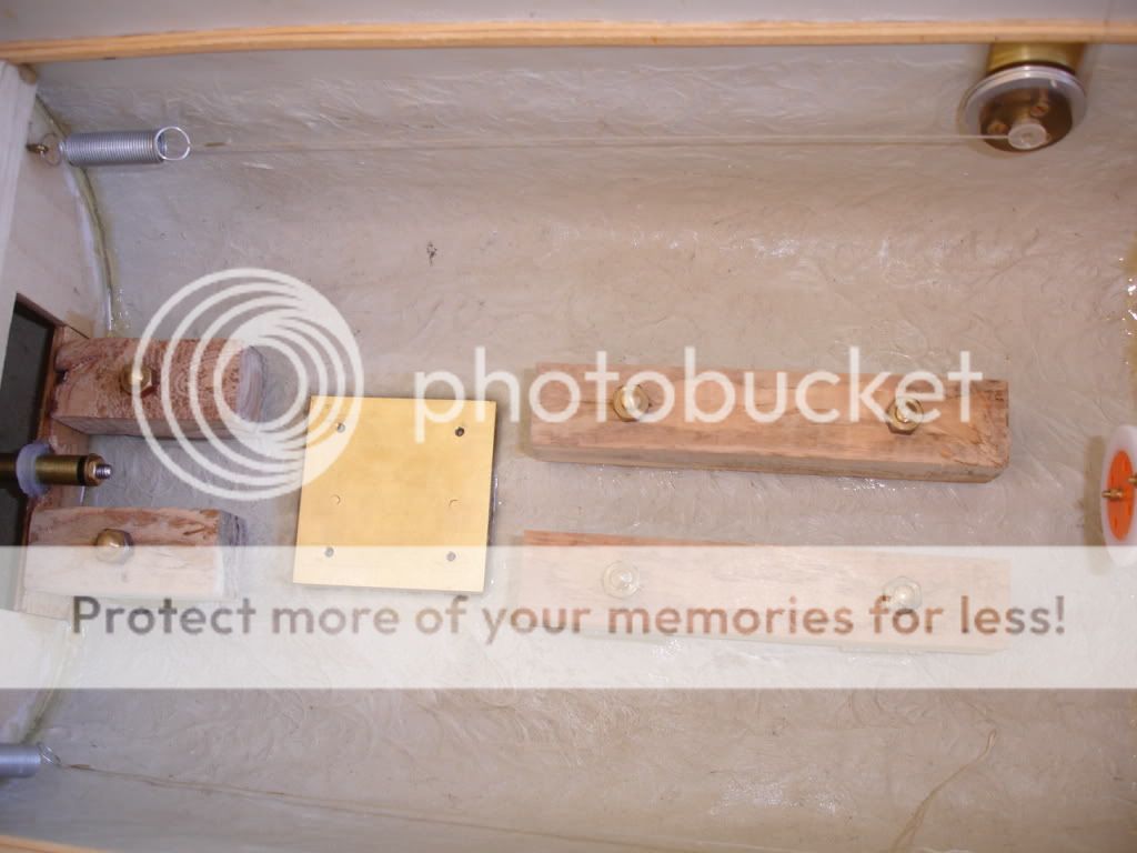

My original intention was to surround them with beds the same shape as the pieces of Lead - 2 off 115mm long x 20mm wide and 2 off 50mm long x 20mm wide
(as shown by the pieces of wood in the picture):
This idea was abandoned in favour of 20mm square pads when I realized how much very expensive Devcon this would take! (If need be, I will fill in the gaps with something else - probably Silicone.)
