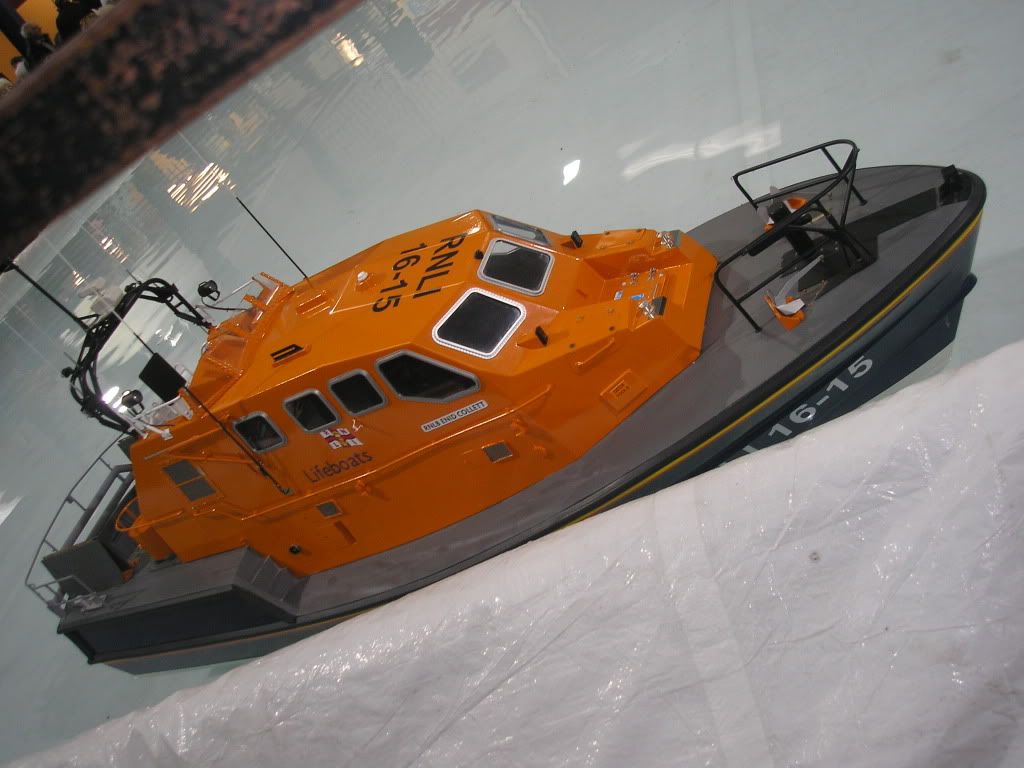

Just a few shots of my Tamar wheel house as of today,  still lots more to do.
Phil.

Lovely work Phil. I miss your old website too.
What did you stick your rubber moulding to the hull with? Did you remove hull paint to enable it to stick to bare GRP?
Chris
Spook
Re: Shoreham Harbour Lifeboat 16-15
« Reply #3 on: July 06, 2011, 12:19:04 pm »
WOW! Very nice. What scale is that?
(I'm currently building a 1/16 Trent and I propose to stick on the rubber fendering after varnishing, using UHU or Evo-Stick)
Chris
Chris,
 yes I ruffed sanded the hull where the rubber was going then used super glue, but do it with the hull up side down if you get any run's with the glue it will go to the deck, and not all down the side, start at the bow and work to the stern.
Phil
Spook its 1/12th
Phil

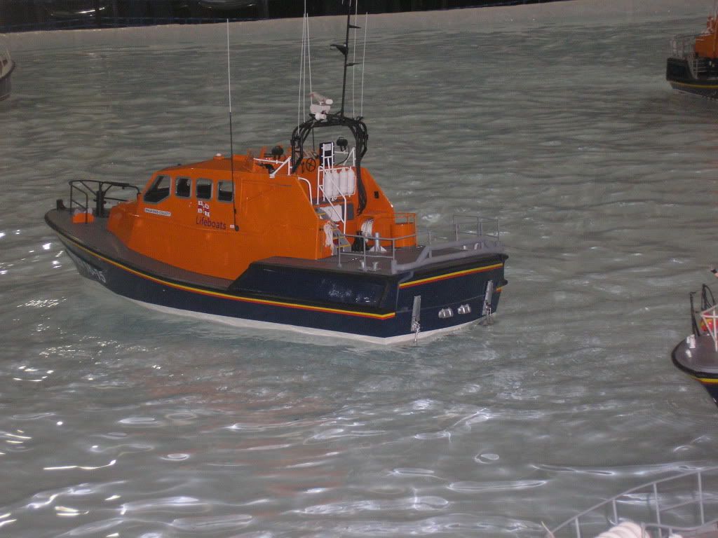

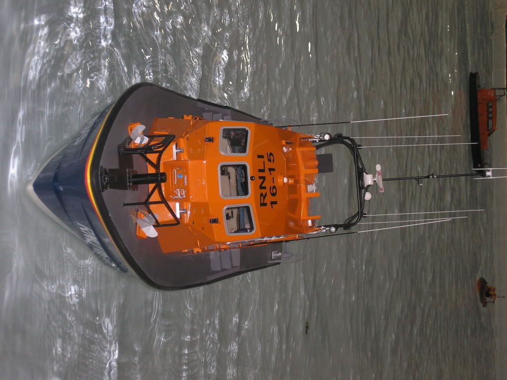

« Reply #7 on: November 12, 2011, 10:40:29 pm »
a few shots i took of her in action taday Phil
she looks great :-))
sorry the photos arnt that great, i have a small point and press camera built for idiots %)
stubbsy :-)
Kangaroo1
« Reply #8 on: November 12, 2011, 10:43:25 pm »
Stubbsy, the photo's are fine mate. And the model looks great!
stubbsy
« Reply #9 on: November 12, 2011, 10:51:52 pm »
phil tamar has the most awsome throttle response, he let me hold the controls for a couple of minutes whilst he was busy with the lifeboat display, i felt like a kid who had been left with the car keys :o  its an awsome model as are all the models from speedline and been built to a very high standard by Phil.
if my severn ends up being half as good as phils i will be very happy ok2
stubbsy :-)
