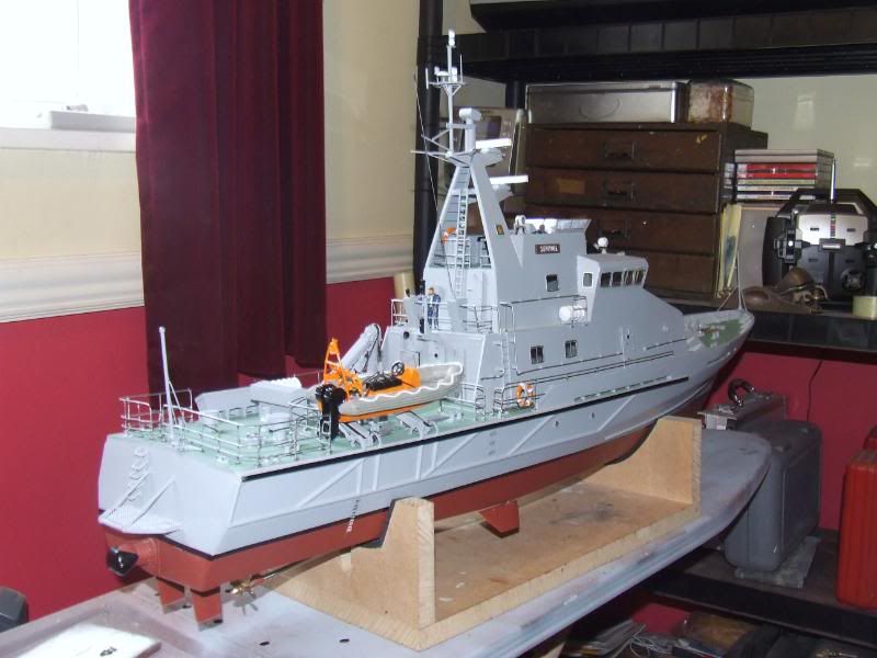

« Reply #1 on: September 04, 2011, 10:36:50 am »
Hope these help

« Reply #3 on: September 05, 2011, 02:46:32 am »
A brilliant piece of modeling & simple too. Mick B.

« Reply #4 on: September 05, 2011, 08:58:35 am »
It may be due to the picture angle, but the stabilizers look too vertical to me, all the full sized ones I have seen look to be at about 45 Deg.
Nick
Re: rc boat stabilizers
« Reply #5 on: September 05, 2011, 10:01:02 am »
Nick
If you look carefully at the first photo you will see the stabilizers are on the angle.

« Reply #7 on: September 06, 2011, 03:44:12 pm »
Nice build, Dicky  :-))
