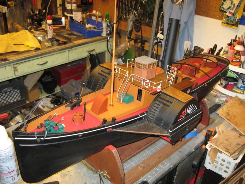

John suggested a great idea!!--On paddle ducks they have amassed many free plans for members to access-The plans for the  paddle tug Strongbow can be scaled up or down and would be a nice idea
I have joined there a while back as I am completing a live steam paddle tug..she is about 4 feet in length and 18" across the sponsons--So I am in love with paddle tugs!!
You can need a lot of space- the open area inside the combing for engine room is 20" long
Good luck with your build - hope we see you on PD's :-))
Good Steaming
Mo

 :embarrassed: ....& Mo says..... "I have joined there a while back as I am completing a live steam paddle tug"
 >:-o...we PD's haven't seen the sea trials photos or video yet ..... %)  ........
PS...but we do understand his comment..... "I am in love with paddle tugs!!"  :kiss: :kiss: :kiss: .......Derek

« Reply #8 on: April 15, 2012, 04:10:30 am »
Derek  is always there to keep me on track........Power plant tests start in two weeks-- &^%*&^&*^#@@+!! job is keeping me out of the shop...I am so close I can taste the pond water :o
Luckily the operative word is "completing" a PT...... with wonderful help from members like Derek!!
Paddlin' soon to a youtube video near you  :-))
Hope we see you on PD's working on your tug!!
