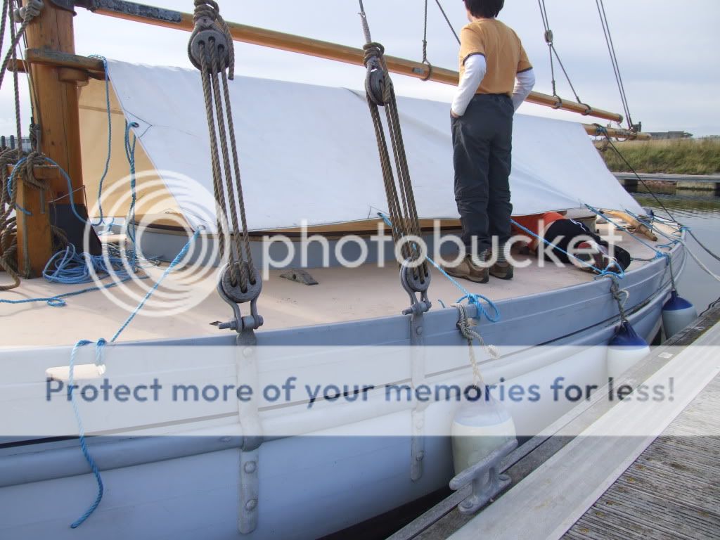

I intend to have the closed loops below the foredeck running around pulleys.  The sheets will be taken off these and then directed through the decking using pipe of some sort.  The real boat has oak fairleads on the deck and I'm going to try to bring my copper fairleads up underneath one of these.  With a bit of false sheet running aft from the same place, I'm hoping to make the exits as close to invisible as possible. You can see one here between the dead-eyes....I might have to make them a little oversized to get the desired effect.
All the advice on line types is gratefully received, thank you again.
