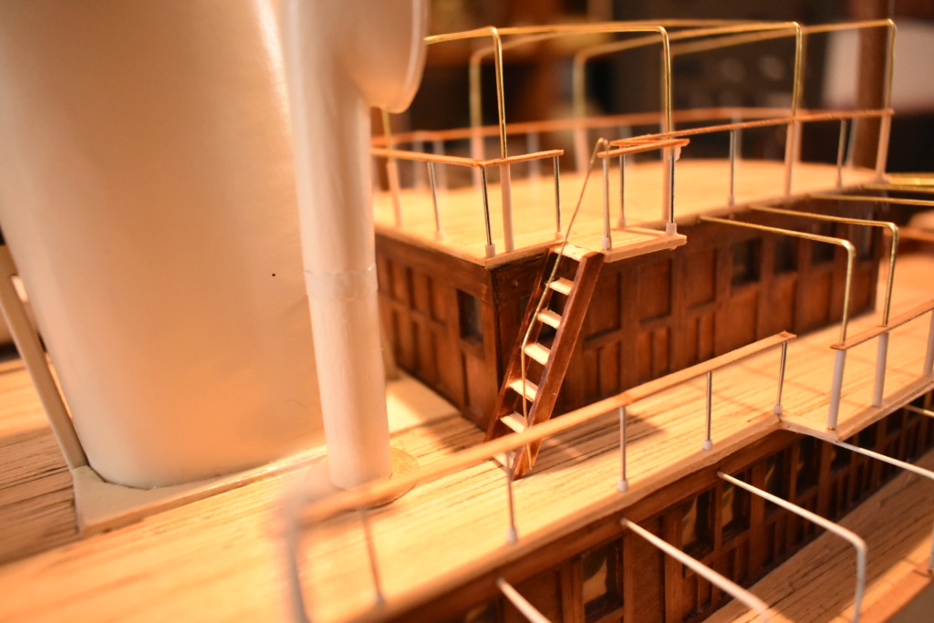

Hello everyone,
During first trial, model speed was to high, not adapted for that scale, everyone agreed on that, also idle speed was difficult to hold...so I have replaced the 50mm Dia. propeller by a 40mm. It defenitly helped to get a lower speed, and increased the range of speed, even if the maximum speed is still too high. The idea of replacing the 40mm by a 30mm is tempting.
The last details added are mainly the upper deck railing. Also I've made the three masts shrouds. The main masts shrouds need to be removable so I've used magnets.
I've aslo reduced the heights of front air collectors:
Gilles
Borkum, Youpi 190, SY Medea, SY Aphrodite

« Reply #8 on: June 08, 2019, 10:23:10 am »
Hello,
finally, those rails were not the most difficult details to build:
More pictures to come
Gilles
