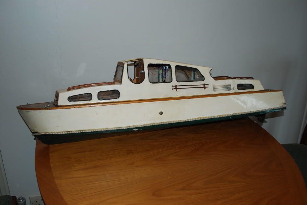

An 11" draught for a 41" model is a lot.
Any chance of a picture?
Nordlys
  • Posts: 868
  • Location: South East
Re: Electric motor equivelant
« Reply #5 on: May 15, 2012, 09:48:36 am »
[IMG]http://i1182.photobucket.com/albums/x460/SeaScout1/SiriusStar12-1-12001.jpg[/IMG]
I think I should have stated the size 11" as WIDTH and not draft.
I'm not into brushless yet as it requires investment in batteries and chargers
and I have only just got kitted out with conventional equip.
Nordlys...

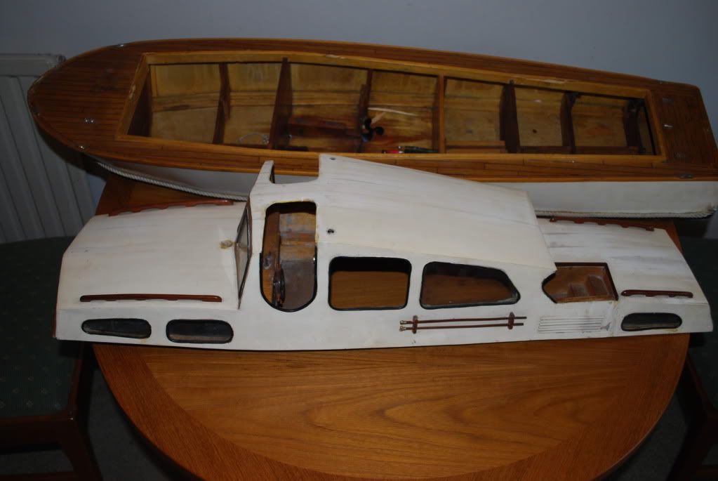

« Reply #6 on: May 15, 2012, 09:50:52 am »
2nd picture did not upload
This should work......?
