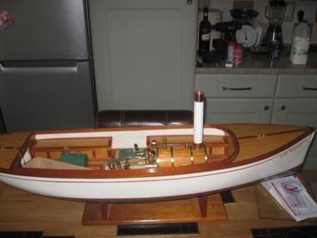

The question is now, will the gas tank benefit from being fitted for'd of ther boiler, will it absorb a little radiated heat from the boiler to help stop any cooling pressure drops
or here amidships where there is a shorter run of gas pipe
I am not struggling on displacement so it can go for'd if it would benefit the gas supply.

Lots of views on this subject, but if it were me, I would mount it in front of the boiler and arrange some sort of heat transfer device that is in direct contact with both the boiler and the gas tank; something like a bit of copper sheet suitably shaped.
It's all looking very nice and that engine is a gem.

Just a question Andy- any reason why you have the burner back near the engine  as opposed reversed with it afore the boiler?

I was just thinking the same, that the boat might look more balanced with the funnel back closer to the engine, the gas tank would then be right next to the burner (if you put it forward) and although the steam line to the engine would be longer it would be easy to run it in to the funnel to have a superheater loop which there has been lots of discussion about lately. Cheers, Ian.

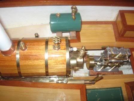

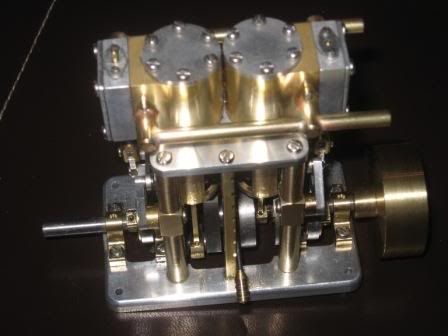

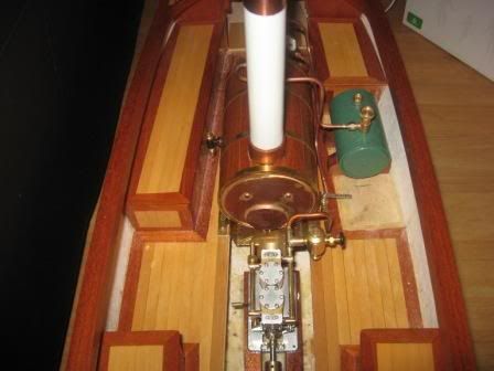

Well got the TRV1A running and fitted, had to revamp the layout abit so here is the progress todate, the starboard for'd bench seat has been shortened, to make room for the gas tank, still deciding whether to even things up and shorten the port side as well.
Have turned the boiler around so the funnel is more amidships, as previously sugested, this has balanced the boat up nicely, and made the blow off valve easier to get at. Have not run the steam pipe through the stack yet, got to decide on that one, Graham industries recomend not superheating, I know just a pipe through may not exactly superheat, so may improve this later. Will see how it goes for now.
Have bought some 2 1/2inch pipe to fabricate a condenser/oil separator out of, that will go on the port side.
Navigational Aids vessel Master. Old Conway 70-72

I would imagine that GI advise not to superheat because of the abundance of aluminium in it's design- however a single pass through will help marginally with condensate issues, and will not heat more than a few degrees above boiler temperature.

Any one any ideas on prop size with a TRV1A, could fit a 2 1/4 inch no problem, at present I have a 50mm 4 blade, but its a kort nozzle prop, and I only fitted it as a temporary measure. I want to go as big as possible so as to run the engine slower and save steam, but don't want to overpower the engine. Could possibly get a 2 1/2 inch to fit.  Will stick to 3 blade for the proper propellor. The boat weighs about 6kg.

You want the engine to be slow revving, that's fine- however with the small pressures these engines run on you need to keep some decent rev's to have any recognisable power- I would say 75mm/3" at most.

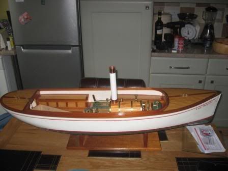

The hull was started by a friend and then sat in a cupboard unfinished for many years. It was a Model Boats mag design from (I think) the 1980's called Ritalea which was meant to be electric but the Gage single and the 6 x 3 boiler fitted easily. I just modified the front deck and shortened the front cockpit so I could hide the disposable gas cylinder. I will try and post a picture of her under construction but I do not seem to have much luck posting pictures on here, no doubt down to my ignorance when it comes to uploading. Ian.

Hopefully this time two photos will be attached, one during construction showing the positioning of the boiler, engine and gas cylinder and one after the hull was finished. Cheers, Ian.

Nice Ian--Glad to see that you worked out the photo posting...I still have issues over on RC groups -I just can't get my photos to appear like others over there.
Very nice deck -- !!
