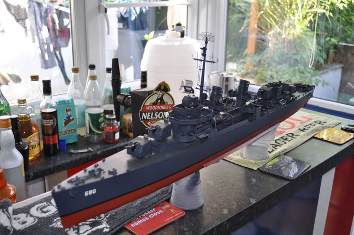

As there seems to of been a problem with the site I best repost the missing pics
Peejay thank you very much for you kind words about my model I agree with you some people have unjustly slated this kit and for get the essence of modelling "enjoy yourself" I personnelly think theres nothing wrong with linberg hull its the deck that needed things moving.
it looks me like its a canvas cover over the forward torpedo controls peejay
well this first set of pics are of her just before varnishing you'll notice dark areas behind the decals this just gloss varnish which for somereason provides a better surface for decal to stick to. I also repainted the gun boats black and the whaler awnings deck grey looks better than the green

« Reply #183 on: October 18, 2012, 09:54:06 pm »
with painting complete and allowed to dry fully I varnished the entire ship with 3 cans of hunbrol 135 spray satin varnish
glendavis1971
  • Posts: 148
  • Location: Gosport, Hampshire ENGLAND
Re: USS Melvin Lindberg Kit R/C Conversion
« Reply #184 on: October 18, 2012, 10:03:45 pm »
the next stage was to fill the shaft tubes with grease and refit the shafts and props. Filled up the bath up. fitted the battery and popped in, she appears to be stable and handled a simulated swell very well. holding the bow gently slowly powered up to full ahead then full astern and back to full head this time putting in port and starboard rudder everything appears to be working well. I left her in the bath for well over an hour no water appeared to of seeped in.
Tomorrow she is going for sea trails once i'm happy with her sail qualities I'll add the finishing touches railing netting crew etc
