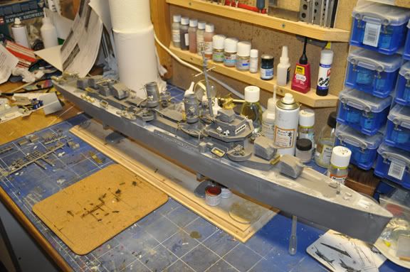

Hi guys
Been nearly a week since i last posted progress has been slow but worth the efforts.
 :-)) Harquebus I agree was worth the effort in the end and has massively improved the visual look of her. Insanity can never be my goal I got there years ago. I do think your right with the revel fletcher no problem. If it was me I'd go for a single screw and rudder. plenty of space to squeeze everything in I'd even consider lipo battery pack due to size and weight.
Keep the faith biker all good things come to those who wait they say.
 <*< thanks Charles I no master modeller just guy that loves to build models and your right practice does make perfect, But I'd also say taking your time and lots of patients are the biggest factors.
Well guys over the last week I have been work hard on the brass details. All the 20mm and 40mm have been converted at first i thought the oerlikons were to tall but after surfer 100's of pics of Fletcher's it was obvious these guns are tall. I made the depth charge rails and K gun reload racks but they lacked depth charges so either use the kit ones or make new ones. after a rumage through my odds box I found a length of 4mm brass tube and 3.2 plastic rod that fitted snuggly into the tube. I cut the tube to the same width as the internal width of the rack smoothed everything up and cut the rod to 1/2mm small than the tube width and fixed slightly recesses either end. I made 5 glued them to a strip of plastic and made a silicon mould and reproduced 40 depth charges a few spare to account for bad casts. I glue 9 to strips of 0.25 mm plastic cut to the rack width and carefully glued 3 per K gun reloader and sliding the brass shelfs in. The radars are made as per the brass instruction sheet and directly replace the clunky plastic ones. Also the yard fittings replaced the plastic ones I had make 1 aerial from 0.5mm brass wire. I have finished the funnels by fitting the the steam pipes and making the supports for the HF antennae I also made a ensign staff thats mounted on the rear funnel. Everything Is coming together slowly just a few more details to finish then its painting and the home straight.
Lots of pics this week enjoy guys feel free ask questions

Hope you all like and find this helpful with your models

« Reply #58 on: August 15, 2012, 11:05:56 am »
This is impressive work and a fine photo essay showing how the photo etch (PE) set really looks. Believe me, I have scoured the net for any and all builds of this age-old kit and have found nothing showing how the assembled PE is supposed to look and before paint is added as well. I have the kit and Tom's Modelworks PE set set aside for a later build and can only participate vicariously through your efforts. I thank you for the superb photography and the service you are providing to those of us who have not yet taken the plunge. Do you recall the size of the Prop Shop props you used?

Hi Guys
I hope so Alan. Theres only once choice to paint Melvin Measure 21 as she spent the entire war in this scheme of all over navy blue
Thanks Harquebus I had a look at those parts they look OK to me. Yes I intend the fit bilge keels as they will aid stability on the water.  I spent hours looking for UK dealer but sadly there is none.
Will look forward to seeing your efforts Charles
Today I finished the brass work. You'll notice the gunsights on the bofors now have shrouds fitted. Took me age to work out where those part went like said before the instructions are very vague in parts. The Carly floats are simply remove the bottom and replace, I also made a mould for the next model. The forward float racks have to be fixed to the forward superstructure and while i tend avoid soldering where possible as its not my strong point it seem the only way to strongly fix 0.5 brass wire to act as a strengthener and fixing for rack. the rear rack is I used the wire as a peg to in place. Once I had bent the ladder I soldered more 0.5 brass to strengthen and fix the stairs in place.
I have also started prepare the fitting and fitting temporally in place note the white metal torpedo director and Mk51 gun directors these are 1/96 scale at the moment still a little high but at 5mm width they will be slightly overscale. I will be reducing the height where necessary.
Only a few more fitting to clean up and bilge keels to make and its ready to paint.
sneaking up on finishing this model soon

I'm doing a lot of scratch work to correct many of the kit's flaws. I,m using Toms PE, HR Porducts guns, Props by Gordon Briggs, and Lifecolor Paints. The kit will also be converted to RC.
Well here's where I'm at as of 3/4/12.
There you are good stuff and I am waiting for delivery of mine haha, I might shift to the Escort Destroyers for Nimitz after that rermark haha
