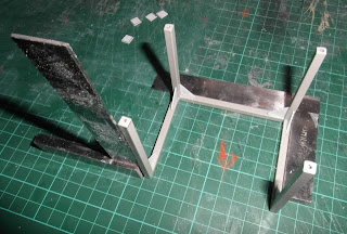

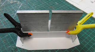

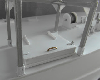

Since the last post made a start on the Cod end gantry
Legs made of 5mm section (supplied)
Two sets of legs joined in the middle.
Checking for square.

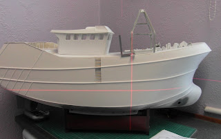

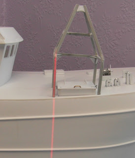

Then realised that after making the cage over the plan to make sure everything was nice and square, its sat on a sloping deck!!.
So had what my mate would call a Eureka moment, so it was out with the laser.
Checks out the waterline and the vertical.
So after packing up to the red line was abell to find the ammount to come off.
And there it is nice and straight.
Then I had another Eureka moment has the laser was too high on the shelf I'd attached it to.
So it was out with the camera tripod to see if it would fit?
And Eureka! it did!.
so it all worked out a treat, going to add a few more bits on to structure to make it look stronger then its on to something else.

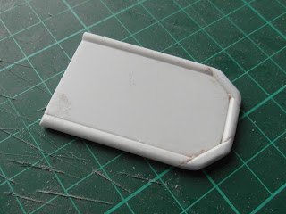

Done a bit more on the Cod End Gantry the other day, put some feet on the legs.
Makes them more sturdy I think.

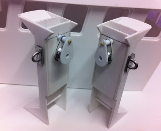

Finished off all the deck pulleys as well
The larger one at top left goes on the main crane gantry, that's the Main gantry Gilson Winch.

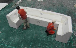

Then I made a start on the wheelhouse furniture,
Here the bench seat, the rear control panel and the escape hatch.
Then it was on to the front control panel which was rather tricky with all the angles involved
The underneath of the front control panel, thought I'd better start from a Square base.
All the parts cut out.
Then put together.
Have to admit I had to use some filler on this section to get all the joints and angles right.

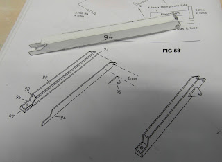

As you can see from the nice clear instructions, even dumb people like me can follow them, just have to make sure you cut outside the lines and adjust later!.
First and second sections made up and fitted together temporally, needs piping added too.

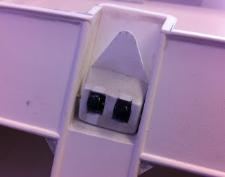

Darren (Manx Venture) kindly sent me a picture of a clump, I didn't even know what one was up to then
And there is my effort on the right,
And in place, for size
and here it is with fittings for the chains, will look better with some paint and rust.

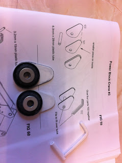

Hi Bob
Average to me is great!.
Printed the picture off to use it whilst I made my clump and then just placed the finished item on the picture and snapped it again, nothing fancy like your photo shop pix's.
Duckie.

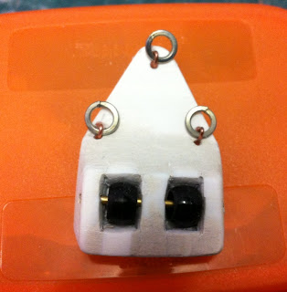

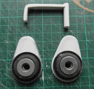

A bit more on the boat done
The end of the crane arm, the part that the nets go round.
The "L" shaped arm was a bit thin made up of 4 layers of plasticard (4mm) with a hole of 3mm to go though it, so thought it would be better with another 1mm each side, the tube part on the right side was also strengthened with a pin though it.
The rubber bits was Son John's idea and taken from his Plumbers washer box,it looks a bit better than a bit of plastic tube stuck though.
The metal washers are to correct the gap in the middle.
The wheelhouse table was given an edging as we don't want any accidents with the boat in heavy weather do we!.
