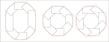

I need wooden masts for my lifeboats, and they carry quite a bit of sail, so want them to take some strain........but how to construct them.
It would just be my luck to chose some dowel with a hidden "shake" and the first time out.....crack, bang, wallop and have to start again.
I am going to shape them from the square section in either lime or cherry which I have..............but when thinking about it last night I thought what would be better.three laminations of wood glued together, or the same, with hollow for a carbon fibre rod sandwiched in the middle.....the carbon fibre can be either solid or tube, as I have both....and these would be epoxied into the center and set solid...........
What do you guys think.
the exterior of the mast  would be the same in either case and look wooden in build.

Have you thought about hollow hexagonal masts Neil?  Try googling images of "hollow wooden mast".
They're supposed to be strong and you could still put your carbon rod down the middle...which is quite a cunning plan, by the way.

Yes agree with last poster.
If the mast is big enough you could try a birds mouth construction.
I would be inclined to steer away from hardwoods, as they are generally brittle and more likely to snap. By contrast softwoods will spring more and take the flexing much better.
Oh, it's a real thing! I thought I was being 'had on'..... again!
http://planingaround.blogspot.co.uk/2009/09/birds-mouth-mast.html

Neil........
successive lamination of the same timber in the same plane will not produce any greater strength
cross laminations in opposing planes will produce greater strength...eg., building a mast in hexagional segments as rmaddocks s note sis a good idea
carbon fiber reinforced cored material has great strength in both tension or compression and in shear ...but this must be harnessed to achieve it's strength qualities
the same material will bend like a banana if unrestrained  O0 ....Derek
Derek, you may gain strength depending on the glue used for the laminations.
Martin, the photo of the birds' mouth mast shows a central plug: these are used at the ends to keep water out. The mast is invariably hollow: making them easy to run wires up, but a difficult job when assembling, due to (slippy) epoxy.

Neil,
If you can find a length of knot free straight grained spruce or douglas fir it will do your job perfectly.
These are used in full size boat building, I used spruce in my dinghy with great results.
