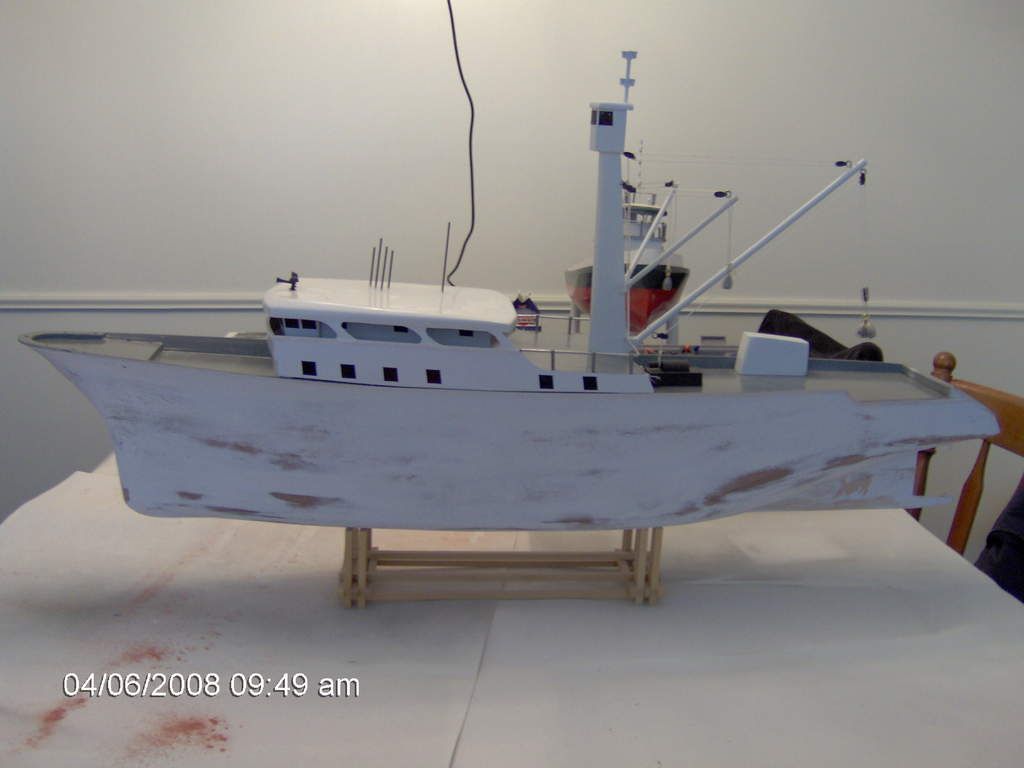

im looking for some angled windows for the out side of the superstructure on my T/C build simlar to the ones in the pic
i can only find square ones or port holes

i think you are going to have to construct those yourself shrimper, from plasticard.
I make mine from p/c and then use micro thin double sided craft tape to stick the "window glase" to it, and then use the double sided tape again to stick the assembly to the model.......avoids any runs with glue/cyano and stays where it's put.
neil.
