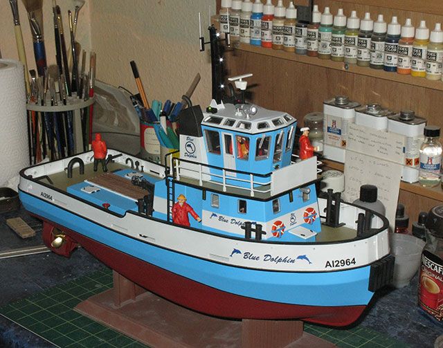

 Well, as previously stated in my build of the Assurance Class tug, I lost all interest in building.  So, to try and remedy that I thought a couple of smaller builds might help out.
One of those that I purchased was the Hobby Engine Southampton tug.  I know it has been about for a long time, but comes highly recommended on a regular basis for a RTR boat.  Although improvements/modifications could be made.
I planned for mine to look different from the start and to upgrade the electrics as other people had previously done.
To keep it as a casual fun build, I did not want to create a build log, but did take some pictures during the conversion, so have now decided to show what I did and the final outcome as I could not find that much information in the way of other complete logs.  But that could very well just be me not looking properly or most people keeping it as it is.
So, to start, I purchased the boat back on 23rd January 2013 and received it next day, thanks to Howes Models.
First thing was to check everything was in the box and what there was.
The boat, with stand, 7.2 volt 800mAh NiMH battery, tyres, wall charger (not shown), cord and 27 MHz Am 2 channel stick radio.
 The battery was charged, batteries put in the transmitter and everything checked to make sure all was working okay.
Everything working as it should.  Fourteen screws removed from the deck and it was starting to come apart.

Time had come to start re-assembling.  The motors were refitted with new wiring, prop shafts greased and refitted.
The original props were re-used but O-rings were fitted.  Original rudders refitted.
I missed taking pictures of the electronics.
But the original tray was refitted.  2 off Mtronik 15 amp ESC’s wired in and a rudder mixer was installed, all on the original forward tray.
The original rudder connections and servo was re-used, but a new connecting rod made to work from the top leg of the servo connector and in different holes to give more rudder throw.
A new battery holding box was made for a 7.2 volt 6 cell NiMH battery and glued into the hull at the back.  I had to fit it at a slight angle to give the rudder servo room to operate.
Most of the fittings and bollards from the deck that were originally black, I left as the same colour, but gave them a coat of matt clear, which took away the plastic look.  Also re-sprayed the locker for the cabin latch.
All the electrics were bench tested and working fine, even the rudder mixer.
The major fittings on the deck were fitted and the deck was re-fitted to the hull using the original seal and some grease.
The picture shows the battery access through the rear hatch.
I wanted to keep the forward watertight cover under the cabins, so decided to fit the two on/off switches from the ESC’s into the cover itself for easier access.  Not fully watertight any more, but would help.
Alan……………..

 The next thing I did was to water test the tug in the bath and ballast it out.  Because of the batteries in the back some weight was added to the front.
I then managed to get it onto the lake and try it out.  Went great.
Turned on the spot with rudder control only and still turned with control under power.  The motors were not responding exactly the same at very low revs, which was a lot more noticeable in reverse, and would not reverse in a straight line.  But, still very happy with the manoeuvrability.  At a standstill it was sitting on the waterline nice and even, but tended to nose dive a bit under power, so have removed the weight in the front and will see what it is like the next time I get it on the water.
Checked the insides after testing and bone dry.
Happy that it is seaworthy, I carried on with the cabins.

 I wanted working lights on this model, so the main mast was the first thing to be tackled.
The first thing was to remove the support ribbing from the back of the mast to leave a nice channel.
I then sliced off the original moulded in lamp, drilled two holes in the bracket top and super glued on a 3mm LED.  Then drilled two holes in the mast through to the back.  I cut the LED legs very short, soldered wires onto them, fed the wires through the holes to the back of the mast and bent the LED legs backwards towards the mast.
I done this with all 3 lights and the top anchor light, all the wires fed down the back of the mast.
All LED’s fitted.
The back of the mast then had a small piece of sheet plastic glued onto it to cover up the wiring.
The LED’s had a small area masked up then the whole mast was sprayed.
Finished mast and LED’s lit up.
Alan………………….

 Right, with all the LED’s fitted and wired up in the front cabin it was time to finally glue the cabin roof on.  But before doing that I had a helmsman to glue in.  I had previously already pinned the feet of the figure and drilled the holes in the cabin floor, and test fitted the figure.  Also I was not happy with so much blank space by the instruments panels, so just added a little something to fill the gap.
Original test fitting of figure.
Now it was time to fit the cabins, route the servo lead into the boat and double check the lights.
OOPs.       :(( :((
Miscalculated with the measurements.  The light servo arm was connecting with the hand knob that holds the waterproof hatch down.  Took the waterproof hatch into consideration to start with, just did not think about the latch handle that holds it down.
Okay, no problem.  The hatch hole has got a built in coaming round it, so just remove the waterproof hatch, fit a bracket for the two on/off switches and leave it at that.  The bracket is glued in at the moment, but would not be too hard to remove, so at a later date I might remove it and refit it with some screws.  Or will have to if I need good access through the hatch.
So, the rest of the crew decided the boat was now seaworthy enough to come aboard.
First the captain, complete with mug of drink. ( 43 beans in every cup).
The grumpy one about to hang on for dear life.
And the disillusioned one with a crowbar in his hand.  (I’m sure he’s waiting for the seagulls).
With full crew aboard a full light test could be completed.
From the front.
From the back.
 Alan…………………..

 With all bits back on, it is nearly completed.  I’m now at the stage that it was in when it came out of the box, just a different colour and a couple of small mods.
Half of the screw holes that hold the deck to the hull were left open on the original.  So I used some aluminium tubing that fitted in the holes to the best fit I could get and placed some cold form rivets into the aluminium tube.  These were painted with a coat of matt clear.  They are glued into the holes with a small amount of white PVA glue to hold them place, but should pull out quite easily if needed.
Some of the original tyres supplied with the boat were rubbed down with some fine wet n dry to remove the shine and tied on.  A tow rope added and the left over rope tied round the front bollard.
As far as I’m concerned it is now finished.
6 weeks of work written up in two days.
It has not been back on the water yet since initial testing. That is planned for next weekend, and hopefully I’ll try to get some more pictures.
Any questions or criticisms please say out aloud and I’ll answer them the best I can.
Hope you have enjoyed the little there is of it.
