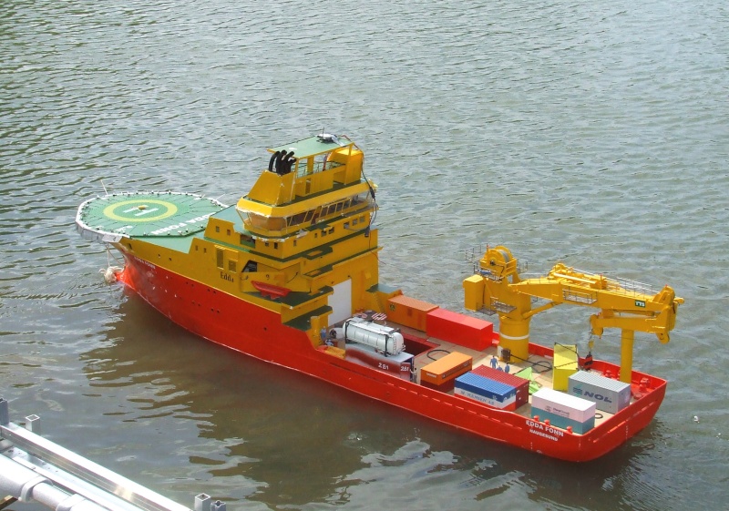

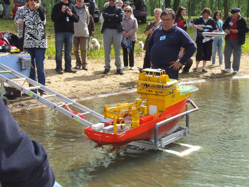

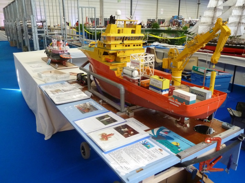

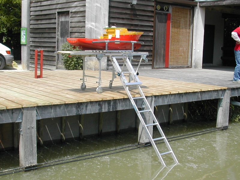

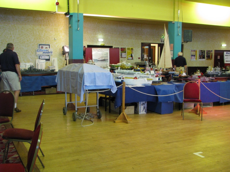

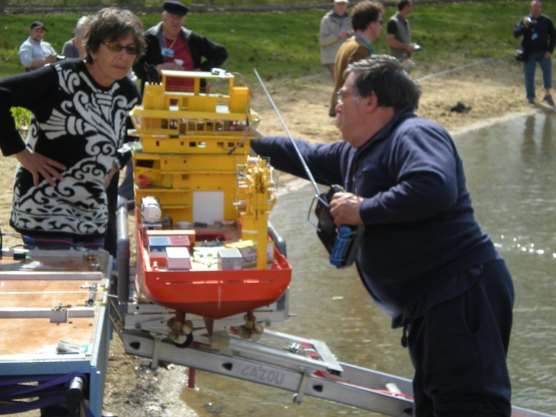

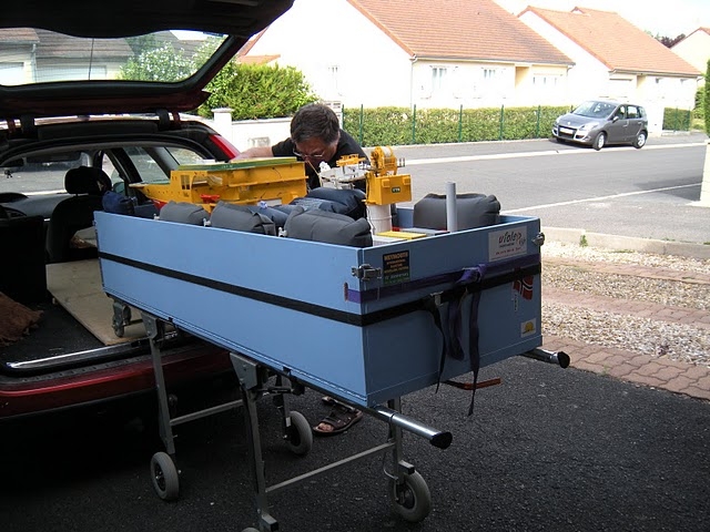

the boat is the weight of a man: 70 kg
transport as in the ambulance
or in the hearse  ( by Weymout )
Weymouth exhibitors are pranksters, the day of departure they will guard of honor
easy to load in the car
easy to explain
easy to get into the water
regardless of slope

 %% Wow!,that's some outfit,

 %%  WoW How do you fit all of that in your car? No chance of any spontaneous sailing I presume.

Hello CPM1
I am an old man and the boat is 70kg, 180cm long. It is very heavy for me! Luckily my car inside measure 182 cm. I have a margin of 3 cm in height. I bent the right rear seat passenger side (we are in France) and I put the boat here. I keep the left rear seat. I attach the coffin with straps on the floor. The boat is rigged inflatable camping pillows.
My car, a Citroen C5 hydropneumatic suspension that I can adjust the height. I fold the first wheels first, I get the coffin, the intermediate wheels carry the coffin, I pushed again and I fold the rear wheels.
The "coffin" is a modified ambulance stretcher.
The cradle down on which is placed the boat is adjustable in height depending on the slope.
With 70 kg it is impossible to get off the boat by hand. It is a 12 volt electric winch multiplied by a pulley that lowers the truck slowly on the scale of 3 meters, I can add another level of 3 meters. The truck is built to scale well to stay on without leaving tracks. there
I am very happy with this system. I can take photographs of the work. Anyone can do it without heavy machinery

Great system, just glad I don't need to go quite that far, though still thinking about the best thing - straps versus some form of trolley. Quite like the idea of a sack barrow, but can't see how I can do other than carry it sideways in that case, which makes it pretty wide on footpaths and through gates etc from the car to the pond.
