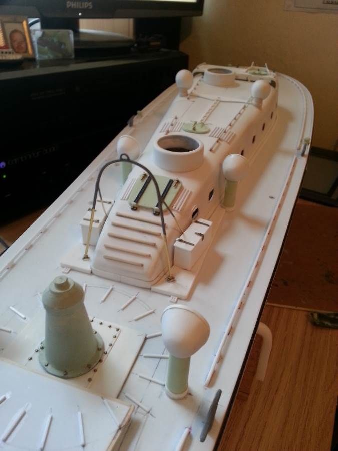

« Reply #6 on: March 27, 2013, 11:53:49 pm »
Now that we have moved and got settled again I have continued work on the ASR ! Firstly I discovered they had a small set of rear windows.. after looking through a variety of photographs and drawings I found them showing in most pictures so these had to be added.
First I drilled out the spaces and started to pare it out with a sharp blade then working it in carefully with files till it was straight and correct.
This was then framed and finished with very thin strips of plastikard and then filled with plasto filler.
I then sanded it into the roof line when it had dried.
The next step was to start on some of the metal work. First was to do the aerial loop at the back of the craft.
This was bent up from one and a half mm brass and then the loop for the top made from 1mm. I then soldered the loop to the
top of the frame then added brass tube to each leg base and added a disc to act as the foot that is fixed to the deck. This I drilled three small holes in to
add the "bolts". Once this was fixed in place i added the support struts, drilling them into the deck and gluing them before soldering them to the standing frame.
Also added the fuel filler cap into the deck, burnt in with a heat tube then detailed and finished.
And added the small outlets above each exhaust as well as can be seen in most pictures of the rear of the craft. I dont know what they are.
This is how far I had got then.

« Reply #7 on: March 28, 2013, 12:01:33 am »
I then decided to build the Searchlight, this i wanted to get accurate, so I found the details I needed and built it from scratch.
First cut a perspex ring and a perspex disc of the same diameter.
Then I cut a piece of poly tube that was tougher and more heat resistant than Plastikard. This was added together with the perspex to form the basis of the light.
I then formed and soldered up the stand for the lamp and fitted it into the sides of the light.
It was then fitted out with a miniature ultrabright LED to look like the ones in the pictures I have. I also wired the LED before I went in as well.
Finished light in basic filler undercoat before sanding and finishing.
Finished light in basic filler undercoat before sanding and finishing running on 2.4 volts. !
This filling undercoat will be sanded back prior to painting and repainted in a fine undercoat and top coat.
